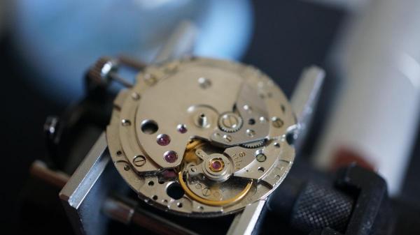

Wonder if someone has done this movement before? And if there is any walk trough help somewhere? Am a little scared of doing wrong . This is kind of rare movement i think ? This are some pictures of the keyless work and that side of the movement . Lot of springs and lefthanded screws . The big black screw is lefthand tread .Two screw marked with arrows are left handed !

Went a little fast there in the end . Parashock jewels in the balance . Same as in a Seiko movement . They are easy to work on . As long as the spiral is in one-piece . As you see i have removed the rotor. Much easier to put things back without the rotor swinging around . Have a few things to put back on the dial side . Like the date ring and two springs for the winding mechanism .

HATE  pallet forks . One of the jewels on the pallet fork was bent down. Manage to straighten it but the movement ain't working so good . Have some pallet forks from a citizen 8200 movement .Looks the same but don't now if they would work . There is nowhere i could check either?
Nope the pallet fork for the 8200 is not the same as for the 5420 . But the fork work like it should? There is no speed in the movement? Very low amplitud? The mainspring looked ok . Nice S-bend . Have now idea where to find parts for this movement? New mainspring? But what size? Nothing on  http://www.ranfft.de/cgi-bin/bidfun-db.cgi?10&ranfft&0&2uswk&Citizen_5420 about mainspring size?
