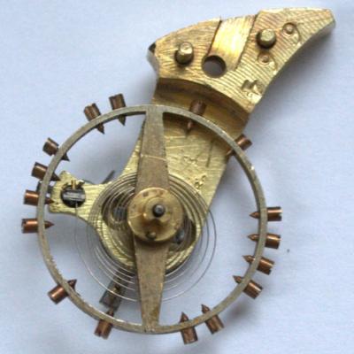

You can see some basic tools, a partly disassembled antique 19 lignes (42.8 diameter) lever movement and the removed parts.
post-1450-0-63750400-1442621815_thumb.jp
I had never disassembled a movement before and this one seemed like the perfect candidate to experiment, but now that I have learnt to assemble/disassemble this movement, I want to fix it. After all, we are talking of a fully jewelled movement from a century ago.
post-1450-0-47650900-1442621811_thumb.jp
On close inspection several issues are revealed: broken mainspring, broken balance staff...
post-1450-0-46649200-1442622370_thumb.jp
...and missing roller jewel.
I have not been able to identify the maker, but the dial and the case (935 silver) confirm it is Swiss.
post-1450-0-88840700-1442622373_thumb.jp
The balance cock bears a factory symbol consisting of a five-pointed star connected to three lightning bolts that come out the star each in a different direction.
post-1450-0-93852000-1442621817_thumb.jp
I am aware that getting spare parts is going to be hard work, but I want to learn to solve these issues.

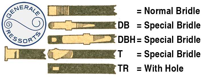

I have measured the broken mainspring with a Vernier caliper but I cannot find a replacement in Cousinuk.com. Perhaps someone could check for me in the Générale Ressorts catalogue? These are its specifications:
Height: 2.2 mm.
Thickness: 0.22 mm.
Length: 24 inch (61 cm).
Barrel: 16.5 mm.
End hole type.

I have looked in my "Generale Resorts" catalog and there is not an exact sized spring. However the following may well fit:
GR 6305  H 2.20  Thickness 0.22  Length 520   Dia. 17
GR 6307  H 2.20  Thickness 0.22  Length 560   Dia. 18
GR 6310  H 2.20  Thickness 0.22  Length 620   Dia. 19
The end type for all those references is described as 'Non-Automatic', but I need the mainspring with holes in both ends. Maybe the below references are more fitting?
GR 6216 TR 2.20 x .155 x 620 x 15 TR- End
GR 6280 TR 2.20 x .20 x 540 x 17 TR- End

Today I worked on the escapement and I have some more pictures to share below. I agree about the size, but this movement seems big enough for me. In any case, here I am following the advice of the Chicago School of Watchmaking:
This is the best match available with Cousins
Much appreciated. With the help of clockboy, now I know which spring to go for. If I order it, I will place it by hand as I have practised how to do it with the broken one. But before taking that decision, I am reviewing the other elements of the movement again to make sure it is worth my while.

The escapement is a different matter. The pallet fork engages well with the escape wheel, but a new balance staff is badly needed. So I have removed the broken one.
As you can see, the impulse pin (also called roller jewel) is actually present. However, the pin is made of brass and is loose, so it will still require attention.

I don't think for one minute you will find a balance staff to fit. I expect you will have to find a watchmaker to make it. I always had a stock of unfinished staffs, so I would select one as near as possible and finish it off or make one. This is the difference between a watch repairer and a watchmaker. The hairspring looks in a fine mess as well, I'd start with that before sorting out the staff because with out the hairspring you are in deep. The only other answer is another movement with a working balance. You are correct about starting on pocket watches before getting into watches, its just a pity you couldn't have started with something that just needed cleaning.
Agree with Oldhippy I am not the best at making balance staffs and so I normally modify one of my many stock/unfinished staffs on my lathe. You can get unfinished staffs from Cousins & on the bay also there are staffs (in packs of 100) on the bay & you could get lucky & get a match.
You could modify one using a jacot tool but it would be a long process.
The main point is this is a learning piece and adjusting the hairspring is a skill in itself.
So my advise is just tinker & learn from this piece before spending to much money
