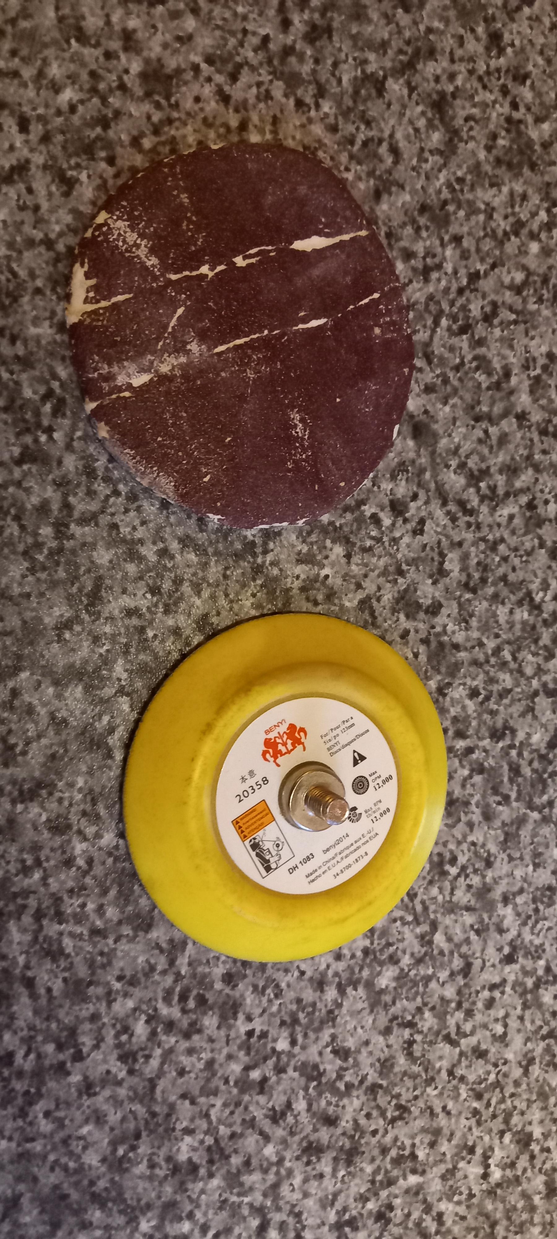

How do I attach a case back to a hand drill for circular graining ?
