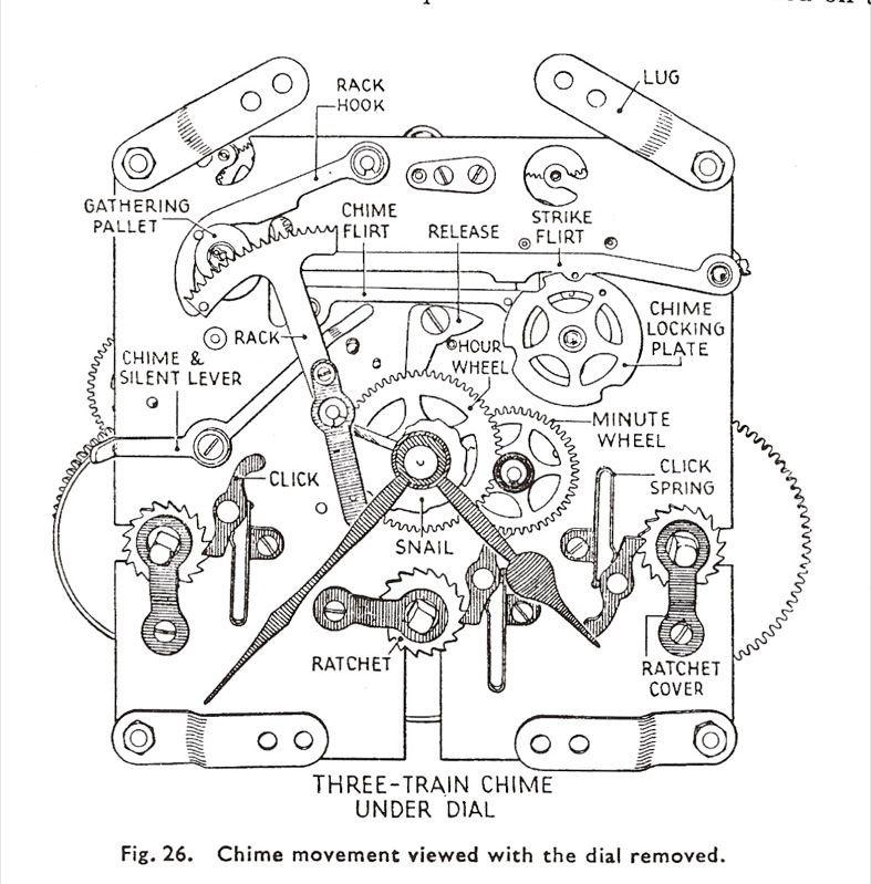

Hi attached are a few pics that put names to the parts in case you are not sure.
practising on a spare sounds like a good idea
Exactly!  That’s what I did with a couple of watch movements. Thanks for the illustrations … really helpful!!

I have a question re pendulum bob. Where there are 2 nuts on the rod I presume the smaller is to support the bob at an approximate height, and the other larger nut is for very fine adjustment … raising or lowering the centre of gravity of the assembly? In this photo I would say they’re the wrong way around?
Hi the canon pinion/ star cam are pressed on to the center wheel which is a tapered shaft. The star cam has either.   2.  Projections, for the half hour/ hour strike.  Or. 4 for one for each quarter the longer on in each case is for the hour and lifts the long lever higher than the quarters to release the strike from warning state to strike.  There are different opinions regarding removing it some say if it is not worn or needs bushing Lea it alone others say remove it but in the latter case I made a tools to take it off a nd put it back, but care needs to be taken not to bend/warp the shaft.
