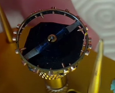

Here’s the situation. I have a 992 Hamilton movement that now has an amplitude of 250 in a beat error of 0.33, after adjusting the hair spring and the backing pins. This is all great but the watch was and still is running at -500 seconds per day. I’m not sure if adjusting the baking pins will fix us as I think they’re fairly far apart. I was thinking of wedging a piece of material, and where the hair spring goes through the banking pins and checking if the watch will run faster. Any suggestions would really help before I start thinking of removing weight from the balance, which would make no sense if this wasn’t an issue 100 years ago.
The regulator pins should have a gap just large enough to allow the regulator to move without binding on the hairspring. Are you sure you have 250 amplitude? What lift angle are you using? It would be in the low 40s or high 30s on this piece. 500s a day would be a lot even if the gap it too large, unless it's really large and also if the amplitude is lower than thought. It could be that the hairspring isn't even touching them when running. Solution is to close the pins. Is it stable at -500 in several positions, 2 horizontal and 4 vertical?

Will close the regulator pins. And technique you could share for not screwing this up.
Watcha JD , nah you wont screw up, ive seen you demonstrate vibrating a hairspring. A big gap between the hairspring and regulator pins is going to send the timing right back to the stud, Making the timing much slower than it would be if the pins where at the active point of the hairspring ( maybe not 500 seconds though )  Thinking about what Nicklesilver said if the timing is very stable in vertical positions then the pins are so far apart that the timing is constant at the stud. How did i do Nicklesilver ? 🙂
Update: I did move the regulating pins closer and that made a bit of a change.  Then I tried to simply remove 2 balance screws.  When to +1500 seconds/day. Then I simply screwed the quarter screws in all the way and the mean time screws as well and got to -55 seconds with the regulator arm all the way over to Fast. Last thing I could do is either change the meantime screws to lighter screws or undercut the Quarter screws. Thoughts?  This is a job for someone and I have lost a fortune in hours:)  video on YouTube later today.

Are the regulator pins gapped correctly? I understand you closed them more, but they should be almost pinching the hairspring. Also, check the balance for timing washers. If there are pairs (opposite sides), try removing them. But also, check in 2 horizontal and 4 vertical positions, as the poise may be thrown out if they weren't matched pairs. You would want to check in 6 positions anyway on a watch of this grade, and it should keep very good time.

Should I under cut balance screws. I’m now at -55 sec per day
Should I under cut balance screws. I’m now at -55 sec per day.  Here is my video on this watch problem

Yes, but maybe you have a delta of 150s in the verticals. If you check 4 vertical positions, they should be within 10s of each other on this watch, eaaaaasy. But let's say you have +100 +10 -60 -120 in the verticals, which screw will you start modifying?
What are the 4 vertical rates (crown up, down, left, right) and does your rate and amplitude correspond in the two horizontal positions? This is a magnificent timepiece from the best U.S. maker, you must be methodical, do no harm. And if I understood, for a paying customer. It really needs to be done right, forget the customer, out of respect for Hamilton.
If you start cutting screws you need to cut the right one, haha.

You are absolutely correct.  I should also poise the balance when I am done. I still don’t know why it would have a good amplitude and be -500 sec slow.  That is way too much.
Another Update. On very close examination, the regulator pins seem to be swept backwards slightly. This may be the additional seconds I’ve been looking for. Need to disassemble the balance from the cock to repair this. WHAT MORE!

In this image there are one extremely disturbing thing and the other is not quite right disturbing. The mean time screws there all the way in they should never ever be there. This is a railroad grade watch capable phenomenal time and that's not where there supposed to be at all. Then there's the other peculiar thing which is why I went back to find this image notice they hairspring collet the gap looks too much to me. My guess is somebody had a bad hairspring day and this is a replacement hairspring.
Then I skipped add to the timing machine results kinda wish I hadn't. The oscilloscope doesn't look very nice at all way too much background noise which is interesting because I know the software has a gain control. Although he does keep talking and bumping into it and that's not good be good for the signal at all. He's very happy with what he sees he regulates it in one position of course is happy with everything else And the video comes to an end.
