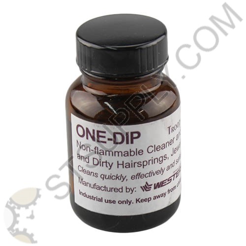

I've got a newbie question here.  How do you store one dip to prevent evaporation?  I thought that was the point of putting it in a glass jar.  I was obviously wrong.  After a week or
so it was gone and this stuff ain't cheap.  Any tips to prevent this evaporation is appreciated.
Purchase the jar for using its because it's very convenient the have a smaller jar. Purchase the solution in a can. I can has a metal lid and in addition to that like a metal stop her that's a pain in the ass to get out. But it's presence helps to keep it from evaporating then when you put the lid back on you have a piece of sheet plastic like a plastic bag in plastic to put that down first and screw the lid on and that seems to keep it in the can for quite a long time. Then from time to time you can put it in the jar.
2 hours ago, grsnovi said:
This is the sort of jar you need: a laboratory grade jar with a ground glass stopper. Only pour enough in to allow the liquid to just cover what you're planning on rinsing (pallet fork, hairspring, etc...). I don't expect it to store in the jar but it will likely keep a few days. The jar I got has a 35ml capacity but I never pour that much in.
This is what I use. I also wipe a very thin layer of silicone grease around the rim of the lid. When I used to work in a lab we would also use Parafilm around the junction of the lid and jar to seal and help stop evaporation.
One of the best ways for storing anything is  in the container it comes in for instance the picture posted by @LittleWatchShop Is the candidate comes in perfect storage container.. Then the only modification to the can is  thin sheet of plastic before you screw the lid down. In the candidate seems to last a very long time
The end  when I'm actually using it I have it in the 2 ounce jar and I only put a little in the bottom of the jar.. I think it almost is never evaporated out of the jar unless somebody forgets to tighten the lid.. Which happens at work because other people use my jar. I have a picture I swiped off the website down below So they can see what the jar looks like.  So having the can for storage and the jar for use the system works quite well
https://www.stsupply.com/one-dip-hairspring-cleaner-2-oz.html
