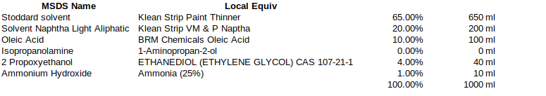

So here are the preliminary results for my "Home-Brew 111" cleaning solution:
0% Ammonia Recipe (Control):
As expected this produced a clear light liquid with no odour of ammonia.
0.5% Ammonia Recipe:
This produced a cloudy light liquid, with no smell of ammonia. No water layer seen (at this stage)
1.0% Ammonia Recipe:
This produced a clear light liquid, with very slight smell of ammonia. No water layer seen (at this stage). I was surprised to see that this was clearer than the 0.5% mix, so I repeated it, hence 2 bottles in picture.
1.5% Ammonia Recipe:
This immediately produced a thick liquid with the consistency of hand soap and was able to suspend air bubbles in the liquid for quite some time (see photo above) and had a distinct/strong smell of ammonia. No water layer seen (at this stage).
Preliminary Conclusion/Way Forward
After the 1.5% result I saw no point in continuing to 2.0% and above. My previous mix attempt produced the gel after it was left to settle for several days, so I will leave all of the samples for a while to see if there are any significant changes and report back, but so far it looks like the 1.0% recipe is looking good 🤞
How are your trials getting along?
I'm wondering if the ammonium hydroxide listed in the MSDS is a red herring. Isopropanolamine is a by product of passing ammonia through isopropyl alcohol. Hence the faint ammonia smell from the 0% solution.
Test the 0% solution for it's ability to brighten tarnished brass. I think it might just work.
The 0% and 0.5% ammonia mixes didn't smell of ammonia and the 0% still does not, and the 1.0% barely smelled of it, to be honest you probably couldn't identify the smell as ammonia in the 1.0% mix unless you knew it was there. However, I have just sniffed then and the 0.5% mix now has a very slight smell of ammonia and the 1.0% has a slightly stronger smell... but this may be because I have a fresh nose today and not used to the smell as it was yesterday after I finished mixing all the batches?
24 hours after mixing and no change from the initial results I reported above in terms of colours, separation of layers or viscosity etc..

OK so I'm going to call it, here are my winning solutions:
Non-ammoniated cleaning solution (AKA 566):
Ammoniated cleaning solution (AKA 111):
Rinse solution (AKA 3 rinse):
Notes:
  • All the recipes above are for 1 Lt (1000ml) but you should have enough information to scale up or down to suit your needs
  • The non-ammoniated cleaning solution does settle to form a 2 phase liquid, but this does not seem to affect the cleaning ability (I have now done 2 watches with this solution and they came out sparkling!) additionally the agitation of the cleaning machine should mix them well enough during the cleaning cycle.
  • The ammoniated solution is very sensitive to the ammonia concentration (I used a syringe and found if I was only 0.5ml over the solution would gel up and 0.5ml under and it would remain cloudy)  - I always added the ammonia last and if too much ammonia was added it would instantly form a gel, however I have found that adding additional Oleic acid can reverse this.
  • Rinse solution is difficult to dry (as is the L&R rinse 3) so you will need to follow the same procedure you use for using L&R rinse 3 to remove it - I plan to either use a 30 second IPA wash or a 30 second 100% naptha wash. But IPA is a highly contentious issue in watch cleaning, so you are all adults and can decide for yourself what you are comfortable with!
I managed to find the stoddard and naptha on Amazon as they are both Klean Strip products (confirmed by reviewing the MSDS sheets) - I could have obtained the Oleic acid from Amazon also, but decided to use a local lab chemical supplier for this as the price was better. I also used the lab chemical supplier for the other chemicals shown above. Most of the chemicals seem fairly benign to handle, but I would still recommend you use caution and the correct PPE. However, the ammonia (25%) is very strong so I would recommend you decant your large bottle into smaller bottles for easier handling and use a fume cupboard if you are fortunate to have one or alternatively handle it in a very well ventilated area and keep your distance as much as possible as the fumes sting your eyes and take your breath away the instant you open the bottle!
Good luck, and let me know your findings if you try the above!
