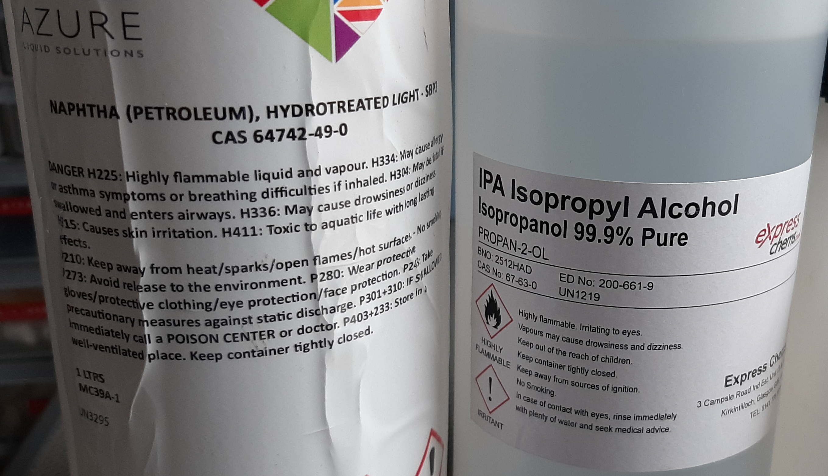

I was thinking of an experiment today because I was suspicious of something. so to confirm my suspicion a beaker a couple of drops of food coloring in this case red little water and toss in some Naphtha.
the food coloring is so we can see the water. My suspicion was confirmed that Naphtha is floating on top of the water. I not sure why it's cloudy perhaps it did absorb a tiny bit of water but it basically doesn't play well with water. In other words it looks to me like it be a very poor rinse for water-based cleaning product.

Naptha is basically a mix of several mineral oils made from distilling petroleum - and oil floats on water. When I use a water based detergent in my ultrasonic and then follow it with a wash in Naptha I sometimes get little cloudy water droplets in the bottom of the container if I didn't dry off completely. Not sure why its cloudy though.

As @Waggy says, Light Naphtha is a petroleum distillate - a type of oil, and it leaves oily residues. Which is why I questioned it being used as a rinse. I would use it before the Elma Red, then distilled water and IPA rinses.
Actually Mike, I'm wondering if any oil based cleaner such as naptha is going to cause problems. Oil can be a bugger to shift in any situation. You know when you've cleaned paintbrushes with white spirit how much fairy you then need to remove that and how greasy your hands are. I'm thinking not to introduce any oil composition into cleaning and stick with alcohol. That oil residue is going to spread from rinse to rinse adding to what is already coming off the old oil lubrication of the parts.
I guess that the cleanliness of your cleaning and rinse fluids play a big part in deposits left behind - these solutions don't make the dirt and grease disappear, they simply dissolve them the same as water dissolves salt. Once the solvents evaporate they leave behind the gunk that cannot evaporate - just like the salt crystals you grew in chemistry class. Hence, if your fluid is new and what you are cleaning is relatively clean to start with the concentration of gunk dissolved in your solvent will be low and it will then leave behind less gunk when it evaporates. The opposite must therefore be true, if you have well used (dirty) solvent, the concentration of gunk will be higher and then 1 ml will leave behind more gunk than 1 ml of the same clean solvent when it evaporates.
The same must be true of IPA, ethanol or other similar compounds also, not just naphtha or off the shelf cleaning solvents and rinses. If your IPA is anything but pure IPA (for example) they must leave behind what they took into solution once they evaporate leaving behind a residue. Therefore, I throw the question out there; would switching to alcohol make things better, unless you changed it very regularly..... but then you could argue the same for the oil based solvents; would they also be just as good as IPA if you change them more regularly??
Perhaps the difference is that new untainted IPA and ethanol are a single chemical and not a blend and will evaporate completely, but maybe untainted solvents like naphtha can only partially evaporate as some component(s) may not evaporate and be left behind? But as soon as the IPA touched the gunk on the first watch it is no longer pure and will dump the gunk when it evaporates, which may explain why new IPA will pass the mirror test but I suspect used IPA will not? So maybe the first few washes with IPA would be better than solvents, but I think after that there wouldn't be much difference in terms of deposits left behind?
So perhaps the solution (pardon the pun) would be to change your cleaning fluid as soon as you start to see deposits, not just when the fluid in the jar starts to look like over brewed tea?

I love an experiment 😀 - so i cleaned some glass, and put puddles of Elma Suprol Pro rinse, "pure" Naphtha and 99.9% IPA. Then dried with a hairdryer.
1. There is a very slight film from the Elma,  when in sunlight almost iridescent, so it must only a molecule or two thick.  I guess that is why they suggest a final IPA rinse.
2 A significant residue from the naphtha, which feels oily to the touch - I can leave fingerprints in it.
3. No visible residue from IPA (the marks on the edge are where the naphtha leaked across)

Then the reason why Elma recommends isopropyl alcohol for final rinse is for the same reason I discovered I needed to use alcohol at home for final rinse. Is that the rinse won't dry. At both home and work were using a or one of the L&R rinses and my experience at home was it absolutely will not drive no matter how much air or seat you put on the watch. But a quick dip in alcohol there's no problem with the drawing. That's my understanding what we been told for that very expensive cleaning machine at work it has to have the final alcohol rinse if you want the watch dry.

I don't have any food colouring @JohnR725 😟, so I improvised. The blue water comes from the toilet cistern 🤣
The Elma Suprol does not mix at all - there is a very clear boundary between water and Suprol. After stirring they separate out in a few seconds.
The IPA mixes completely - as expected.

that was the suspicion I had when I was reading the technical literature where it actually says it floats on water. This means to be using this with a water-based cleaner we would need to understand what it means by its displaces the water? It would also mean that as it floats whatever your rinsing does not want to be in the bottom because all your waters going to end up in the bottom of the jar or whatever your cleaning in. Not as dramatic separation is this but anything that's wet obviously the water will go to the bottom.
so if you read Elma's description of the cleaners the Suprol does actually do a little cleaning because it is a solvent and it will remove residue off of whatever. So I do find it interesting that it is the recommended fluid on a water-based clean whereas it looks like may be using a little more water in other words more than one  rinsing and some alcohol at the end would be a better approach.
