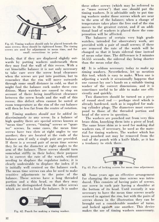

2 hours ago, mikepilk said:
My problem is finding timing washers for wristwatches
Interesting how your problem is the opposite of mine. If I go to work I might actually have more wristwatch timing washers than I do pocket watch.
Then here's an interesting link to a video review of a book. A very interesting book by the way and I snipped out an image of one of the pages. Just in case you're having a problem finding a timing washer you could always make one.
https://youtu.be/op68gwVvsCo
This is the book for timing work. There are others, with other info, but if you buy one, this is it. In reprint from Antoine Simonin publisher.
