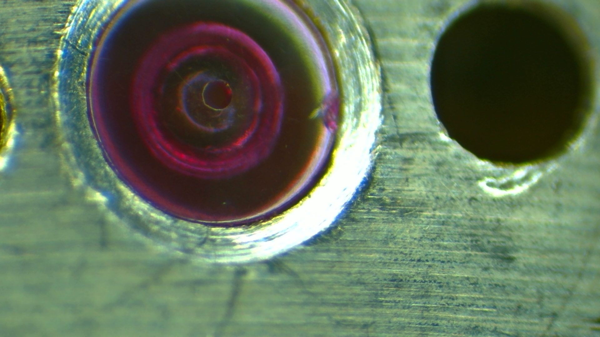

Trying determine the cause of such a big difference between horizontal and vertical positions.
The pivots are good (new staff), nothing is fouling, the balance is reasonably balanced, and the regulator pins are not too open. So it must be the balance jewels (?)
I had to replace the top jewel as it was broken. I found one in the selection of jewels I bought from ebay* which fitted nicely. I didn't look closely enough before I fitted it, as  under high magnification I can see it is not totally smooth around the circumference. I guess that's enough to kill the amplitude ? (And I hadn't noticed the chip on the edge).(* I only paid £10 for the watch, and 3 hole jewels from Cousins are £18)
I don't know but like you, I'd suspect it as well. If you can find a better one in your collection I think it would be worth a try.

I found another jewel which looks OK - it takes some searching through a pile of jewels to find one with the correct diameter and hole size. (Easier than searching a pile of stems for a match!)
It will have to do, as Cousins don't stock the size I need - 0.10 x 0.90 mm (as best as I can measure).
The hole jewels fitted have parallel hole sides, not the 'olive' shaped holes as in the Seitz jewels. That must have quite an effect on amplitude with the watch vertical.

In the pictures you posted you get really close. Is that through a stereo microscope camera? I've been looking at Cousins' offerings but it's quite an investment.
Yes, I have a stereo Amscope with a camera mount. I bought a cheap Chinese camera (£50) which works pretty well.
