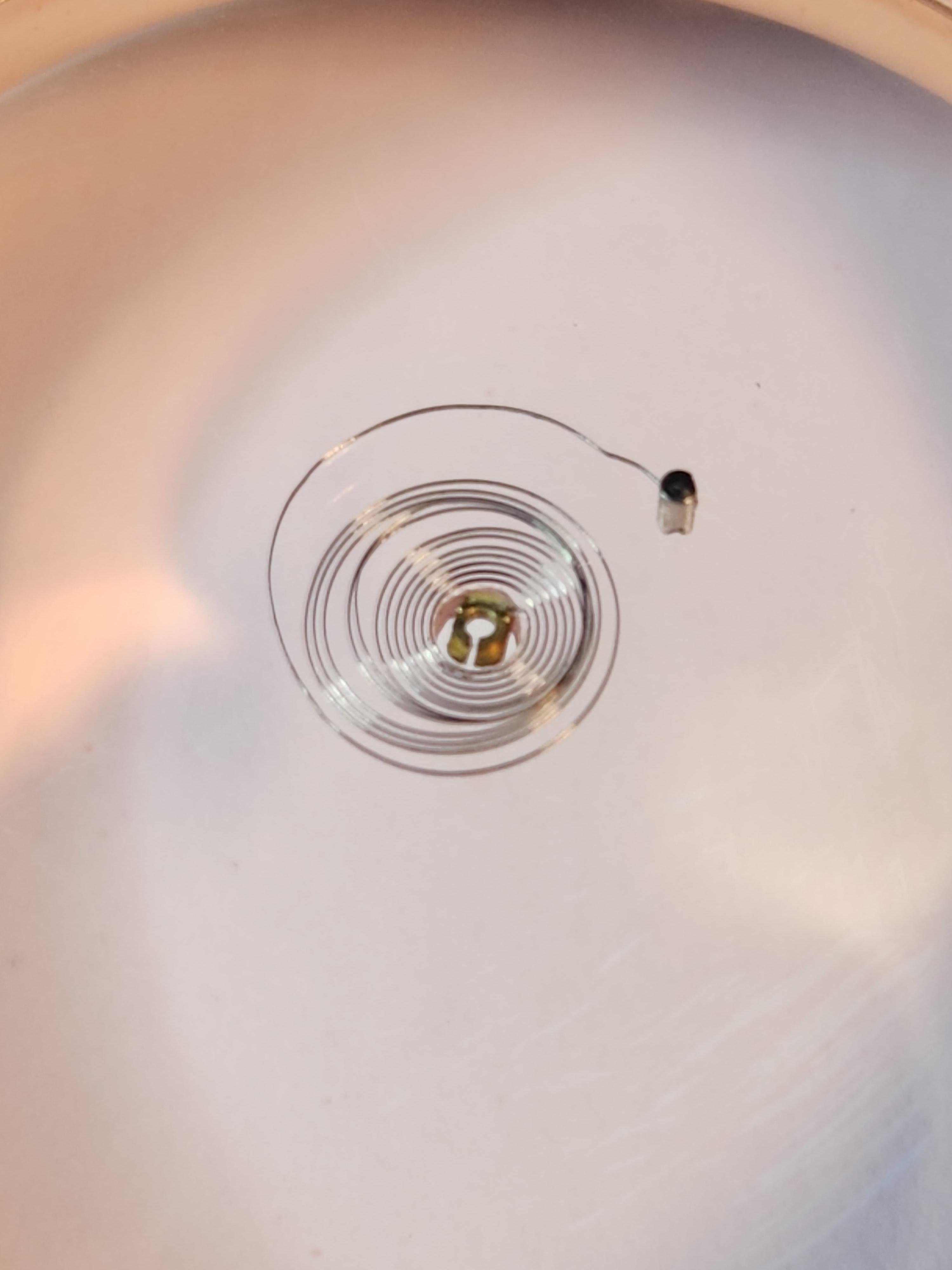

6 minutes ago, HectorLooi said:
A perfect fit for this scrap hairspring from a Slava 2414. Let me try straightening this out and report on its usefulness.
Good luck with that !

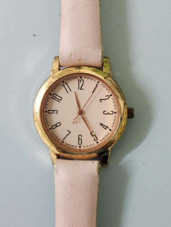

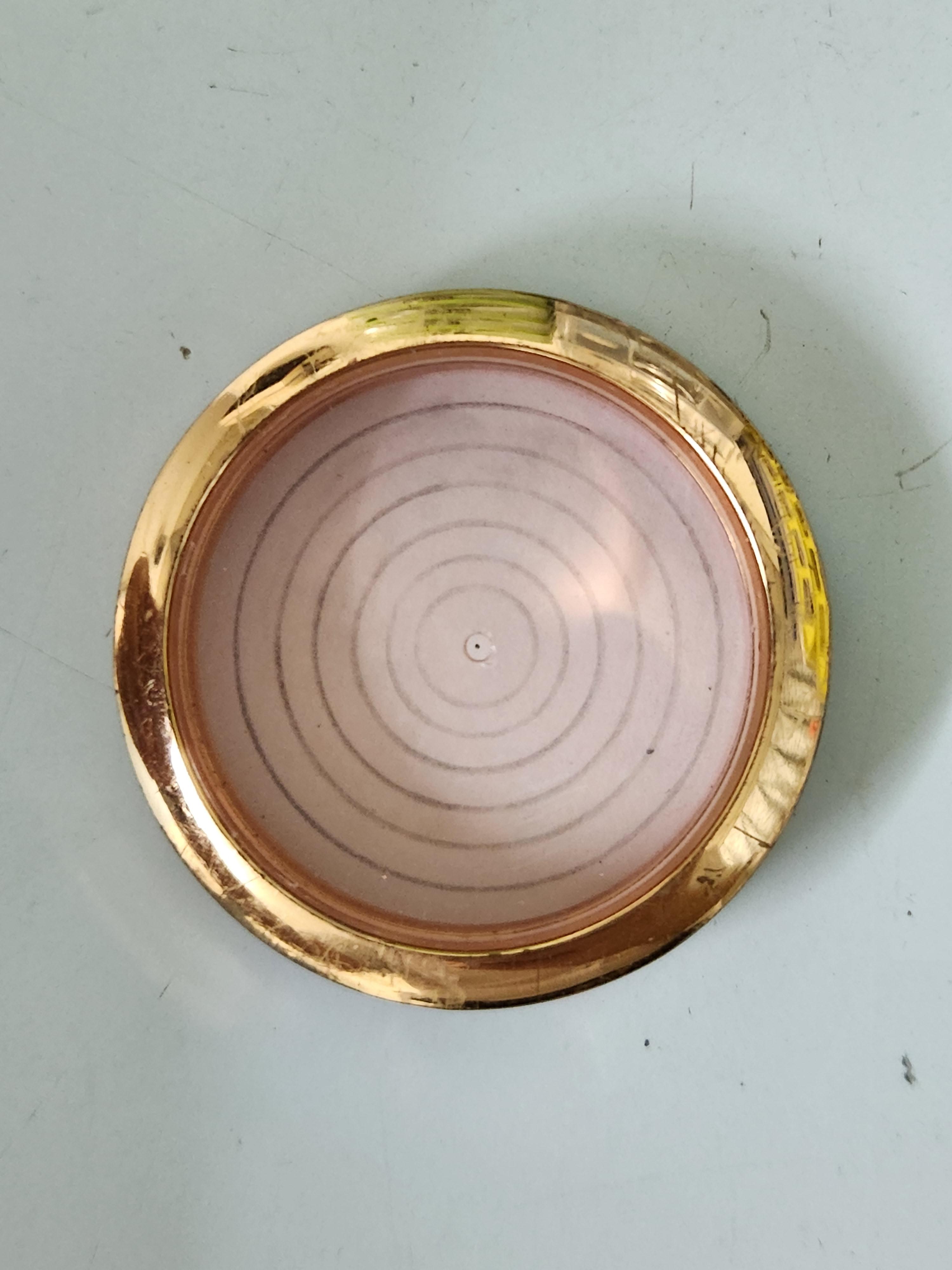

I ground off the lugs and put a piece of white paper with concentric circles drawn on it.
When working on hairsprings, the balance staff is removed, so it doesn't make sense to design the hole for the balance staff. And the hole on the Bergeon one is 3.5mm or 4.0mm. This supports my theory that the hole is for the collet to sit in it, to allow the spring to rest flat on the glass. Clock hairspring collets can get really big.

8 minutes ago, HectorLooi said:
Having the smooth glass surface give a nicer feel when manipulating the spring.
