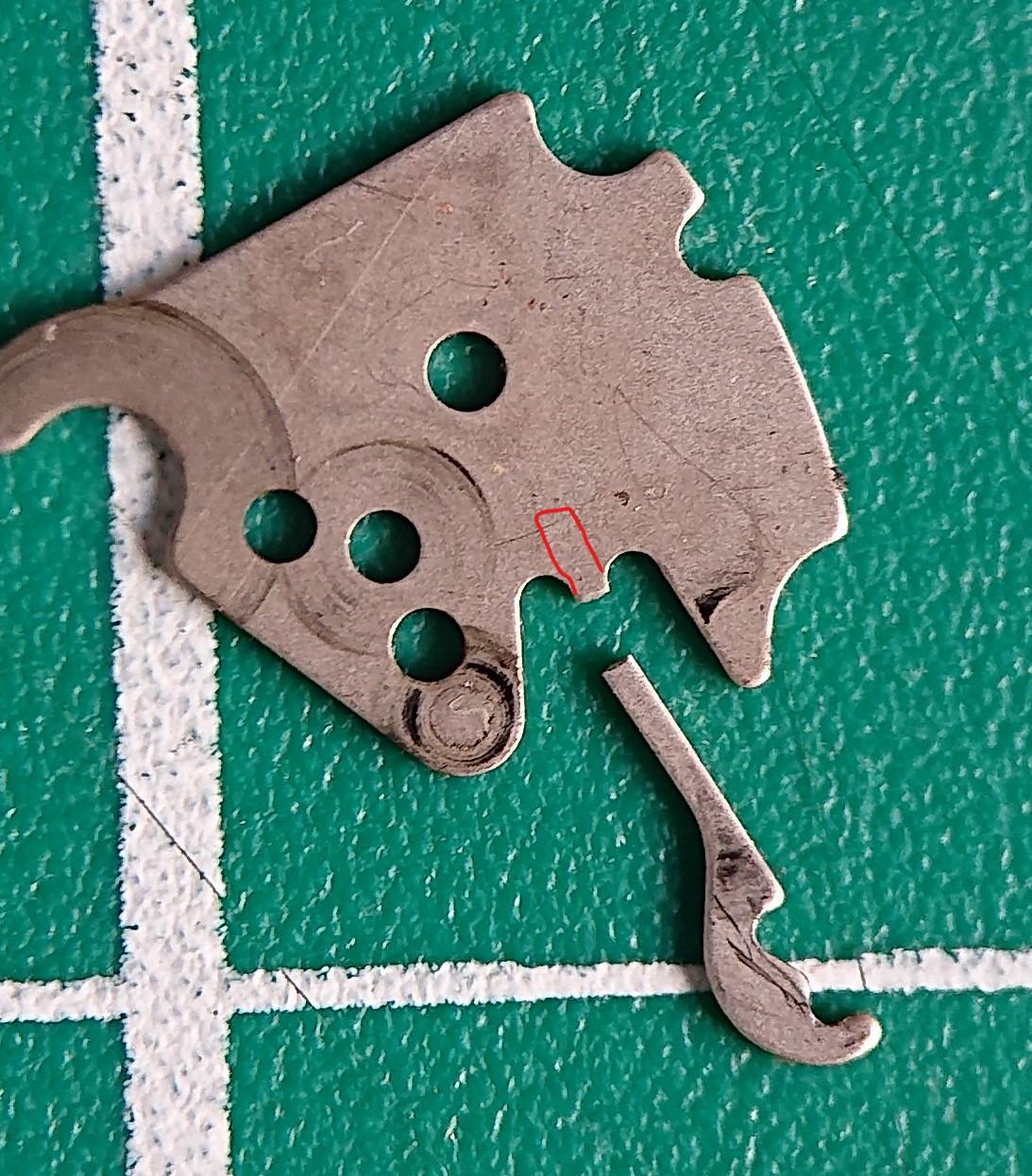

The other big learning opportunity for me is the broken setting lever spring. Normally I'd just buy the spring or a donor movement but as far as I can see this movement is as rare as hen's teeth. Unless I get lucky and find a part, I'm going to have to repair or recreate the spring. On the positive side, unlike bushing the barrel bridge, replacing this won't involve cutting in to the original parts of the watch so it's rather less stressful
Here is the damage:
Searching on various for a I see two courses of action. What do you think an
1 Silver solver the part together? I've got doubts about whether it would eventually just crack at the mend, and also how to recreate the heat treatment as I guess the temperature required for hard silver soldering will anneal the steel. Is this feasible and if so how would you do it?
2 Soft solder the part to a steel plate, then use the old part as a template to drill and file a new one. With care and constant cooling I could probably do the filing with carbide or diamond burrs on a rotary tool without mucking up the tempering of the steel. Again how feasible is this, and where can one find the correct material? One can buy 0.3mm spring steel plate in small quantities on EBAY but the grade is not specified.
One other idea I had was just to recreate the spring and detent with an overlong shaft:
then cut in from the broken end of the spring on the plate:
and soft solder it in to place.
Thanks in advance for your advice and ideas. Thanks @watchweasolfor the suggestion to use feeler gauge steel

Haven't done this myself,  but I've seen other folks use super glue to fix the old part to new material, and then drill and saw out the new part. Super glue dissolves in acetone, much easier to remove than solder.
Usually a jewelers piercing saw is used for cutting,  the very thin blade allows you to follow the template and make tight turns. The final shaping would be done with a file.  Then polishing, especially on areas that contact and slide on other parts.

Whateve you do you should start with a soft carbon steel followed by a heat treatment imho.

It is quite an intricate part, i would be tempted to try silver soldering first. I remember watching a guy making small figures from 2" mild steel nails a few years ago using silver solder. I had a go using some lead free solder and my plumber's blow torch. Curious to test the joints it would not break instead the nails just bent. Last week i repaired a broken setting lever with soft rosin core solder. Different scenario as it was a locating pin and did solder fill  the the complete joint. But maybe worth a try, a pull and a tweak to test your joint should tell you if it will hold.
You definitely want a hardenable steel, high (mid to high) carbon, like O1 or 1075 or similar. It cuts with a saw and files fine in the annealed state. McMaster Carr sells both the above alloys in various thicknesses (very big choice in 1075) in small quantity. These are easily hardened with a common propane torch and oil quench.
If using feeler gage or hardened steel shim stock it really needs to be annealed otherwise you're stuck using carbide drills and grinding the profile.
Sticking the old part to the raw material is a tried and true technique. Super glue, shellac, or soft solder all work fine. A particularly good soft solder for this is Tix, with its accompanying flux.
Silver solder (braze)  requires too much heat, all temper would be lost if trying to repair it, and doubtful it would really hold up. It would be way overkill for holding the parts together for cutting out a new one.

I actually have a broken setting lever spring from a Bulova that I had saved to use as a template to try this. This thread and this video has motivated me to move this closer to the top of the ToDo list.

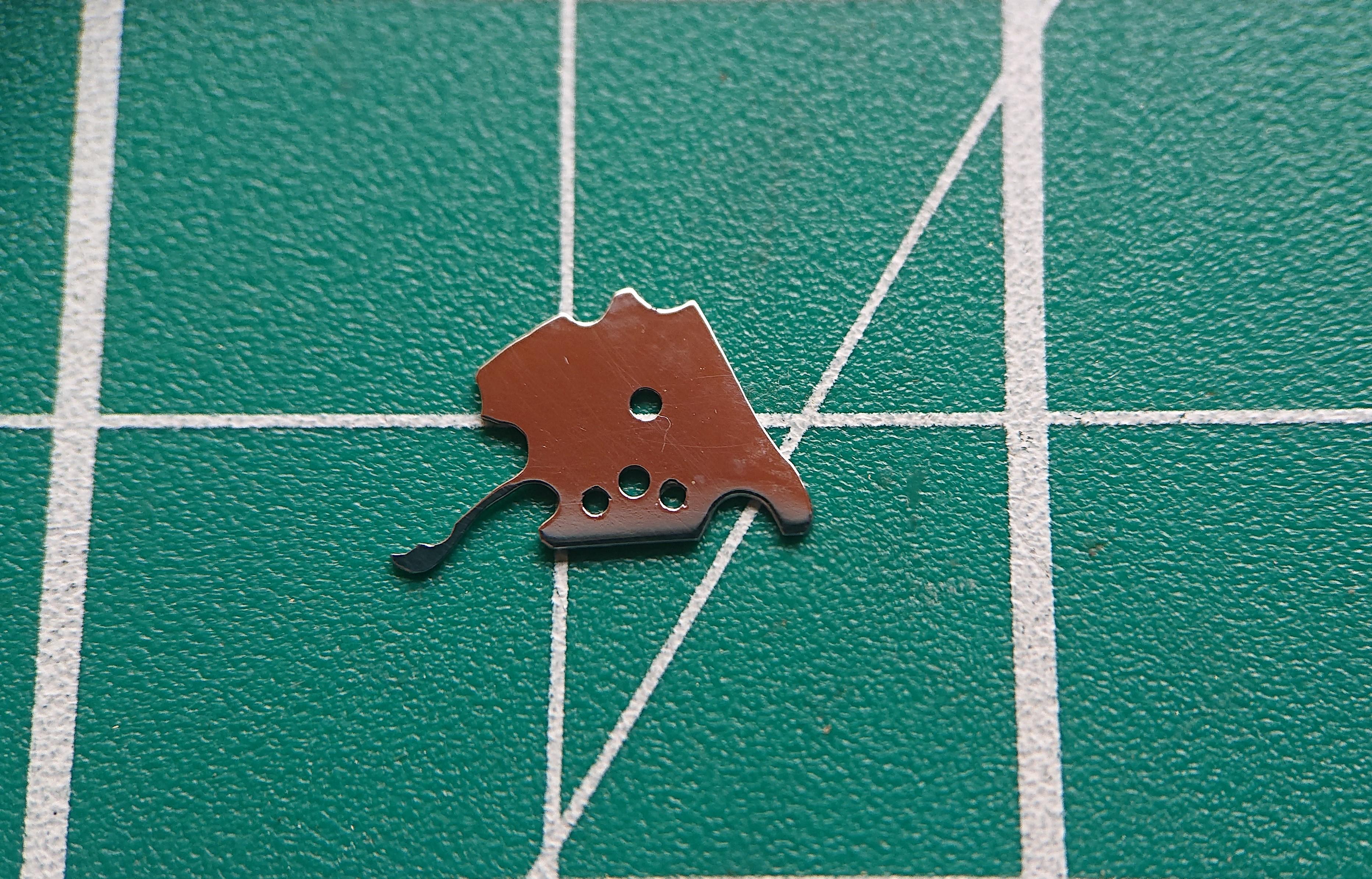

Thanks for the tips everyone. I went with the feeler gauge option as it was to hand. Rather than risking the temper I used a mini angle grinder (plus constant cooling) to cut a rough blank, then carbide drills and diamond files to drill and shape the part. I tried scribing the shape on to the part but eventually having scribed a copy as a template I glued it to the blank and worked on that:
I changed the design of the detent spring slightly as the original obviously had a stress riser at its root. 404195668_DSC_11931.thumb.JPG.79c68c2a1ac0b069197569839445fdbc.JPG
I couldn't match the exact shape of the detents but their positions are identical to the original. Time to check for functionality and fit:
I bent the spring slightly (about 0.3mm at the tip) down towards the setting lever. It functions perfectly and feels smooth with a distinct click from one detent to the other, so I'll polish it ready to fit to the watch when it is cleaned:
Thinking of stress riders I polished the cut edges of the spring with metal polish on the tip of a toothpick .  It will be interesting to see if it lasts.

Just jumping onto the back of this thread, made a couple of attemps at making a setting lever spring yesterday from feeler gauge steel. Both tries ended with a break at the thin end of the jumper spring, maybe the steel isn't right ? Found a supplier of steel rolls of Cs 75 and 100 steel in an annealed state, these have carbon content of .75 -.95 . Anybody tried this steel for making parts ?
Initial marking out using a press to hold the old spring and new steel together. The shape rough cut using a thin diamond disk ( used in dentistry, info curtesy of Nev ) in a proxon drill. The two parts then schellaced together to make the final shape accurate, and a tracing template to show the position of the spring detent taken from bestfit. Two attemps both springs snapped, i figure a more ductile material will withstand working on it.
