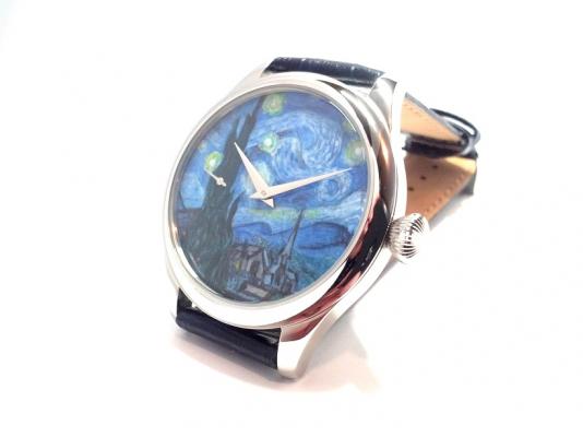

I finished painting the dial quite some time ago, but was searching for the right combination of components to put it all together!
I hope you guys like it, if not, at least, find it interesting!
Yes, another Hamilton pocket watch movement converted into a wristwatch. Also, These cases are quite nice and are very well made. The strap is a dark blue crocodile grain leather.
Thats a really nice watch and the painting is brilliant, the display back is also very nice. Tomorrow's heirloom?
Thank you! If I don't start getting some of these sold, I'll be up to my eyeballs in heirlooms! :D

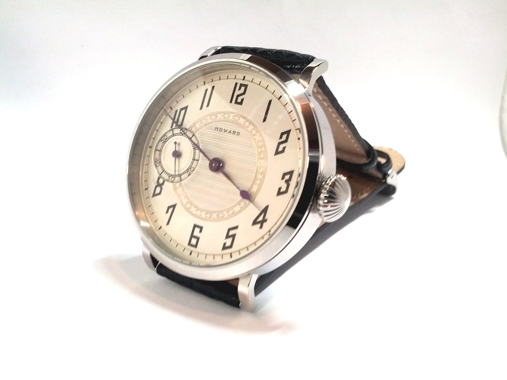

Here is one that I just finished today! As soon as I finished it, I said, "I'm Keeping This One!". My wife said, "You can't make any profit in your little business if you keep all the watches that you like!" She's right of course, but I Really, Really like this one! And, I'll probably keep it anyway!
The Howard Keystone movement dates to around 1914 and really is in marvelous condition! I had the original Howard dial refinished to the new wristwatch orientation. The case is 46mm, but really doesn't play that large because of the very thin bezel. I would love to do more of these!
That is a classic and people will still want it in 100 years time,  brilliant.
I agree! If properly serviced, It will be running in another 100 years! More than I can say for that "Smart Watch" I posted about a few days ago! (that will be out of date by next year and no one will even want to wear it!)

That is one beautiful watch!...Good work DJW.

I really love that dial, its timeless. Is the case from a Parnis? Do these movements just drop in, or do you need spacers or something ?
