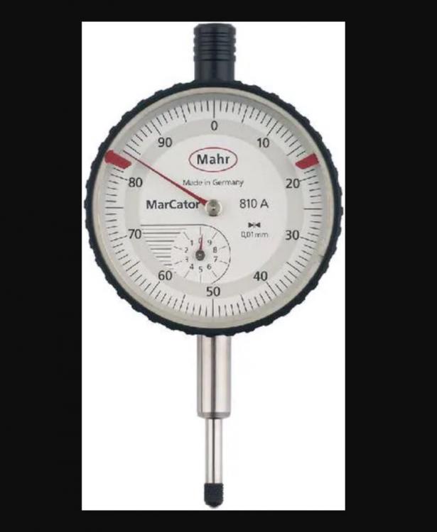

Measuring length is tricky, one reason I like to do the maximum possible with the slide rest- it measures the lengths for you! Otherwise you can scour Ebay for a while till one of the Levin depth mics come up, usually don't go for less than a hundred and sometimes much more. Very nice tool though- mine has seen daily use for decades and shows no sign of wear. The pic shows one under the image if it in use in the Levin book. Another option, that a friend of mine did, is to modify a dial indicator to work in reverse. If you look at the pic, the spindle that pushes in at the bottom also comes out the top, inside the cap. If you make a nice precision hole in the cap, and face it off, and attach a rod to the plunger, you can push the lower (normally used) part to stick out your rod- works exactly like the Levin tool then, direct reading on the dial.
To measure holes it's nice to have plug gages. I have sets from 0.05mm up to 5mm by hundredths (by 0.0025 in the really small sizes), nice Swiss stuff with a little handle on each gage, and cost a fortune new. In the states you can find nice U.S. made plug gages that are just the precision pin, no handle (called pin gages there) for a fraction of the cost here- for reference a 50pc set of Cary gages from say 0.50mm to 1mm is over a thousand bucks...  I'm sure with some digging you can find import gages for a fraction of U.S. made price too, and for hobby use they will be absolutely fine.
https://store.gaging.com/v-g-metric-pin-gages
In a pinch, with something like a hairspring collet, you can slide it onto a smoothing broach, make a mark, then measure with a micrometer. That will be pretty close.

Hi lws. I've been looking at depth micrometers on ebay. There is one or two that may work but tbh look a little chunky for the job. If anything crops up as I spend a lot of time on ebay I'll let you know. There will need to be 2 though as want one as well 🙂. Also would it worth making up your own hole sizers, a bit time consuming but fantastic lathe practise and a lot cheaper than shelling  out a grand ? Just a thought 🤷‍♂️.
