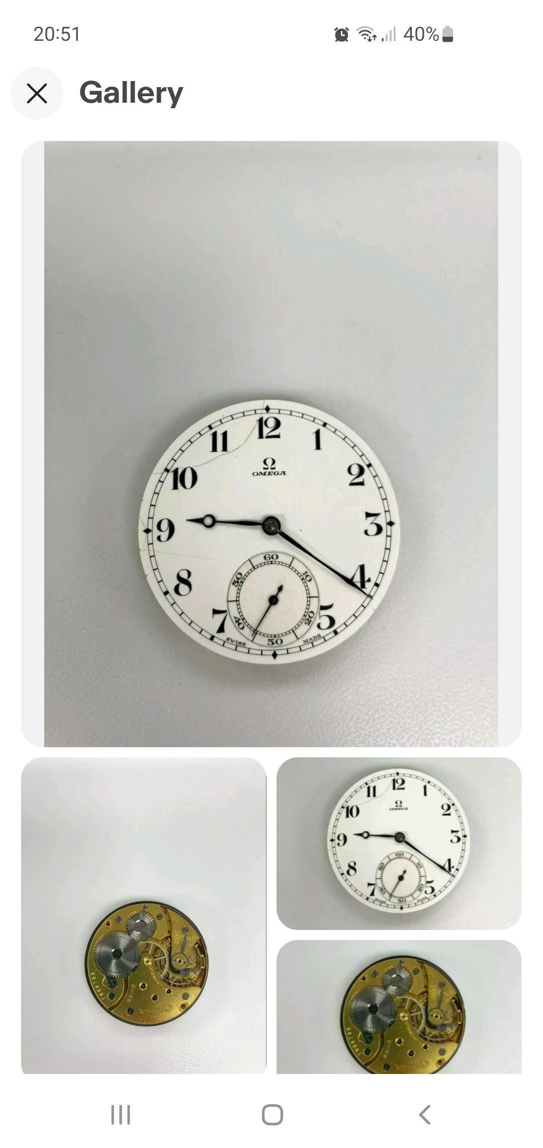

Sorry for the confusion.  I am doing watch repair as a hobby.  The stemis a one off.
On 4/23/2022 at 4:49 AM, LittleWatchShop said:
2022-04-22 16_49_06-Omega 40.6 movement parts new old stock _ eBay and 7 more pages - Personal - Mic.png
Do you know if all 40.6's have the same stem?
I cannot say for certain. If it were me, I would take a chance.
Turning a stem is a relatively easy task IMO. I have made a few and I am just an amateur. But you need a good lathe and a filing rest...and some practice.
One of the sellers is a watchmaker, hopefully he'll know.  If not I'll take the chance.
