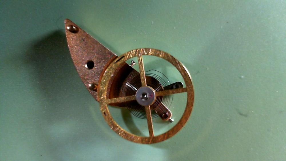

Sorry it's been a while, been really busy, however, I'm back to the Omega 1010.
Trying out some of the suggestions so stripping the watch down again and thought I'd first have a look at the balance spring of the base plate while stripping rest down and the hairspring looks to be over one side, checked that the pivot was seated ncorrectly and took this photo. Could this be the source of my problems?
Sorry for quality of photo, had to get really close so lighting was dificult.
Graham
1934773757_WIN_20220329_20_00_37_Pro(2).thumb.jpg.ed49bf24399e88d25ca38ff379e62146.jpg
I've put the balance back in and taken this photo from the side on angle. It's hard to say, but does the balance look angled?
It pivots really well keeping going for 15 seconds....
The coil looks alright but terminal curve should be paralel to other coils, sorting it out would center the coil.
Does balance wobble? balance ring should be level.
Can you post the video you recorded?
I check side shakes on the staff too and pivots should not leave the gem holes.
I gather you didn't remove balance jewels to check, could still be dirty or pieces of chipped off.
