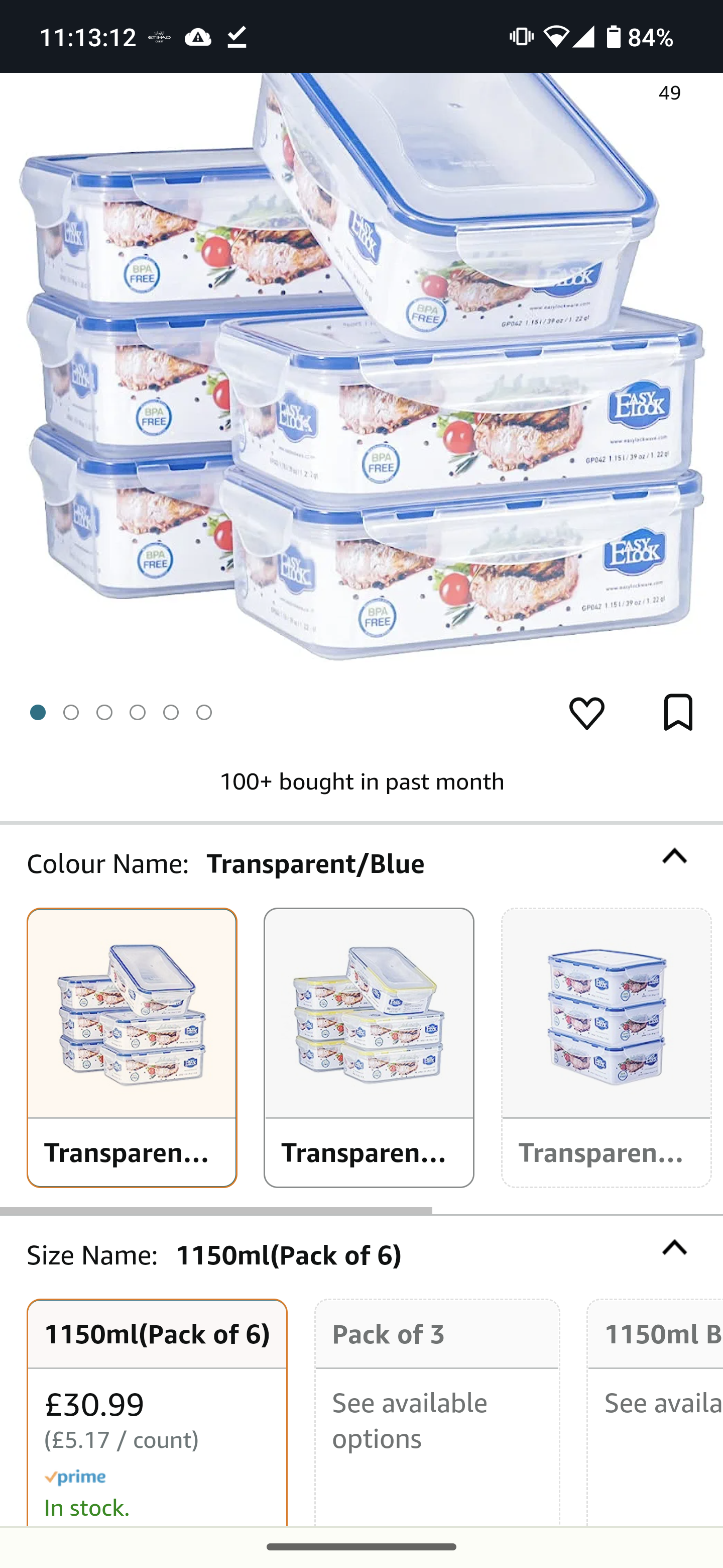

Silica gel packs in bags of 100s are available on Amazon for very little cost, see example below. I use them with any watches I get, I put the watch in a small ziplock type bag 5cm x 5cm and throw in a gel pack to avoid any moisture damage until I get around to working on the watch. I also use lock and lock type containers for my infrequently used hand tools and spares etc, again throwing in a few gel packs in the bottom of the container for cheap insurance.
For removing rust from things like staking tools I find WD40 does a great job and is also a water dispersant (the WD in WD40) so protects against new rust at the same time.
Bags like these
And containers like these
