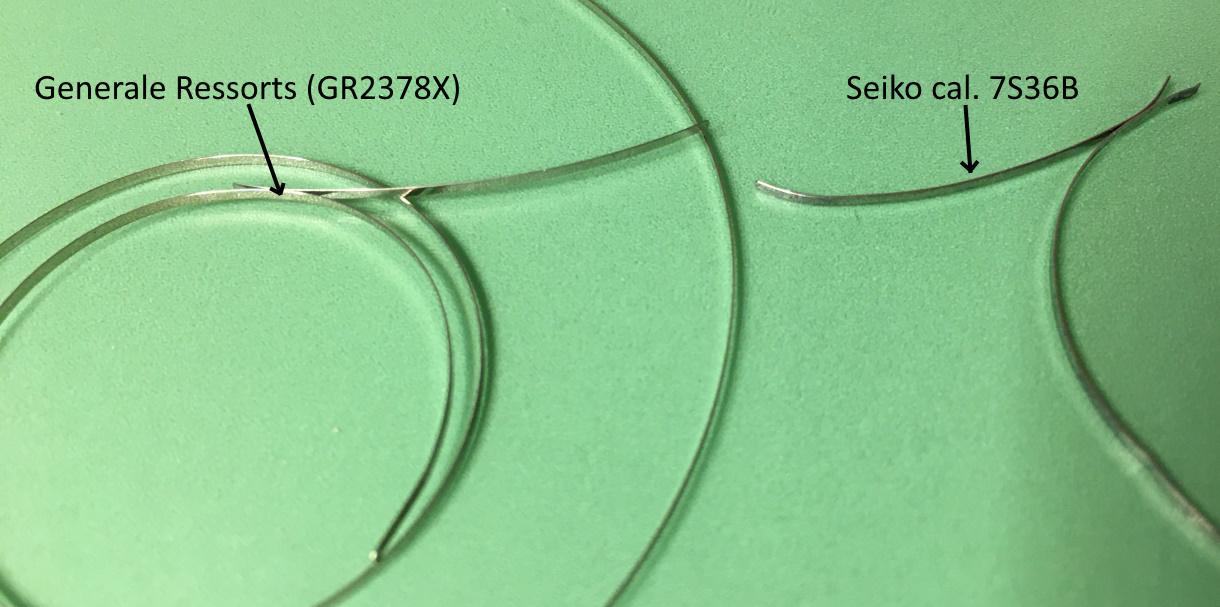

I found the thread over on wrist sushi where I showed the difference in bridle thickness between an OE Seiko mainspring for a 6309 and a GR equivalent and the one on the Seiko spring was just under (by .01mm) twice as thick as the one on the GR mainspring.
Interesting. I'll measure my Seiko spring and my GR spring (once I've taken it out of the barrel) and see if I get the same result. The big question then is how a twice as thick bridle affects the slippage!?

As can be seen in this picture, the bridle profile of the GR spring and the bridle profile of the Seiko spring is quite different. The bridle on the Seiko is attached at the end of the spring whereas the bridle on the GR spring is attached before the end of the spring. And while the GR spring has just a single smooth curve, the Seiko bridle has an introductory and concluding dent which the GR spring lacks. The thickness of both springs is 0.12 mm but the thickness of the bridle on the Seiko spring is 0.19 mm, whereas the thickness of the GR spring is 0.14 mm. So, overall thickness at the bridle section is 0.05 mm fatter on the Seiko than on the GR spring.
I’m now inclined to think that it is mostly the thickness and profile of the Seiko bridle that yields its better power reserve compared to the GR spring. Of course, the grease has an effect too, but my guess is that the grease is secondary to the shape and thickness of the respective bridle.
Once I get my Bergeon winder I’ll try the Seiko spring in my Orient barrel with some Kluber P125. It should be a couple of weeks from now but as soon as the result is in I’ll report it to the thread.
Oh, and I would really appreciate a good source (or two) for picking up suitable Seiko mainsprings and/or barrel complete!
Anyway, I’m extremely interested in your thoughts and suggestions!
Edited by VWatchie
That can be easily corrected, as it was suggested above.

I’m afraid I’m not convinced as these springs are quite brittle. Have you tried it? Any particular technique to preserve its durability? I’d hate to ruin yet another mainspring :(
