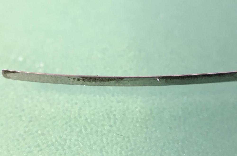

I’m still struggling to get a decent power reserve on my Orient cal. 46E40. As far as I can tell and as a reference, the barrel and spring seem to be identical to the Seiko cal. 7S-series, for example my Seiko cal. 7S36B.
As a replacement I use a brand new Generale Ressorts # GR2378X mainspring (0.95 x .12 x 400 x 10.5 Automatic). In my first attempt I used Moebius 8217 but only got about 24 hours of power reserve. I then read what I could find about it here on WRT and got inspired by this post by @nickelsilver. So, I got myself some emery paper, rubbed the wall so that the brass shone through and applied a thin layer of Moebius Glissalube A 8213 to the barrel wall. To keep the barrel steady while lubricating I shoved a smoothing broach in the hole of the barrel. However, when I was to remove the broach from the barrel it had gotten stuck in the barrel hole, and not realizing the broach is super finely threaded, and left threaded at that, I ruined the barrel trying to get it out of the hole :pulling-hair-out:
So, I had to source a new barrel, and let me assure you, Orient and their retailers won’t be helpful. Eventually, I found a seller on eBay in Spain who knew the barrel between my Orient cal. 46E40 and Orient cal. 46943 are identical and I bought a scrap movement from him and extracted the barrel.
After two weeks of waiting for the new (used) barrel, I decided not to rub the wall of the barrel but instead buy some uber-expensive Kluber P125 and apply it to the best of my ability in accordance with this post by @JohnR725. However, this only lessened the power reserve to about 17 hours. So, I took the barrel apart and took the below pictures of what I saw. Don’t know what the pictures add but nevertheless...
I’m beginning to feel extremely frustrated about this and don’t know what to try next. Perhaps rub the barrel wall to expose some of the brass and apply Glissalube A? Perhaps no braking grease at all? Perhaps the replacement General Ressorts spring in some way just isn’t compatible with Japanese barrels? I’m really lost here and don’t know where to go next. So, some help and inspiration would be greatly appreciated.

Unfortunately it didn't help one bit. If anything, things got from bad to worse. With a small amount of Kluber P125 the ratchet wheel would make 4.5 revolutions before slipping (about 17 hours of power reserve). With Kluber P125 around the entire wall and pretty generously at that, the ratchet wheel would only do 4 revolutions before slipping. I can't hear or feel the spring slipping so I count the revolutions when winding down.
To make matters even more annoying I've ruined two new very expensive Generale Ressorts springs in the process trying to wind them back into my K&D mainspring winder (which really sucks). I first tried to get it back using my fingers, but it only resulted in slipping around and getting Kluber all over the place. I guess replacing mainsprings by hand requires quite a bit of practising.
I can't remember when I felt this frustrated trying to fix a watch. It seems so easy, and still it fails. I wonder what those Japanese people are doing in the Orient/Seiko factory.
In some thread someone mentioned that @jdm was the "master" of these Japanese movements and how to handle the barrel/mainspring. I haven't yet searched it like crazy it but I'll see what I can find.
So, perhaps emery paper on the barrel wall to get a rough brass surface and then some Moebius Glissalube A? And again, I will have to order another mainspring, or a Bergeon mainspring winder, or both to make sure :(
There is something definitely really wrong here. I know from experience when I listen to bad advice for a Seiko and applied the Kluber P125 Around the entire rim. When I was manually winding it up with the screw of the ratchet wheel and I reached the end I almost thought I was going to break the screw head off. Yes it slipped but it was so dramatically not slip paying which is why thought I'd going to break the head off. The you seem to be getting the exact opposite of what should be occurring there is definitely something not right here at all.
The dimensions of the new spring versus the old are they the same for the Springs look the same?
