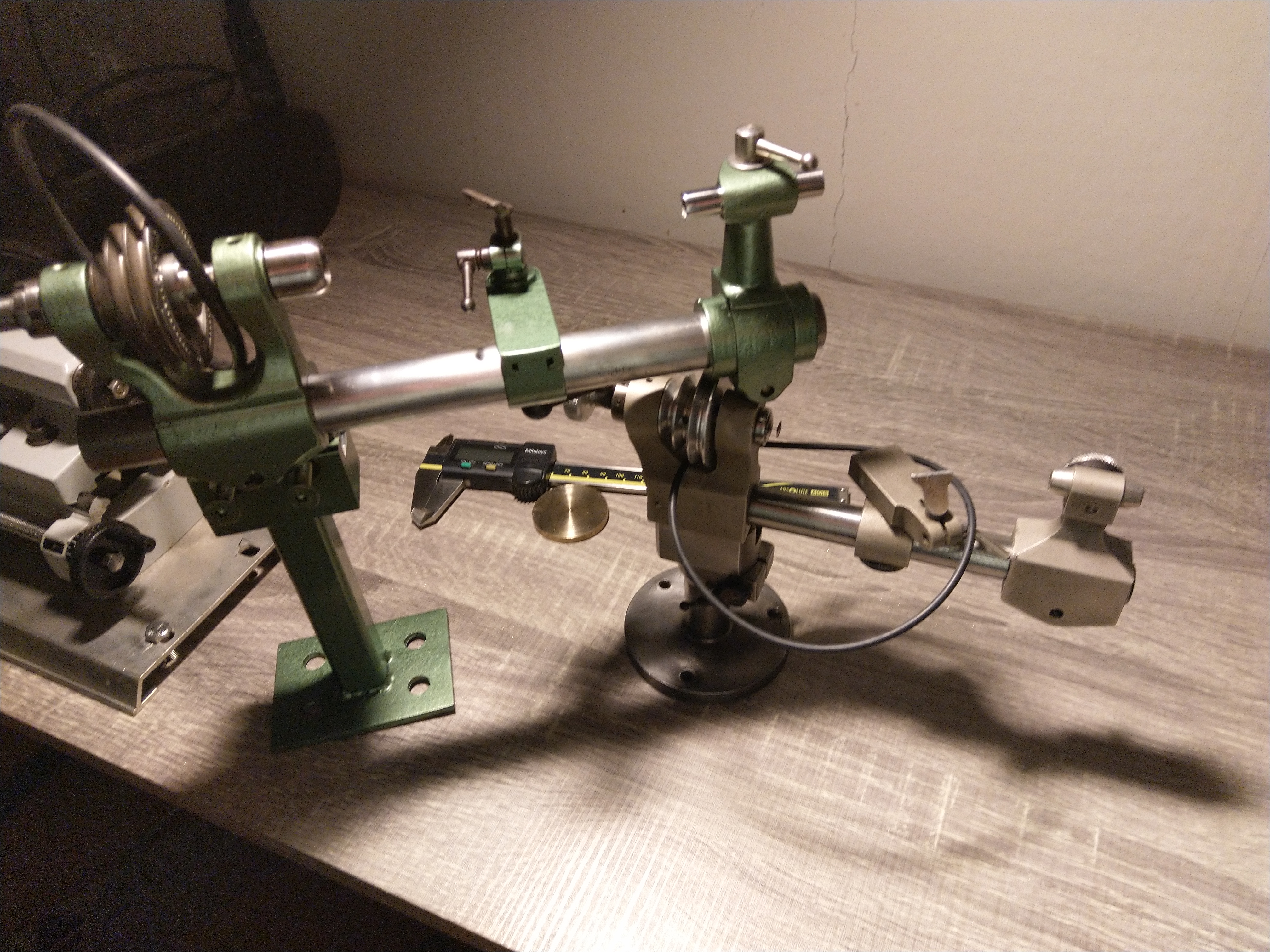

I picked up another lathe...just because I guess.  I did not have a motor nor tail stock.  I scavenged a motor from an old sewing machine I had in the queue for the dump (whew, glad I woke up regarding that).

I think sewing machine motors are good replacements, here is one of my “bigger” small lathes with a frequency controlled sewing machine servo motor (brushless). I use the original 5mm rubber belts for the EMCO Unimat 3 even if this is a 550W motor, it works just fine.
I have the same rubber belts for my Geneva style lathes too, they are really cheap. Think they are just a 100mm in diameter rubber gasket.

Nice.  Long term, I am going to replace it with a PWM driven BLDC--an overall better solution I think.  I have to reverse my sewing machine motor buy wrapping the belt in figure 8.  I could take it apart and reverse the field winding but that is a hassle.  Happy with figure 8 for now.
Yes, the brushed motors from a sewing machine usually runs "backwards"  those ones one just can flip them 180 degrees horisontal. Then it runs the right direction... On the brushless you just push a button for the rotation direction.

Yeah, that was the first thing I did.  Just lacked aesthetics, so I put it back the way I had it and put the belt into a figure 8.  Once I transition to the BLDC, all problems go away!
Expand
Your is a watchmaker's lathe, so a powerful motor, belts etc are not important.  Very different from even an baby lathe like HSL's, on these you want to cut steel and the standard motor is easily not enough, there are other limiting factors, I know a old machinist that says "for each one his own". See if you can get to turn a cannon pinion to fit precisely the minute wheel, using just a graver. That is the kind of work it is made for.
The Geneva style lathes I mentioned above which I run with the same setup is an 8mm Lorch and a 6mm BMC, even if the motor is slightly more powerful, I think I get good enough control to cut a cannon pinion or two, even made a new axis for an escapement wheel the other day.
Guess I got a bit lazy with age and think new technology to control the revs is convenient, but I still think these rubber drive belts work just fine.
