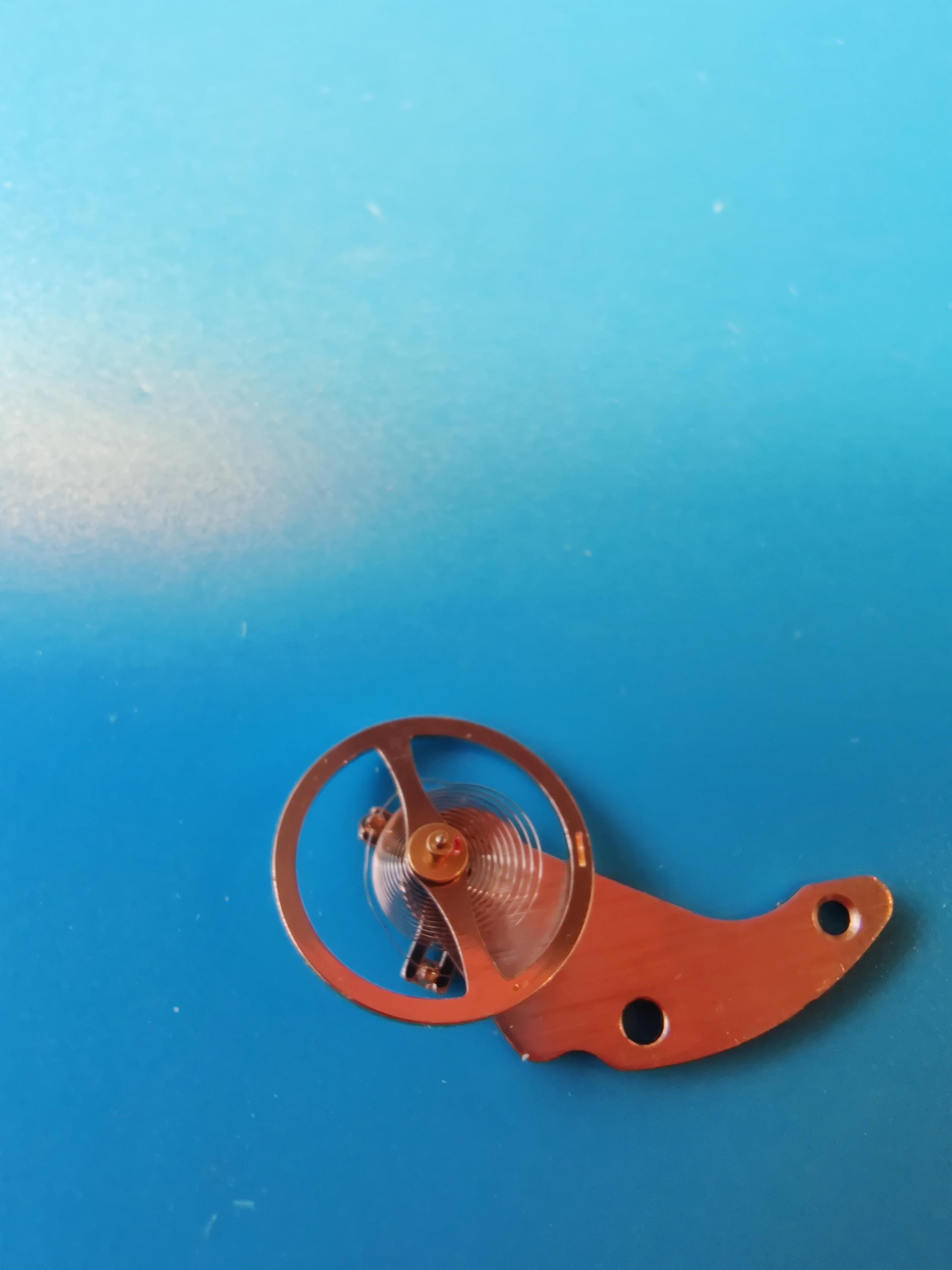

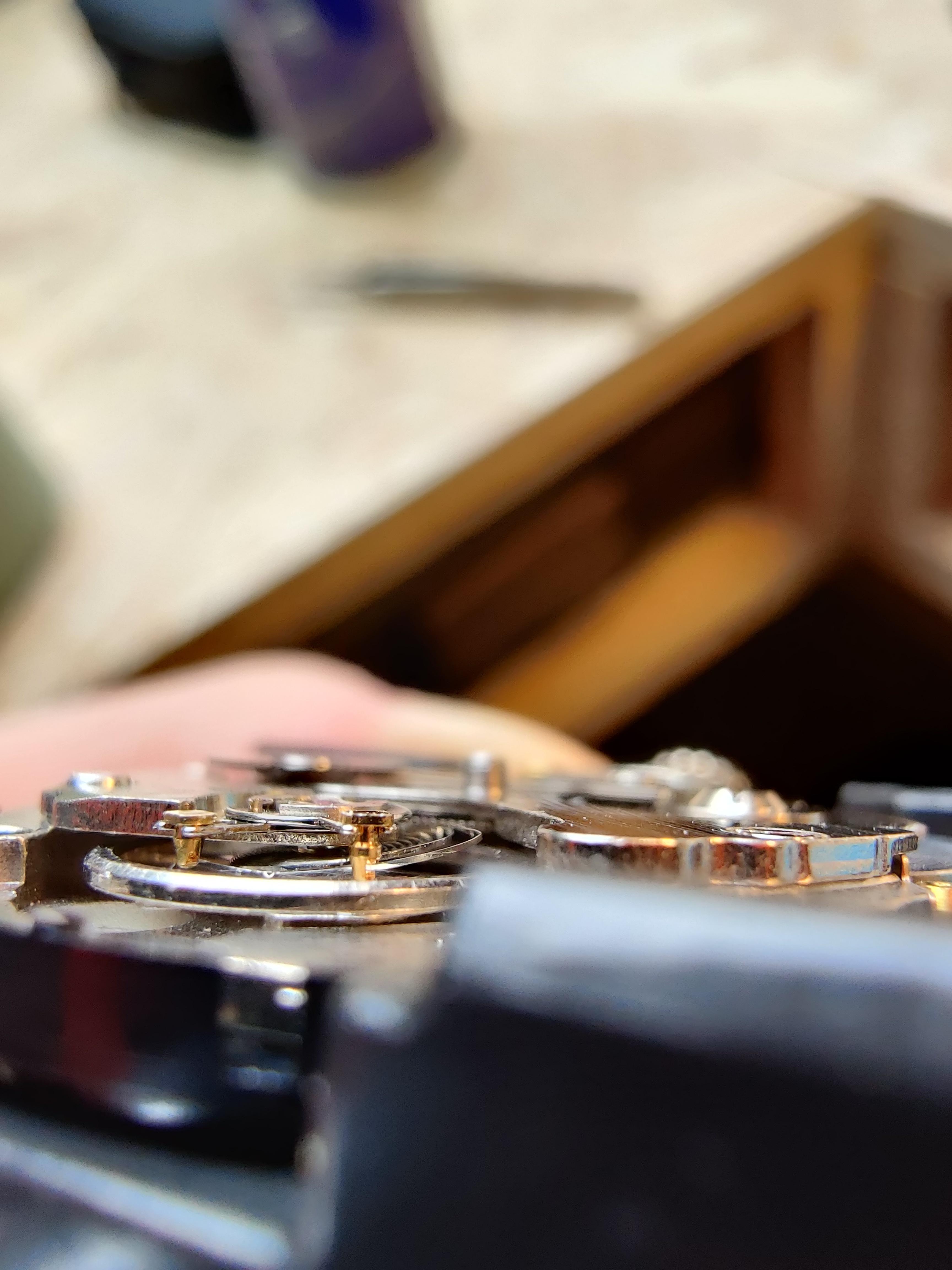

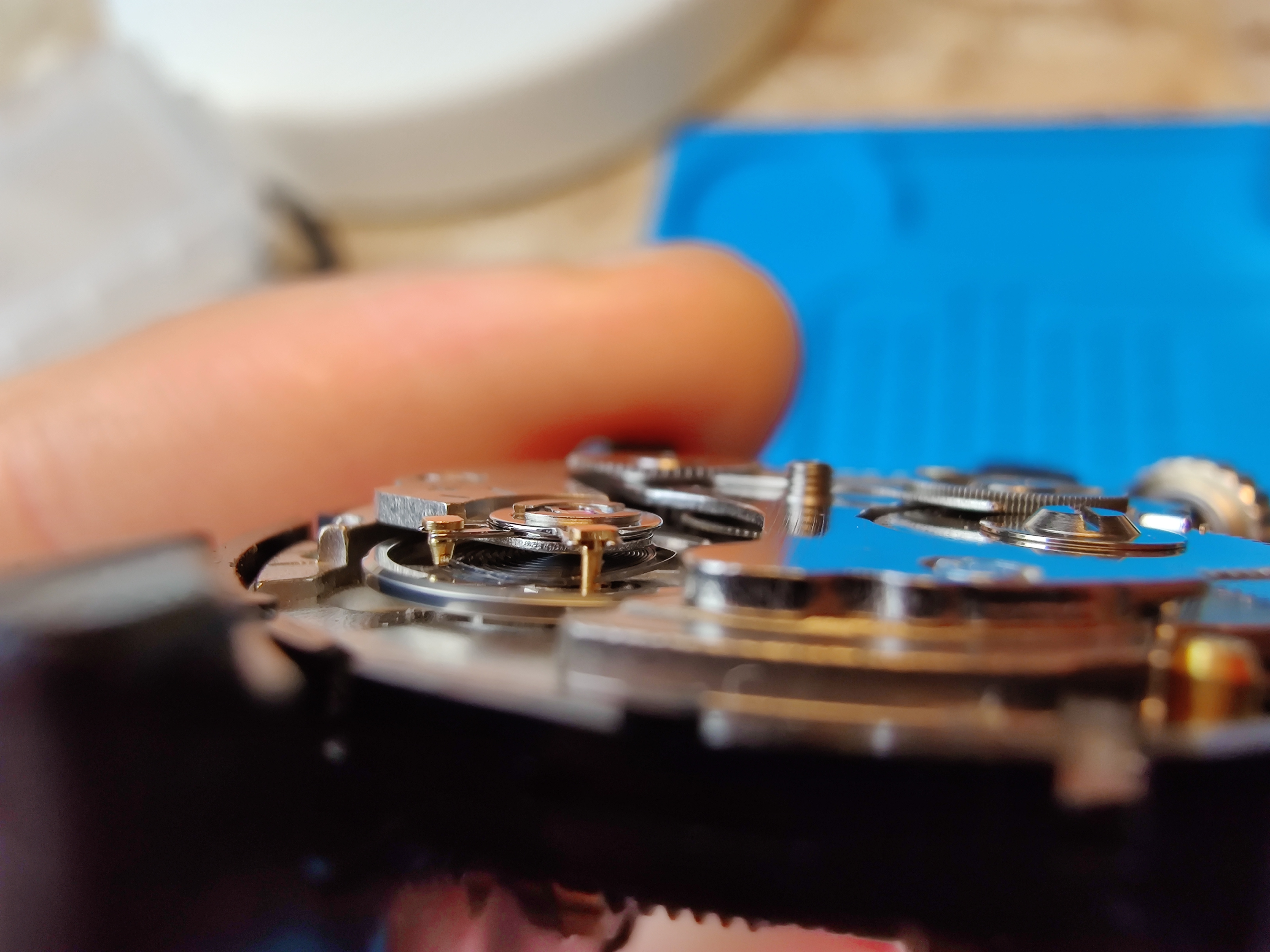

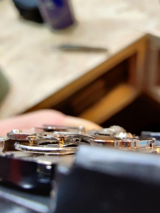

Dear,

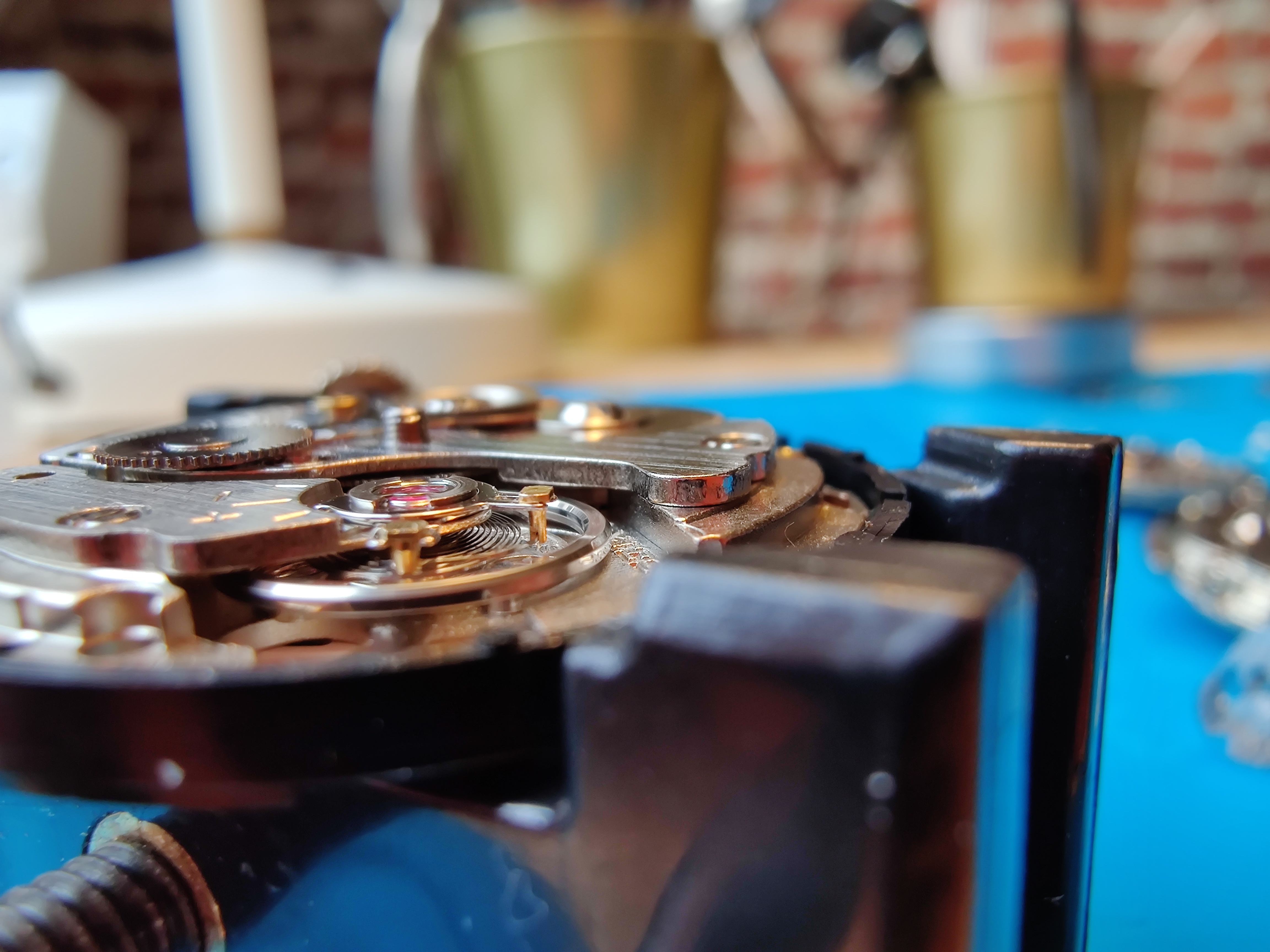

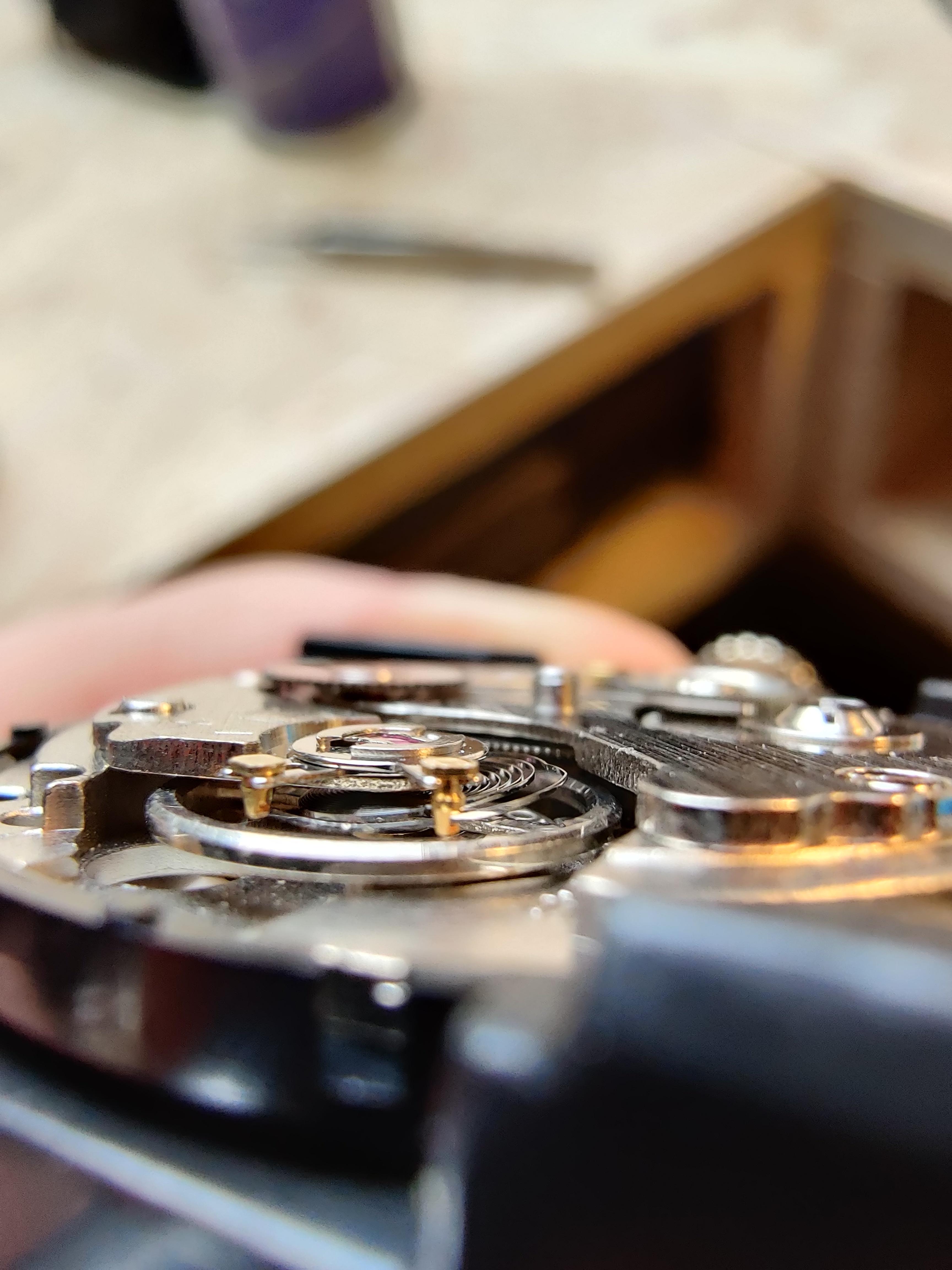

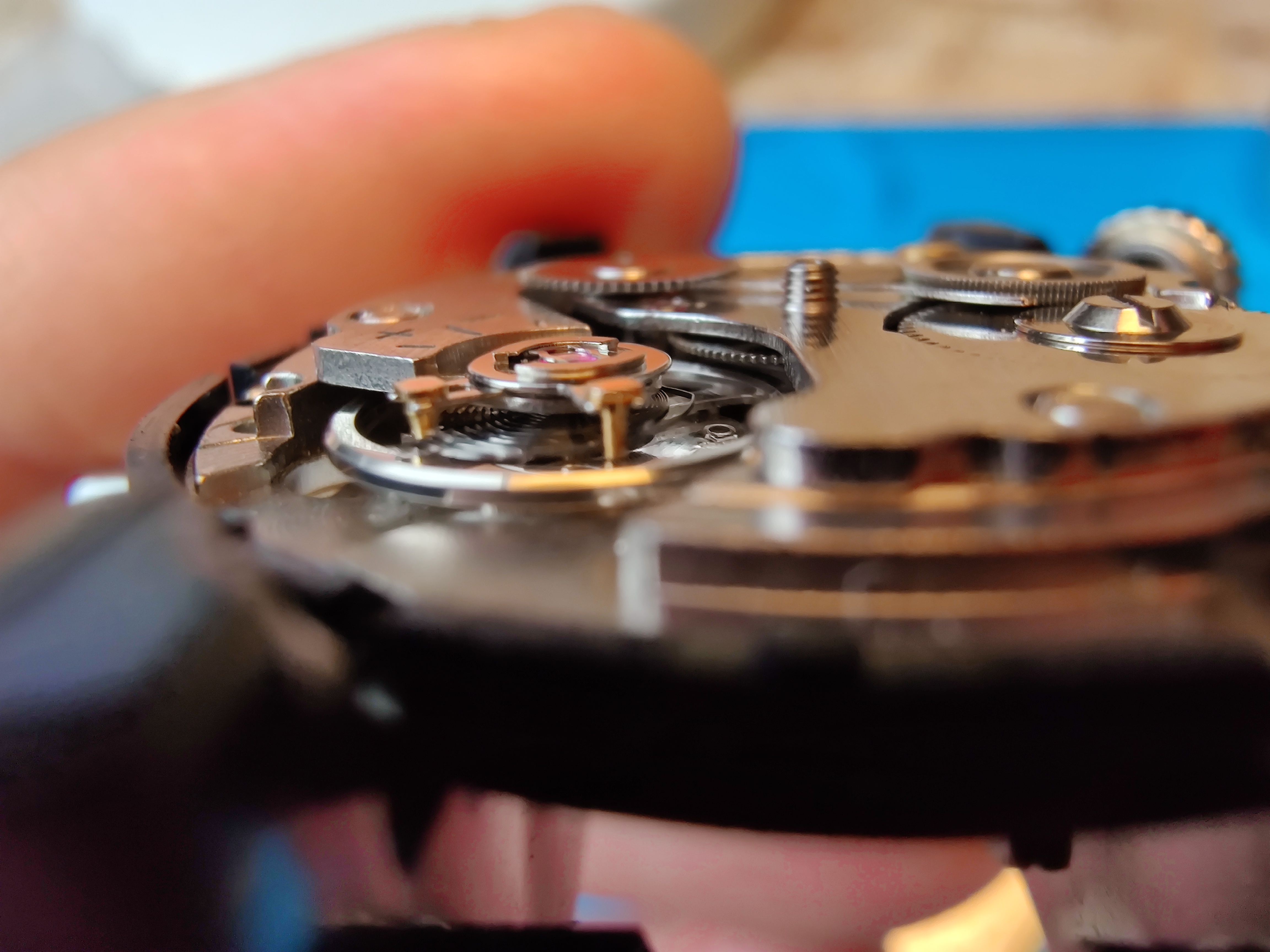

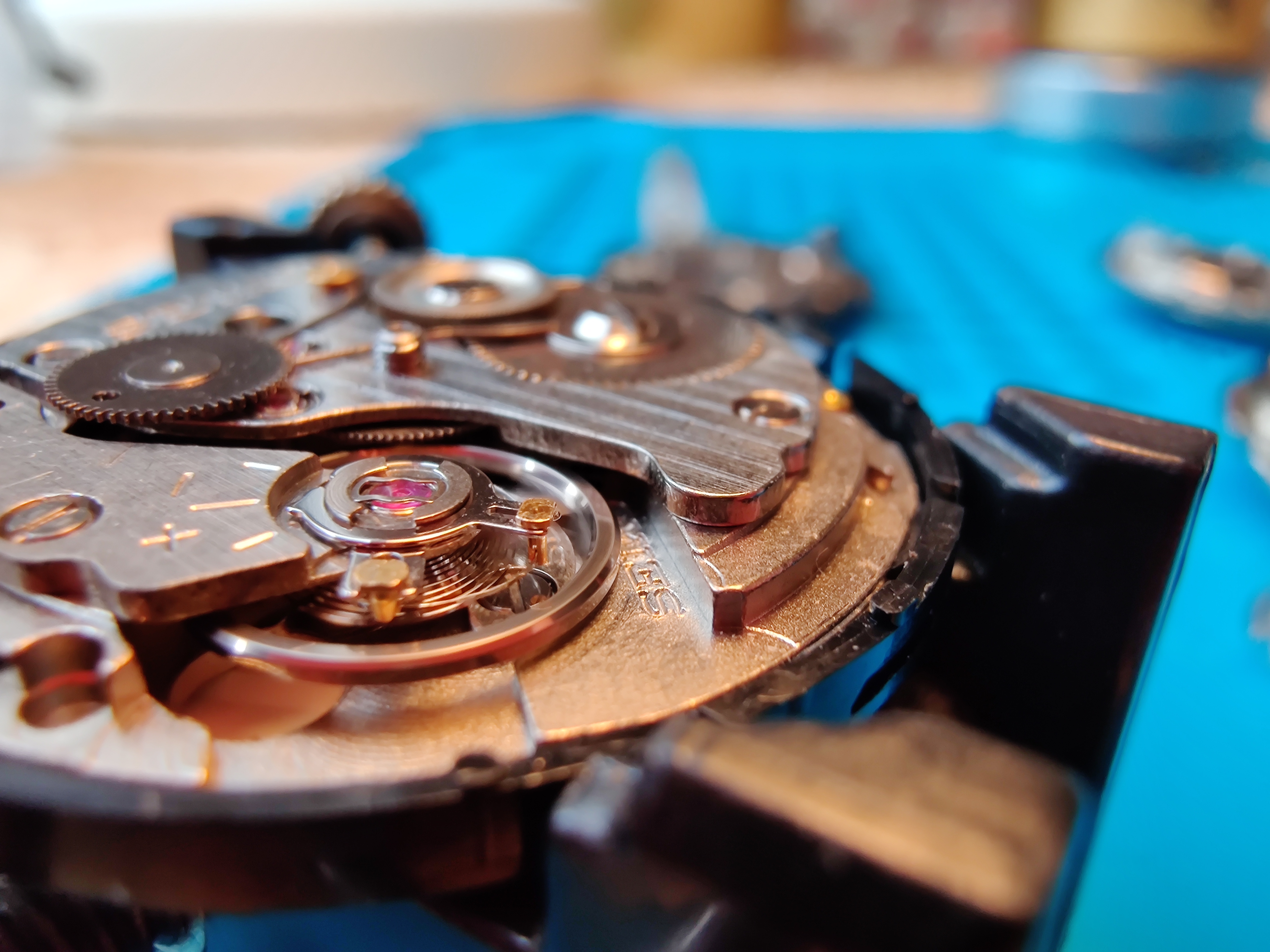

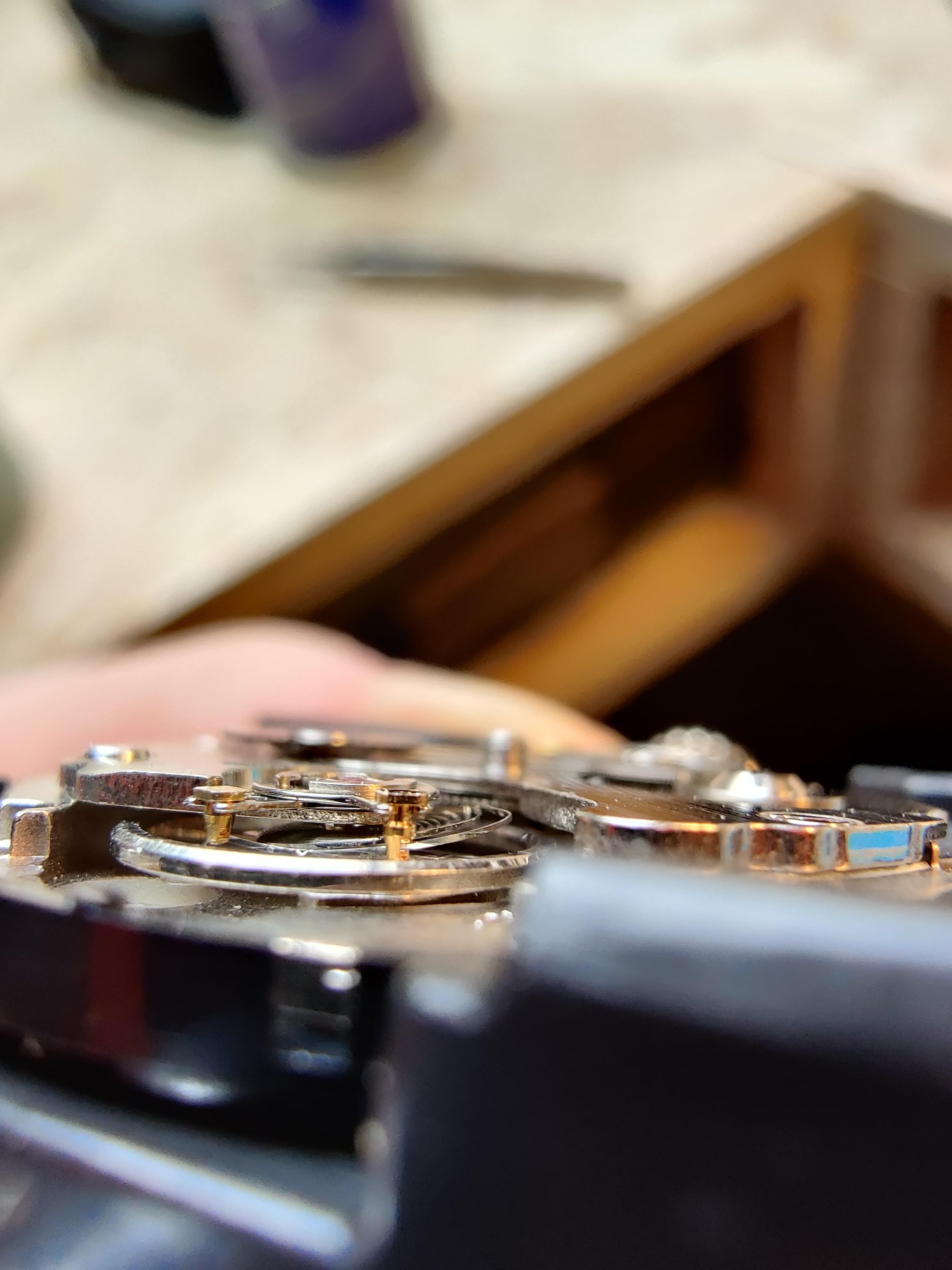

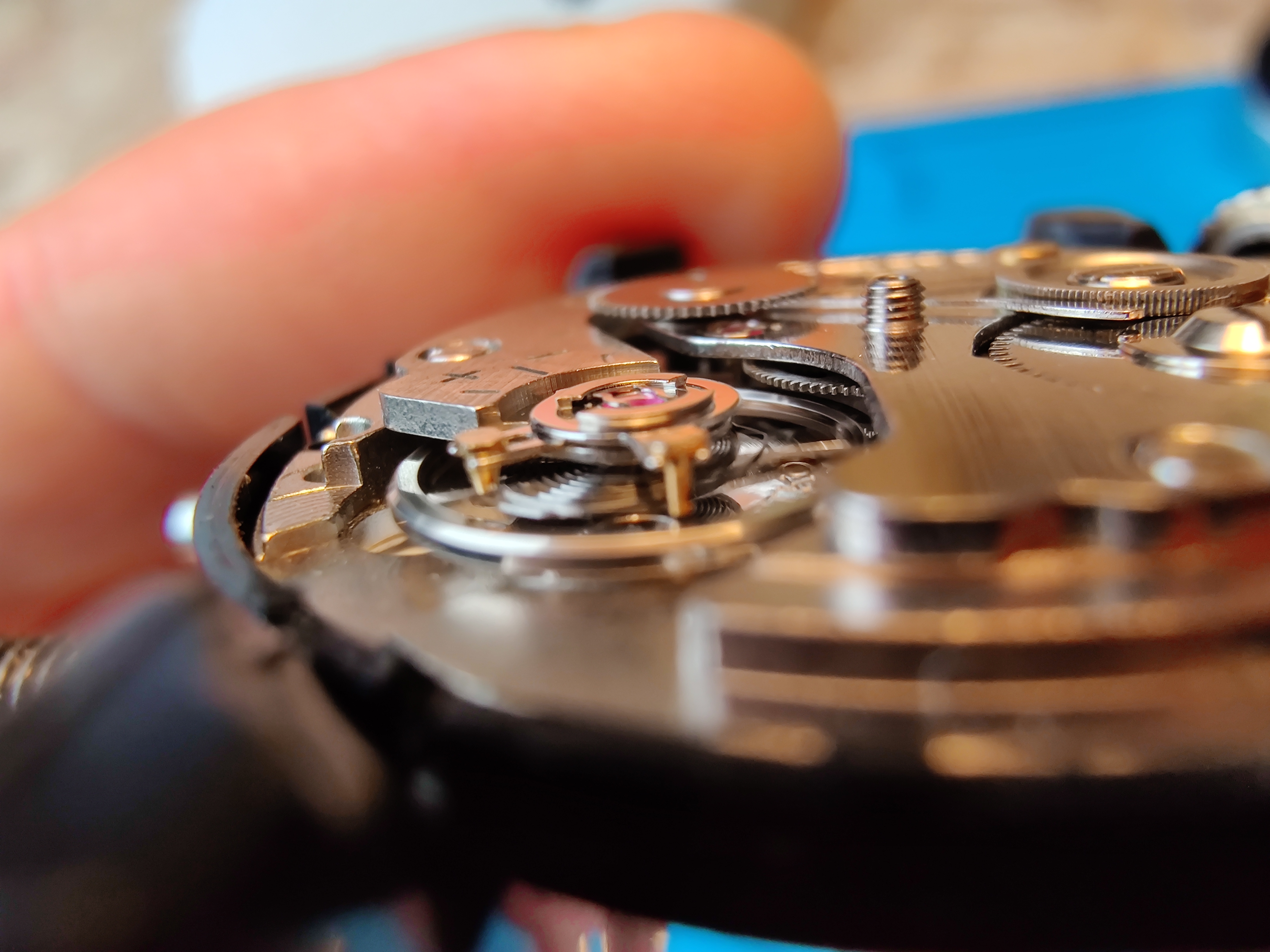

I regulated an NH35 movement. I got it perfect. No beat error and -2/+2 seconds. Amplitude was high and healthy. After a few minutes it stopped ticking. After moving it a bit it started but the amplitude was below 130 and the timegrapher hardly got a reading. Now it doesnt even move.
I removed the balance complete and checked that the pallet fork has power (see video). It does have power
I reinstalled the balance complete and checked if the hairspring moves freely (see video). It does
I uploaded some pictures so you can check the hairspring.
I have also checked the jewel and it seems to be ok.
Do you guys have any advice? As you can see I'm very much a novice and an amateur but thank you for your time.
Jasper

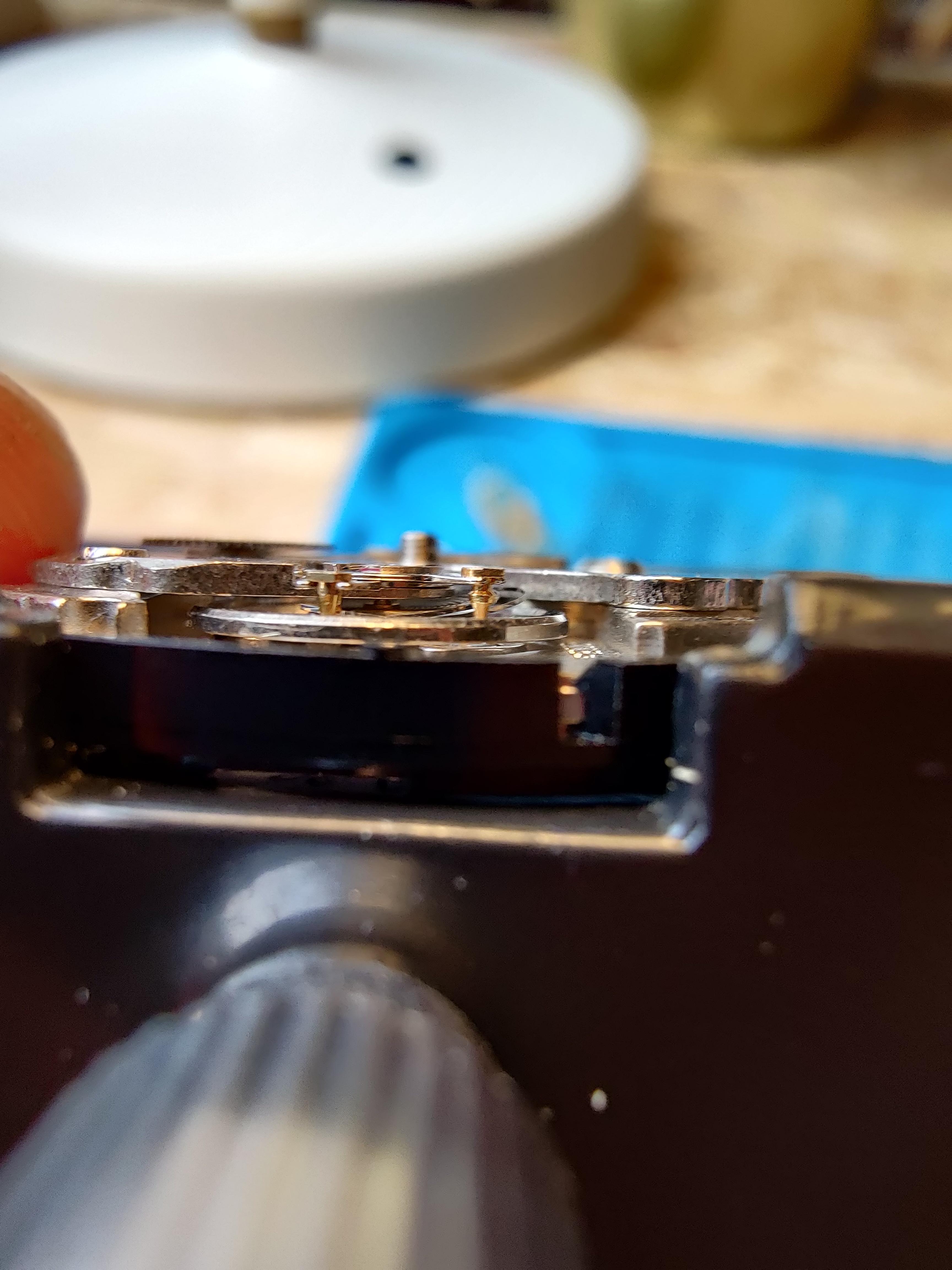

Notice how when you push on the balance wheel it comes to a stop really fast? Look inside ways and make sure they hairspring is flat and not touching the arms of the balance wheel or the bridge. Then when you are regulating how hard did you push down on the things you are moving? Like if you loosen the balance bridge screw a little bit will it run?

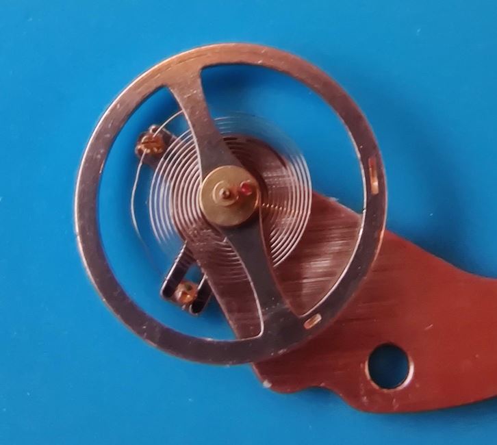

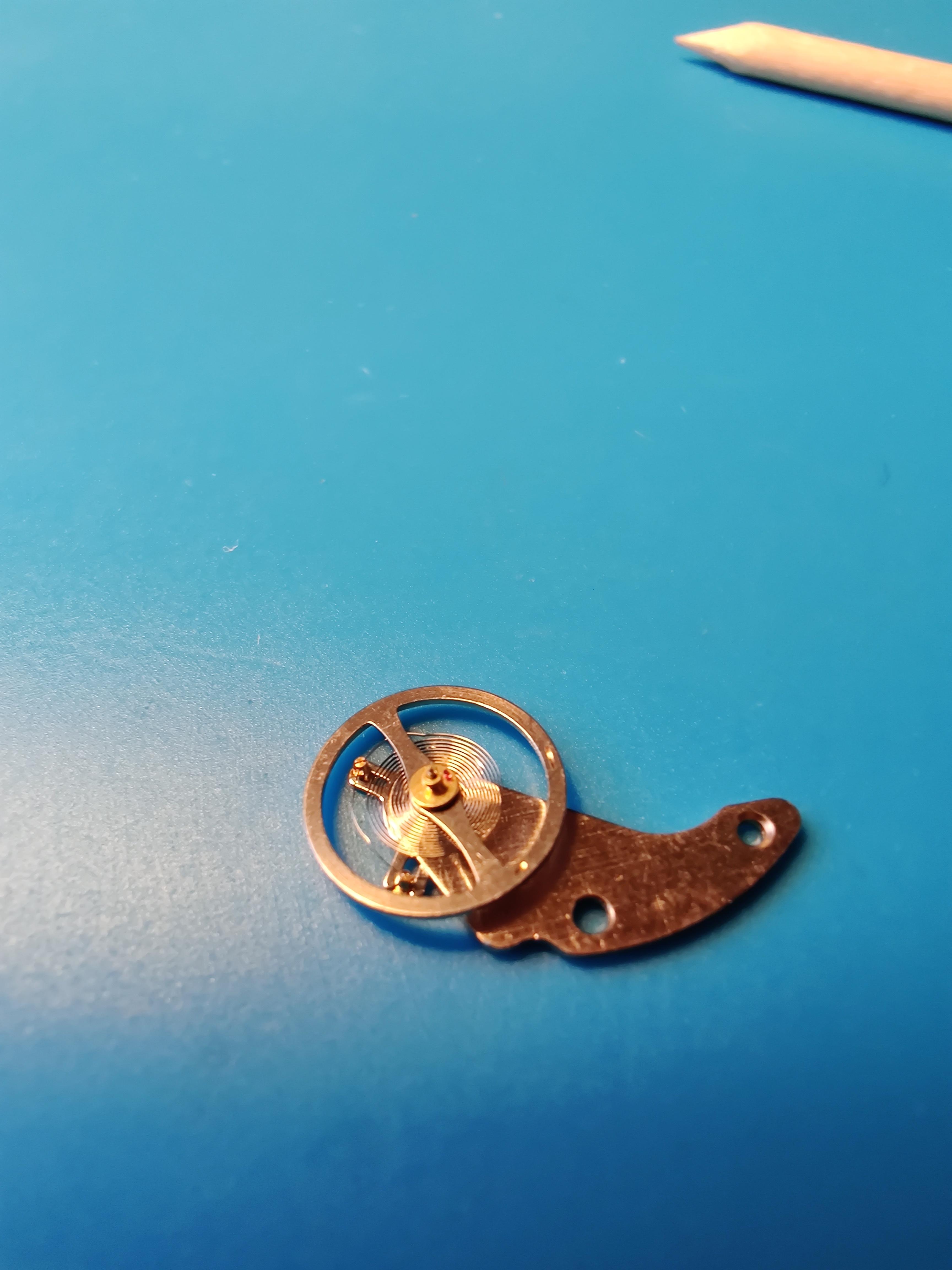

Dear JohnR725
Thank you for your reply. No it will not run anymore. Even when loosening the balance bridge.

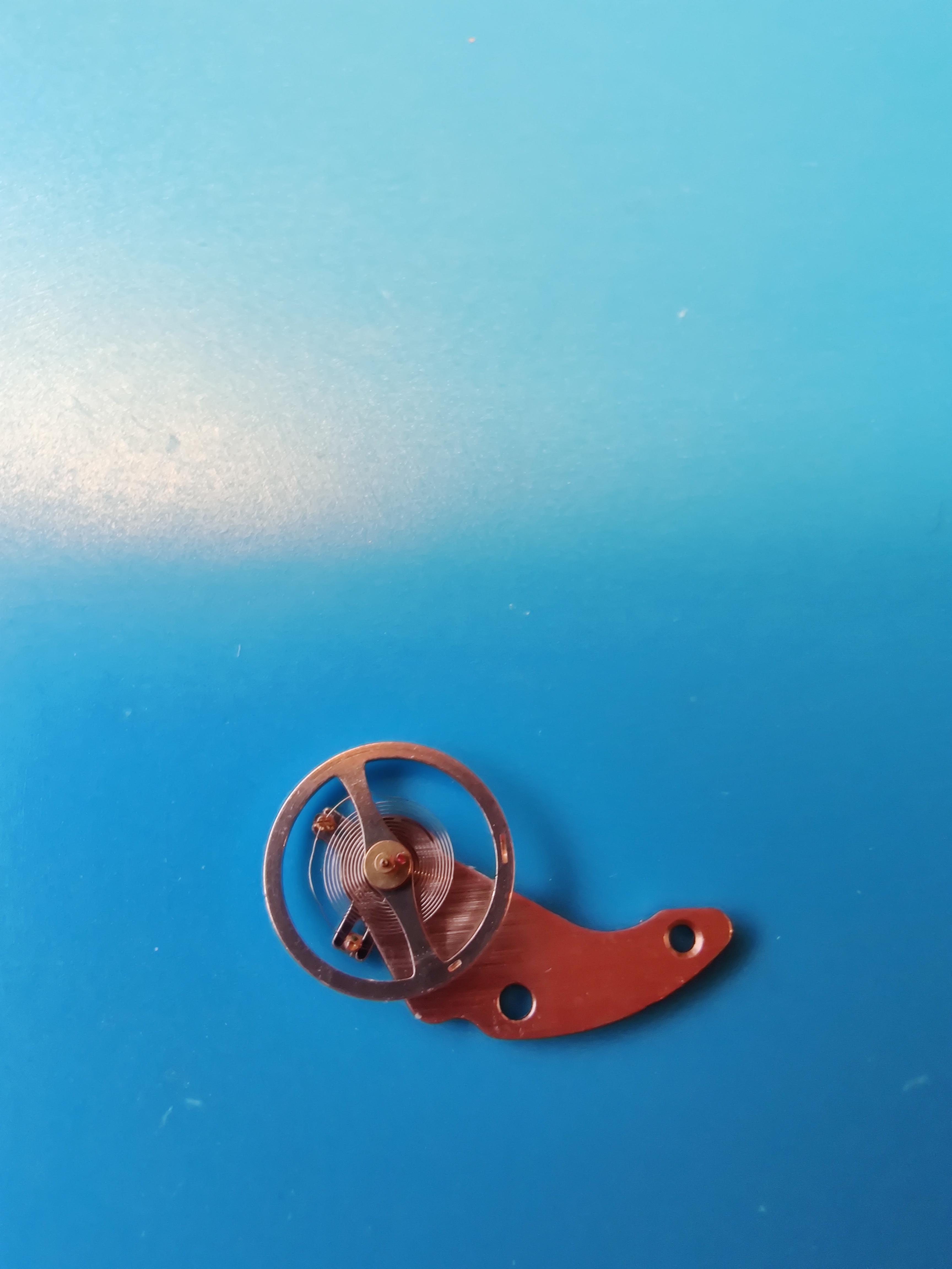

I have taken pictures off the hairspring and I do see that it takes a huge curve up. I think this might be the issue. Does that mean the spring is bent? Did I install the balance perhaps incorrectly? Can this be corrected?
Thanks so much.

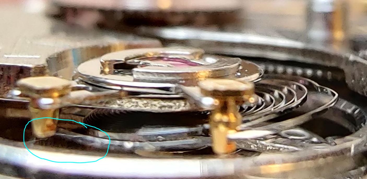

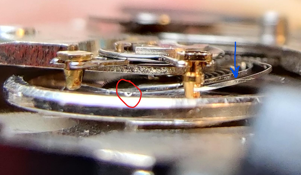

Replacement balances are quite cheap for these movements.
Looks like there may be a bend at the red circle.
I'm not sure you can take the hairspring off these, but you could try and correct it in situ : hold the spring with tweezers at the red circle, and push down at the blue arrow. You need good magnification and steady hands !
If there's a twist, it's a bit more difficult. A close-up picture from above the red circle would show that.

I think you should attempt to flatten the hairspring, as @mikepilk suggests. Removing these hairsprings are not fun, and there is a considerable risk of damaging the hairspring either in removal or reinstallation. If you can lay the balance complete on its back, you may be able to flatten it out by grabbing at the bend and then gently lifting where it curves up (down when the balance is upside-down).

I'm attaching a bunch of images some of them are yours enhanced slightly.
I was going to object to something last night but I just let it slide. While it is nice to have all those pictures of the balance wheel out of the watch so we can see that they hairspring looked pretty good there's a problem. The problem is the problem is only a problem typically in the watch. This is where pictures of balance wheels out of the watch like the one that I have reattached makes things look really good. What were missing was a really good picture aimed straight  down so we could see if they hairspring is centered in the watch and of course all important is Is the hairspring flat. Learning if they hairspring is flat takes a lot of time. The problem is if the hairspring touches the balance arms you lose heck of a lot of energy.
This watch uses the etachron system for the regulator and stud. For the factory it makes it really easy to get things adjusted. But should you have to remove the balance wheel its a problem. Which is why typically wouldn't remove the balance wheel from the bridge even for cleaning. So basically this is a good and bad thing. What you want to do is look at the image then open up the regulator to its maximum open. This is so the hairspring is not caught up there to make it easier to figure out where the bend is near the stud or at the stud. As this is the probably the most common place where you going to bend the hairspring. Not that you can't get creative like one of the images up above and do other bad things.
The first step is figure out what you're doing? This means you need to stare at the balance wheel and hairspring see if you can figure out where it's bent. I have an image where it looks like it's twisted. Someone above has an image a little farther down of where they think it is. They also show where they think you should push to fix the problem I would not do that. The band is usually in a specific place you want to fix that place.

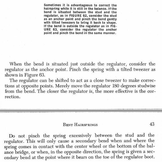

I'm attaching some images out of a book it will give you some ideas for how to fix the problem. Then ideally when working on hairsprings you need special Tweezers that you need to hide and not used for anything other than hairspring work. They have nice narrow tips to get down to where you need to be.

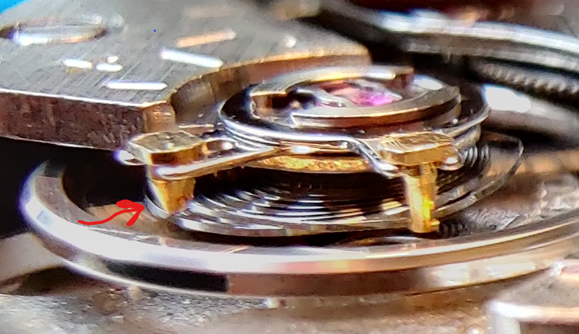

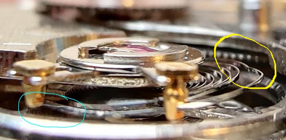

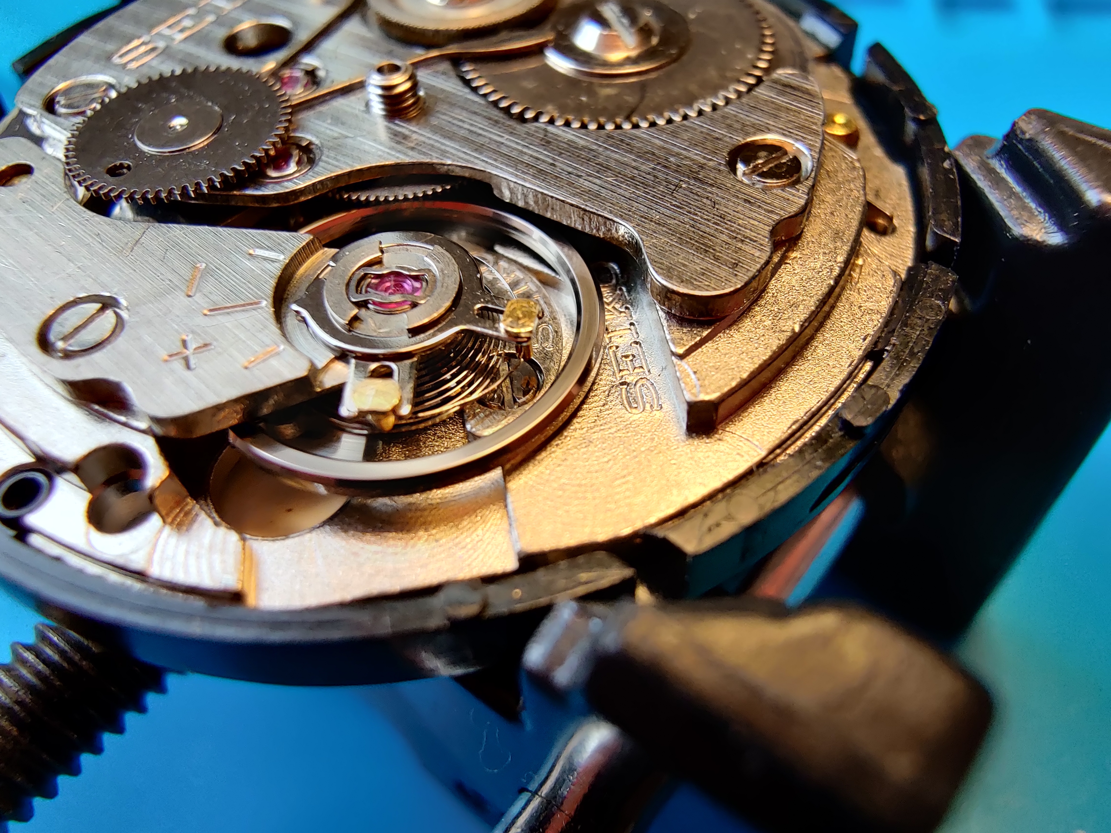

Other's answers are perfectly right when it comes to trying oneself to repair an hairspring after having somehow damaged it. I'll be blunt, for a total beginner chances of bringing it to a better state are very low -- ask me how do I know.
While at it look at the section circled in yellow too.
2053886673_hairspringfunA.thumb.JPG.be9467b26bd27c86a7ba49ebb7bfbc9a.jpg.e54da4d3307147dc7704921cc85e3cd6.jpg
Anyway, the point I want to make is that an hairspring bent like this does not stop a Seiko mov.t, especially not all of a sudden without apparent external event.
So also consider and investigate another cause, e.g. a piece of debris (a minuscule piece of scalp skin is plenty enough) went in between gears, etc.

Thank you so much for these elaborate responses. You guys are correct where exactly the hairspring is bent. Seeing that replacing is not an option I have tried to fix it still attached to the balance cock. During this the balance detached from the balance cock. Now I see that where the regulator pin for the beat error adjustment is, the spring wire is almost vertical. I must have hit it when I adjusted the movement. I'm suprised that it is that way since I didn't know I hit it. This proves how much of a novice I am.
Still I have tried to flatten it following JohnR725's advice. This has worked so much better than expected. It's almost back to normal. However I am unable currently to reattach the regulator pin to the balance cock. I am looking for documentation on how but currently can't find any.

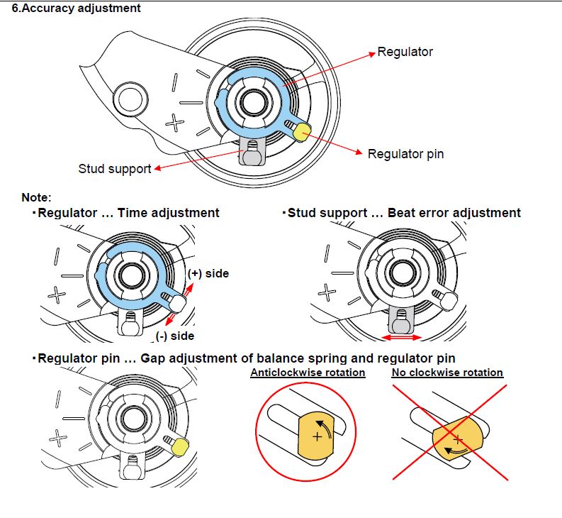

I think you mean the end stud, not the regulator pin.
The documentation, which usually is copiously posted in each and every Seiko topic has few steps and pictures about that. In summary:
  • Install balance temporarily
  • Hairspring on the outside of regulator
  • Use sturdy tweezers to press end stud into moveable arm. It will distinctly click when it's in place.
  • Remove balance, move the two arms to be well distanced.
  • Fit hairsping in regulator slot.
  • Reset arms to a normal position, refit balance.
  On 1/18/2021 at 6:43 PM, mikepilk said:
 I haven't before seen instructions on working on a hairspring still in the balance. Which book is this in ?
Expand
I'm attaching an image from the book. You can Google title you can find that it's on Amazon and it seems to come in a variety of versions? It looks like the link below the hard cover is what you definitely want at that bargain price. Even the paperback seems pricey but it does have a really nice section on fixing up hairsprings
The book I have is 260 pages so the link is correct sort of. If you go down the page notices a reference to another book same title same author reproduction of the 1954 edition. Notice it's much cheaper and it has way more pages?
The last time I remember somebody trying to purchase this book whatever edition they ended up with was missing they hairspring section? Which is always troubling if you recommend a book and it comes in too many versions which makes for confusion.
The last time I remember somebody trying to purchae this book whatever edition they ended up with was missing they hairspring section? Which is always troubling if you recommend a book and it comes in too many versions which makes for confusion.
https://www.amazon.com/Bench-Practices-Watch-Clockmakers-Henry/dp/096562191X
Expand
Thanks @JohnR725, I'll try to find a copy. I do have Fried's 'The Watch Repairer's Manual', which is my standard reference.

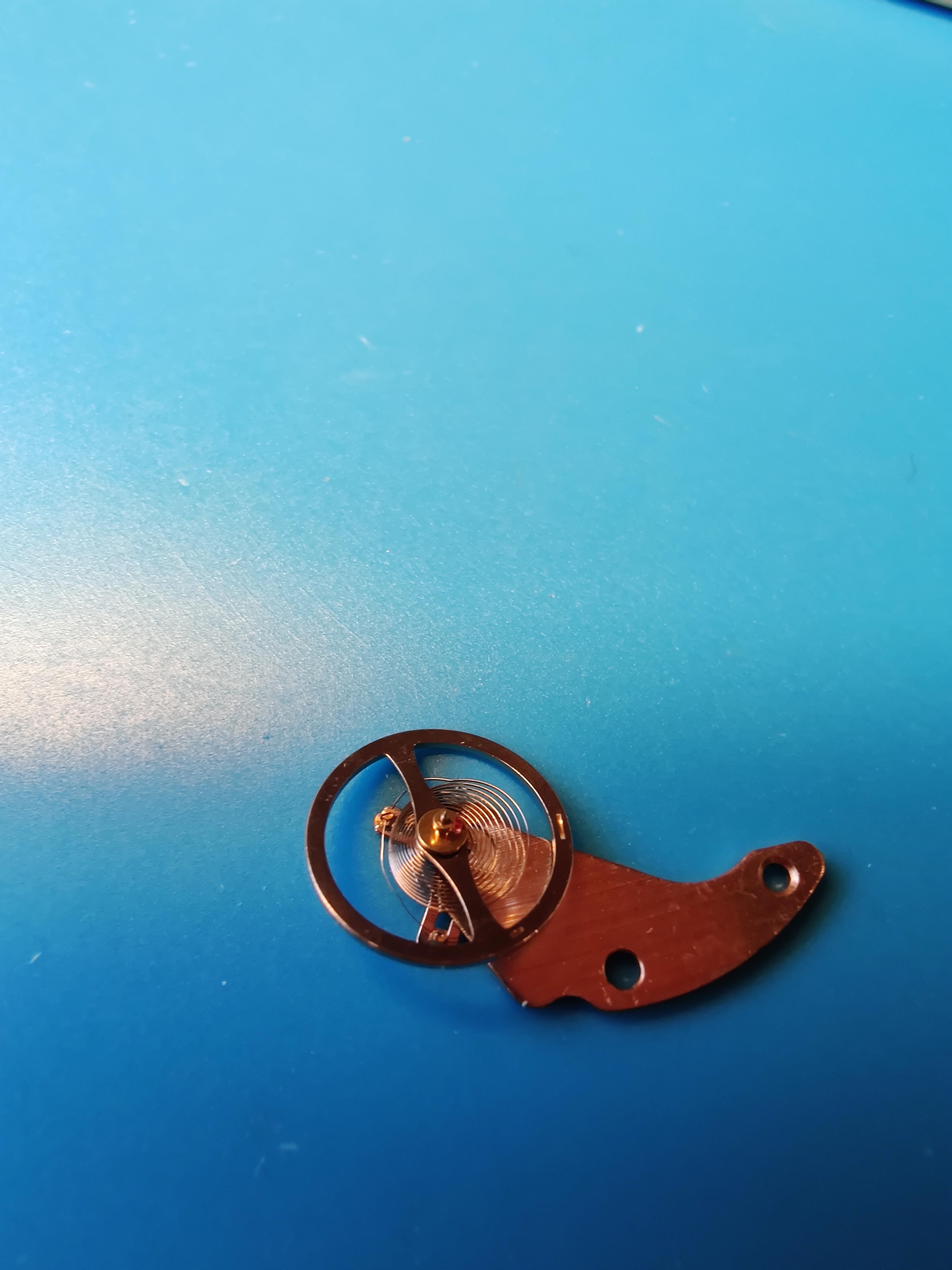

Hi guys,
I was able to reinstall press the stud into the moveable arm. Which was great practice. However the hairpspring is beyond saving now. Thanks again for all the help!
Jasper
How about a side and top view of the coil, let,s see what you call beyound repair,  though you will get ten opposing feedbacks.
The one shown above is easily sortable.

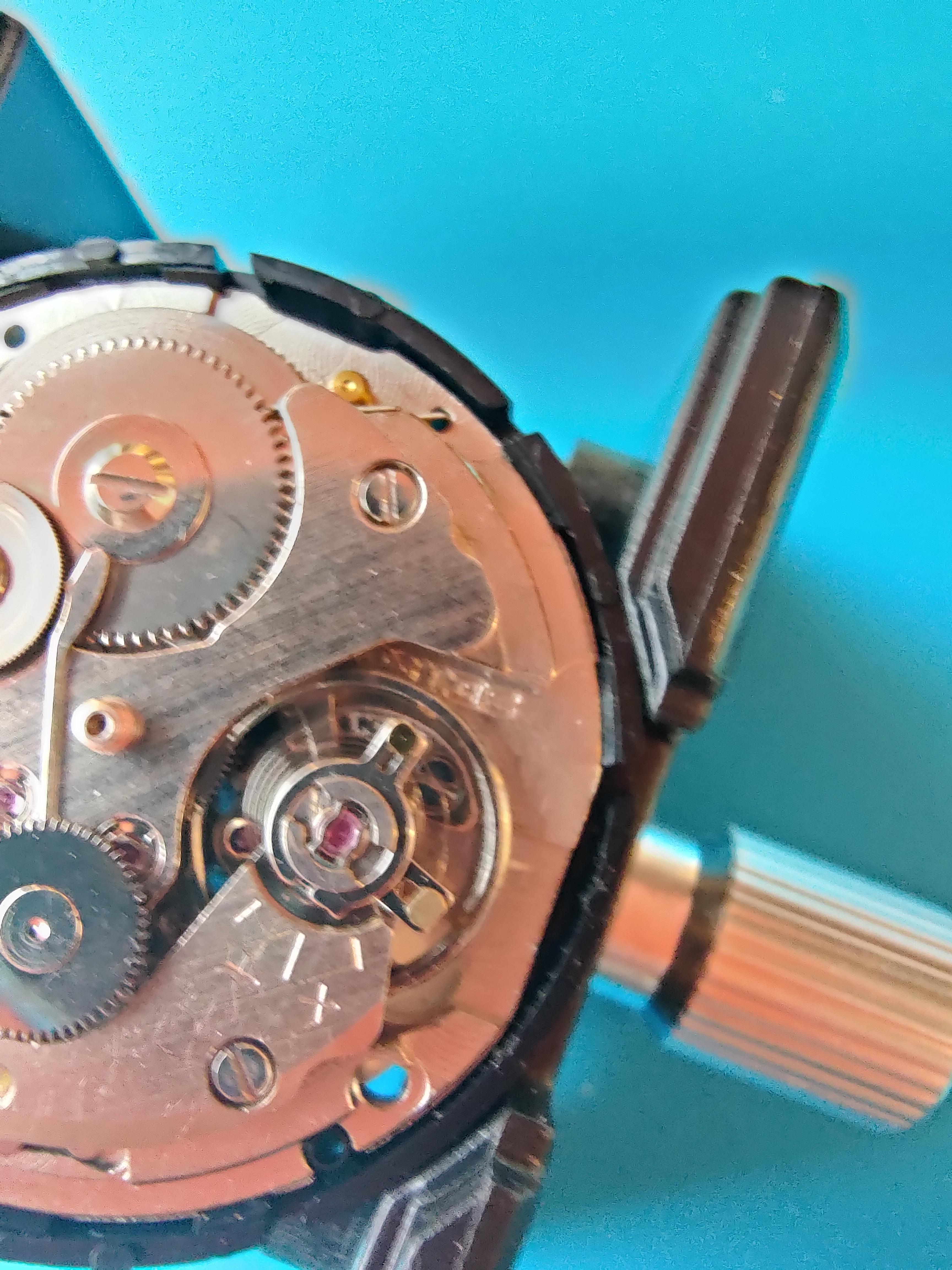

JDM is completely right. But honestly I think the hairspring would be a tall order even for an experienced watchmaker now... I'll be taking pictures today. Honestly to me this is really the hardest part of the whole watchmaker thing. Hairsprings are so delicate and my hands don't seem to be steady enough yet, especially my left hand. And as jdm said, I just learn from Mark's course. I wish I could learn this in person.

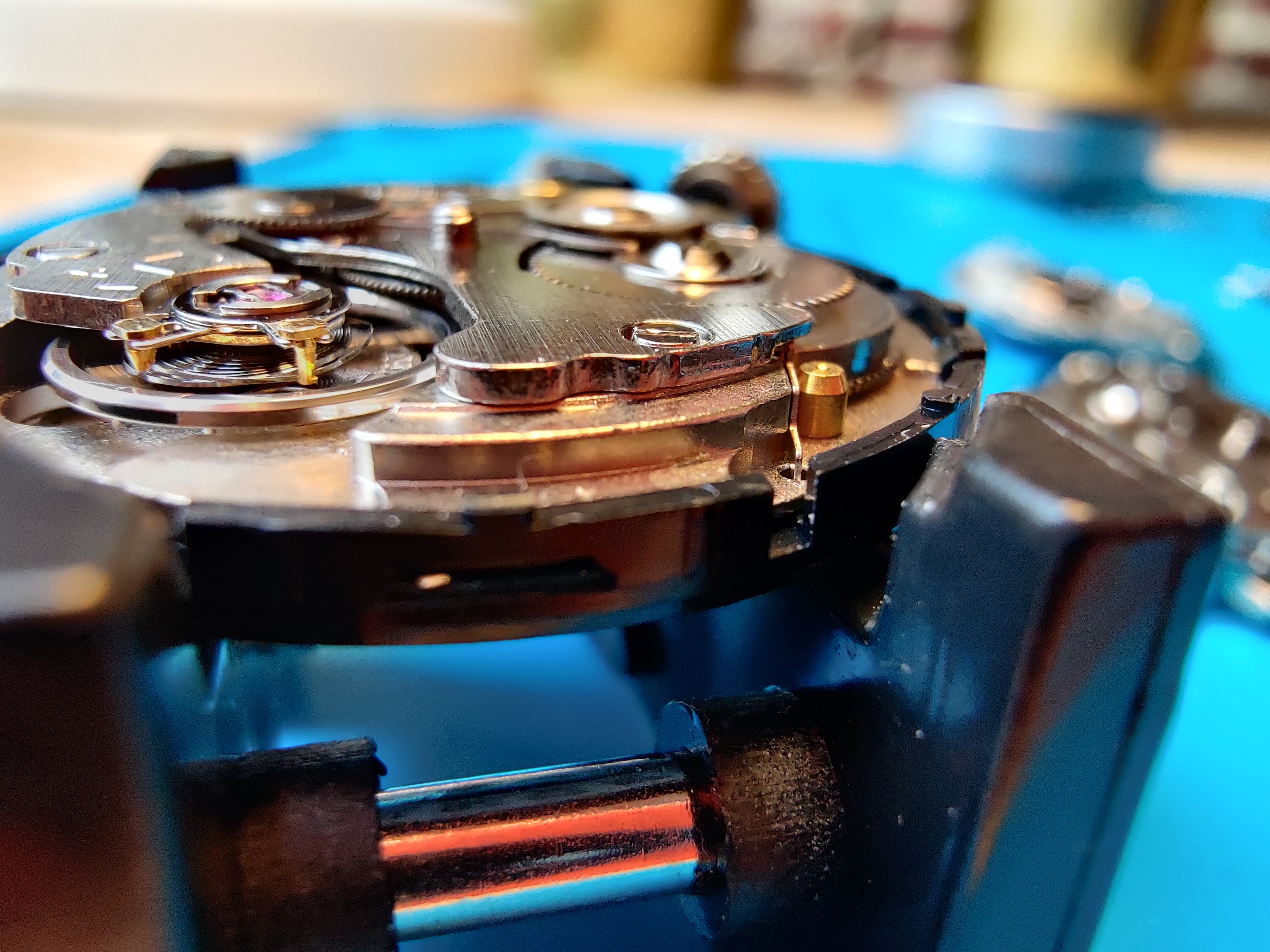

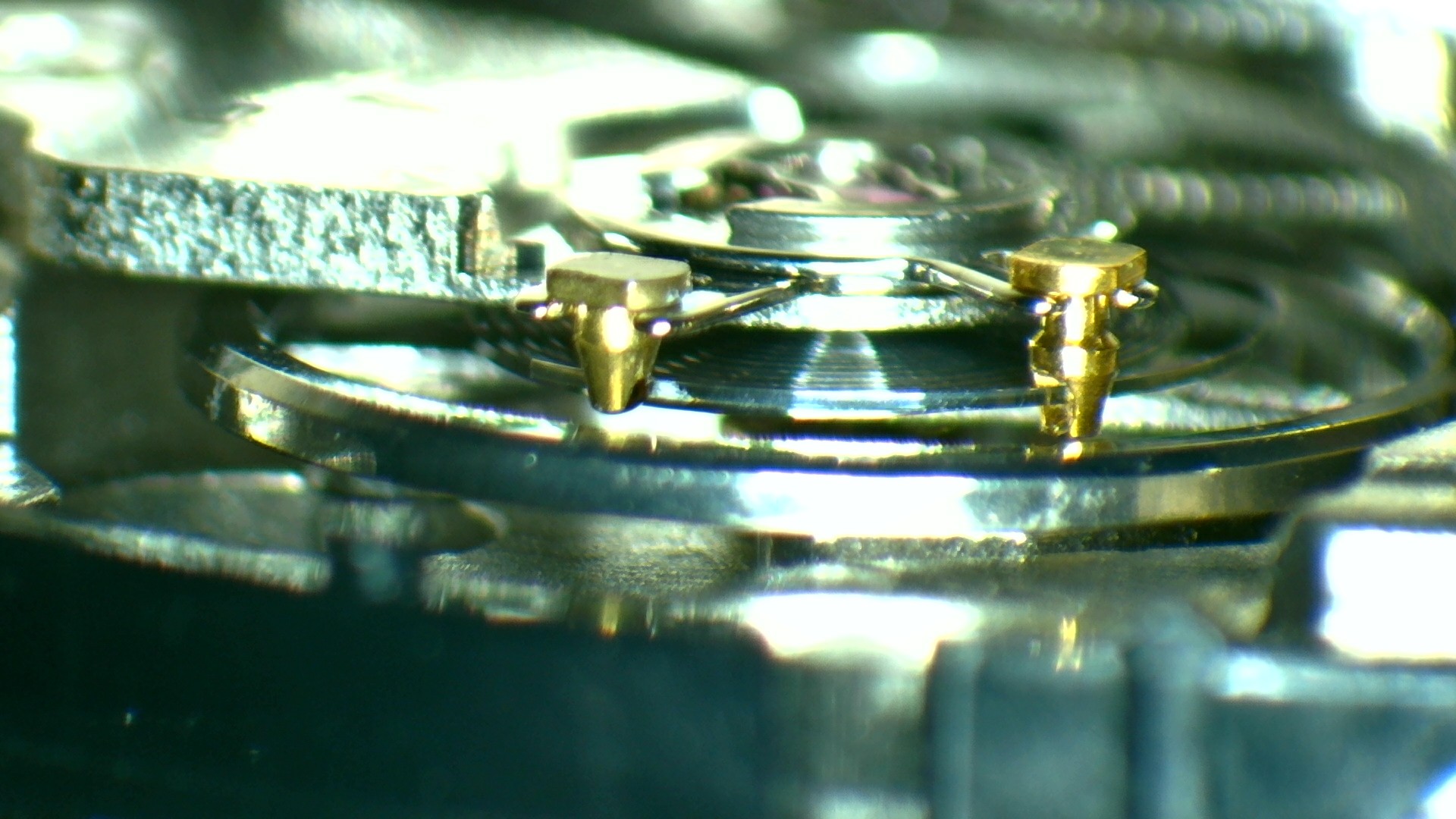

I was able to attach a different hairspring which I was able to get semi straight. However the amplitude is just awful.
Expand
To get acceptable amplitude on Seiko all parts (hairspring is not the only one) must be in very good shape. Unfortunately that is difficult to obtain for a beginner, you are not the first having this same identical problem. That being said the most likely cause is the hairspring rubbing somewhere. Because with the hairspring even just slightly distorted on the horizonal plane, as soon it gets compressed that kink will rise and touch under the cock, or on the wheel rims.
As @jdm says, it looks like it is rubbing on the balance arm - possibly near the red arrow.
The spring is sloping down from the stud to the regulator, and It looks like there is a kink just to the right of the regulator.
Trying to fix that is not easy for the beginner (by "not easy" , I mean VERY difficult for the beginner).  But if you are getting a new movement or balance, use it to practice on.
Fiddling with hairsprings is a fine art, which many (probably most) never become competent at. I've practiced and can sort out simple defects, but they still give me nightmares - especially trying to sort out overcoils ?
