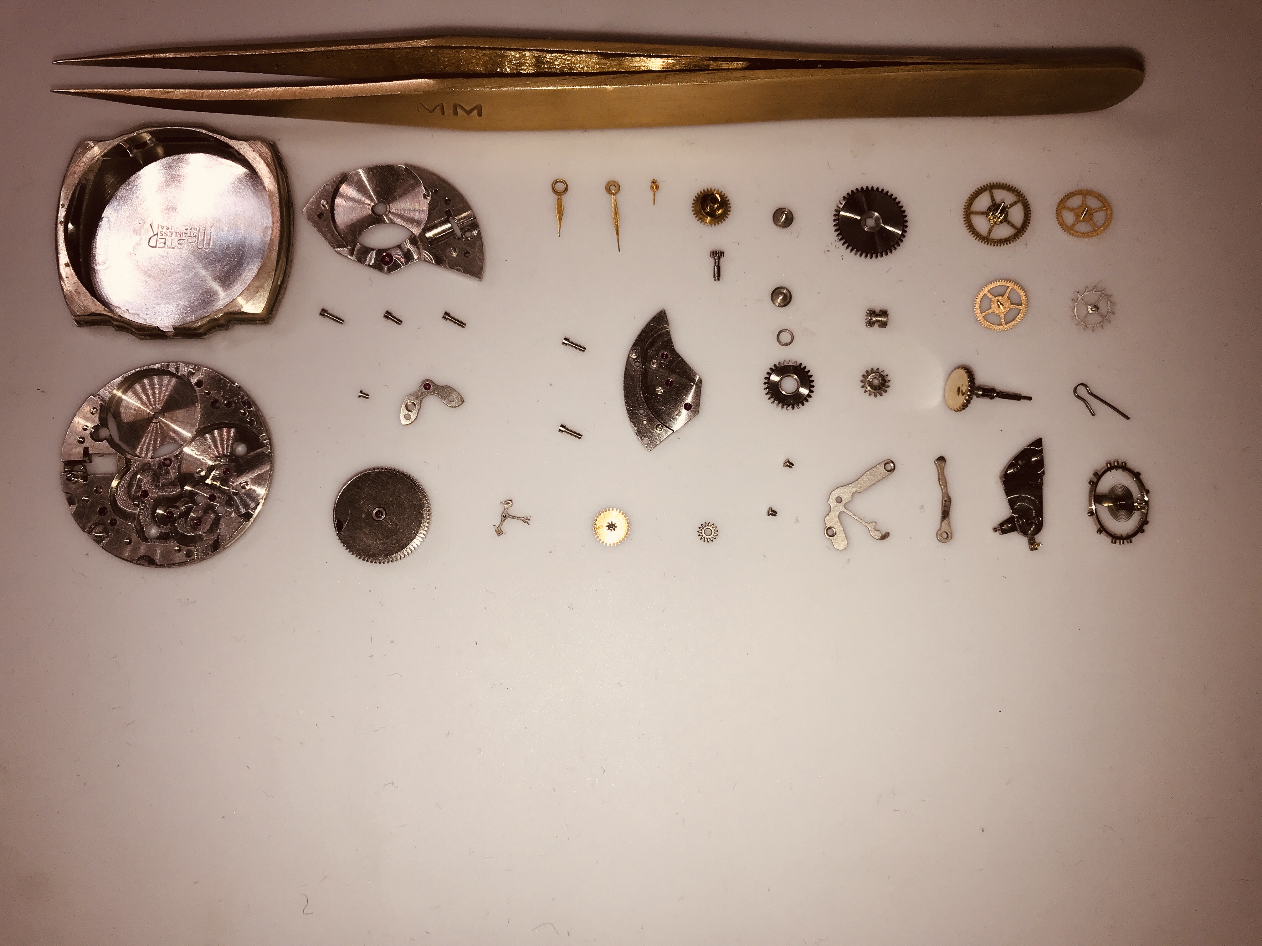

Was reassembling the Unitas 199 Movement I was working on, for the Solar vintage watch and I notice that the Third Wheel has no upper pivot. Can this be re-pivoted as it is very small, or should I try and source a NOS third wheel. Wheel 1 - Mainspring Barrel, Wheel 2 - Center Wheel, Wheel 3 - Broken Upper pivot.

It can definitely be repivoted*, the question is is it worth it? I don't know about the availability of components for this caliber but in general Unitas stuff is not too hard to find. I checked Jules Borel parts database and they don't have it, but that's just one source.
* I repivot a lot of stuff that is probably available cheaply just because I'm set up for it and it's a quick job in my shop. Something like this would be about 50 bucks to another professional, and they do or don't mark that up as they see fit (it's often a "rescue" job where they've broken the pivot, haha). For a tiny LeCoultre escape wheel with a 0.08mm pivot the price is quite different. That's why I say is it worth it- I would bet that part can be found for less than 50 bucks.

Checked Cousins but they do not have it either.
I think I can see the part with free post for about £7 on eBay.
I’m quite slow at re-pivoting, so would generally want to buy the part and spend the time saved doing something else.
Do you have the part number and a link? Save me some time:)
I’m sure you’ve checked, but it takes some force to break a 3rd wheel pivot - the jewel hopefully is ok.
