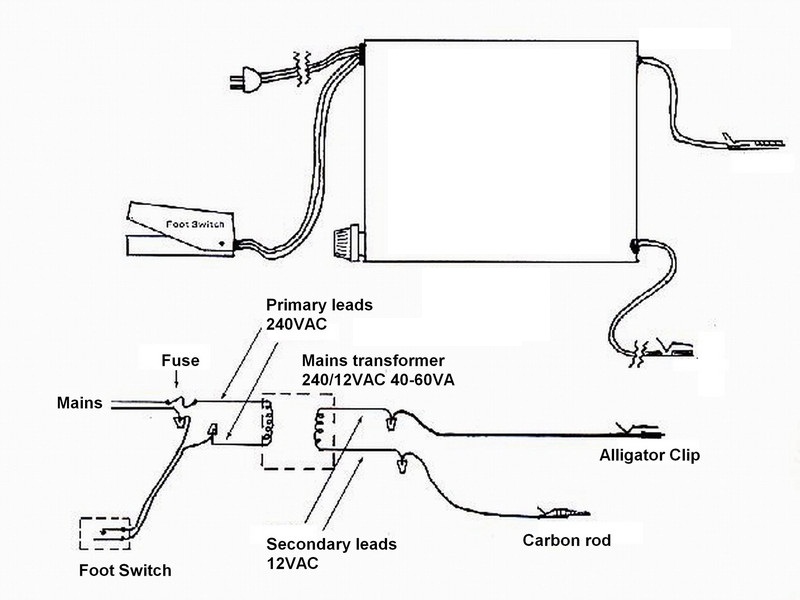

Hi  This is the machine I build it uses a 12v battery charger as a supply because it has an over current feature, Its quite simple also attached are examples of the solder joint and note the dial face is unmarked. So to do a quality job does not need a degree in  Neuclear science. Its just a simple adeptation of Dirk Fassbenders machins inspire by the one in Wesley R Doors book on Rettrofitting.  As mentioned before cost £25. and a few hours work.

Do you use a carbon rod to touch the copper wire when soldering?
Is the post where the dial is screwed down to connected to any of the power rails? i.e. Does current flow through the dial?
Hi Hector It is infact quite a simple yet effective design,  The power input through the two jacks at the back left +ve and -ve. The posative has an in line fuse and is connected to the jack (red) on the right into which plugs the carbon rod(salvaged from batteries) . The Negative connects to the post and table where the dial is fitted via a switch and a power indicator is fitted across the out puts.  So when the dial is on the plate and screwed down the dial wire is positioned in the top rail onto the dial with flux and a solder chip  the carbon rob is applied and the power swiched on.  The rod completes the circuit and an arc forms at the joint melting the solder.  It takes a little practice in determining the length of the power application.   If I can find the origional design I will post it.

Hi Hector The method as I use it is that the post or clip which holds the dial is one half of the circuit and the carbon rod is the other half. So when the dial is set up you can protect the face from the crocclip teeth on the dial face, the other side of the clip contacts the surface of the dial.  The dial foot wire is prepared and held in contact with the dial, a lillte flux and solder chips or solder paste placed at the contact point,  then the carbon rod is introduced to the wire. The current flows down the wire creating an arc at the contact point and makes the joint, similar to arc welding. The knack is to watch the joint and as soon as the solder flows remove the rod and switch off the current, and the power.  The dial face will be unmarked and a good joint obtained. As per my previous post. The dial foot wire is the interface between the posative and negative contacts and can be held in place with whatever method you choose.  Some use a third hand to hold the wire in place others make a jig but the end result is the same.  Whether you use damp chamois or dry matters not as long as the dial face is protected from the crocadile clip teeth.   Hope this is clear enough If not I will try to take a set of pictures at each stage of the proceedings.           cheers
Yes, exactly. That's why I found it strange that in the video, there was no electrical connection to the crocodile clip. If you observe in the video, the wire was connected to the brass block where the dial is supposed to be screwed down. The electrical circuit was only completed when Mark pressed the dial foot wire firmly on the dial. I don't know if the machine was designed that way or the connecting wire had fallen off.
