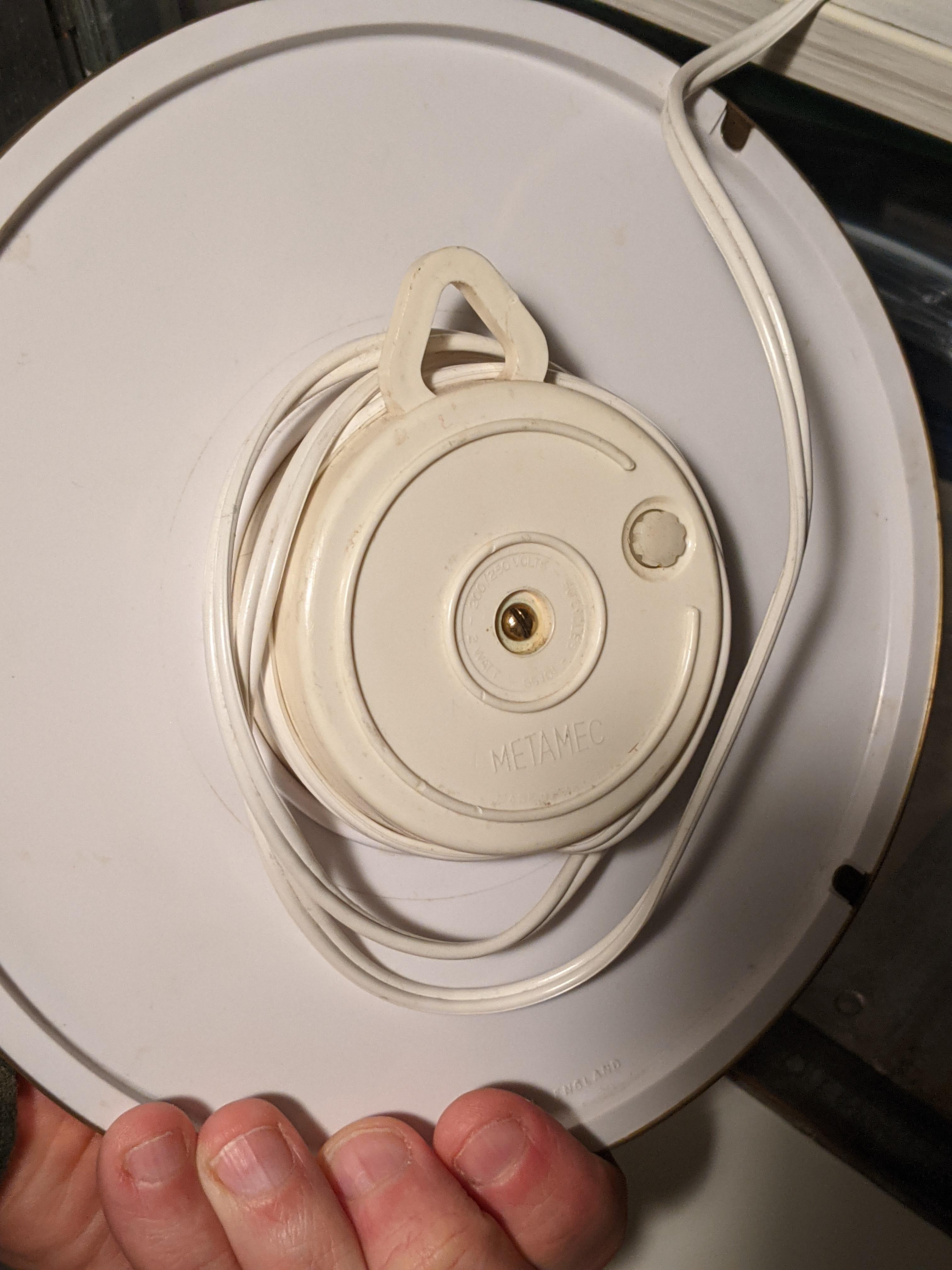

Nice to see a Metamec here ?
I've got a couple of dozen Metamecs of various types, many mains synchronous, but also quartz and clockwork. My Metamec habit pre-dates my interest in watches by about 15 years!, even have a book about them somewhere. Many rooms in my house have a Metamec. I have a fair few wooden ones, but I like the 'mid century' plastic and metal best. Selection shown here (including a crazy 'eye' clock with built in lamp), most would fit the '404 club' rules (having been bought very cheaply 15-20 years ago).
Mains synchronous is a clever method, basically, you allow the power generator to keep the time for you ? (they are required to keep the average at 50Hz in the UK, there can be a little drift depending on demand, but they put it right again later in the day if that is the case) there is little to go wrong with the movements (most you pick up will still work) and the clock will stay super accurate (especially compared to clockwork or pre quartz battery movements) Easily within 60s/year. Also, they are very quiet, and you get a super smooth sweeping second hand as the movement doesn't 'tick'.
British houses in the 50's and 60's often had outlets for them high on the wall (about 1.5" square) which would be hidden behind the clock. This went out of fashion as clocks became cheaper and quartz came on the scene. The technology still works just fine and for a 'sideboard clock' is still useable, but for wall clocks you end up with an ugly trailing wire from a normal socket. Which isn't so good!
For a few years I have been modding the mains synchronous wall clocks to use generic £3/£4 chinese quartz movements to get them back into use, the ones I use are smooth sweeping despite being quartz to keep the original look as best I can. The spindles are not compatible with the old hands though, so I select hour/minute hands that match the originals as well as possible, the original second hand can be reused by replacing the tubes with one from a new hand.

Found my book, yours looks to be a '946' made from September 67 - August 83, for the wooden clocks, the number stamped into the base, is sometimes, (but often not) the model number. Interesting the photo from the catalogue shot in £ s d shows that the mains synchronous ones were way cheaper than the clockwork ones when new.
Thanks for the info. I wonder if the '60' stamped on the base might then be the model number for a slightly different version of the 946. The style of bakelite case used on the mechanism of one I have is very reminiscent of 1950s and early 1960s electrical items.
Typically off white urea formaldehyde and epoxy resin fabricated items had replaced most of the brown bakelite ones by the early seventies, however I guess since the model looks to have been introduced in 1967, they were still using brown bakelite even then.
Its not that brown was the only colour for bakelite, but it was presumably the cheapest, and the dull brown stuff was used extensively for electrical items like plugs and switches. Anybody who encountered Bayko Toy construction sets will know that you could get bakelite in a wide variety of colours
Yes, datewise, I was puzzled by the fact yours had an older bakelite cover version of the movement too, you are quite right, I thought they were using plastic covers on a more compact movement revision (like the one in my picture of the wall clock) by the mid sixties, so maybe yours isn't a '946' as described but a preceding variant, I don't think it can be just '60' though as so far as I can tell, they never used 2 digit model numbers at any point, they were always at least 3. I think the stamped 60 is more likely to be the number for the 'pattern' of the wooden case parts. Another possibility is that the book could be wrong on start date for the 946... the data I think is compiled from loads of annotated sheets saved from the factory, but this often relied on cross referencing descriptions to pictures that weren't directly linked, and I think the running dates for models is just done by seeing when they appear/disappear on the sales sheets. I have found mistakes or irregularities before! (and clocks that don't seem to be in the reference at all). I have (or at least had!) one the same as yours, I found its picture and entry in my spreadsheet! My Picture is from January 2004, it might be in the attic... possibly... or maybe I moved it on, but mine was clockwork (so a '6' 946)
Actually, scratch that comment, looking at your picture again, that IS the 2nd gen movement started in the mid 60s, so that would be consistent with those model dates, they made them with brown and ivory bakelite plastic covers (and later in coloured plastics). The earlier movements were even more 'bakelitey' if you see what I mean, many of those had the option to have an artificial tick too! (that is the one function that often doesn't work though)
With the 1st gen movements, you had to 'start' them by hand (just turn a small knob) after plugging in, the 2nd gen like you have there will self start as soon as power is connected
