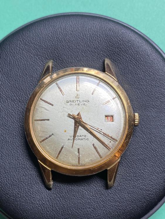

My daughter's friend ask me if I could help fixing his watch, a vintage Breitling Unidate...
I accepted the challenge and took the watch:

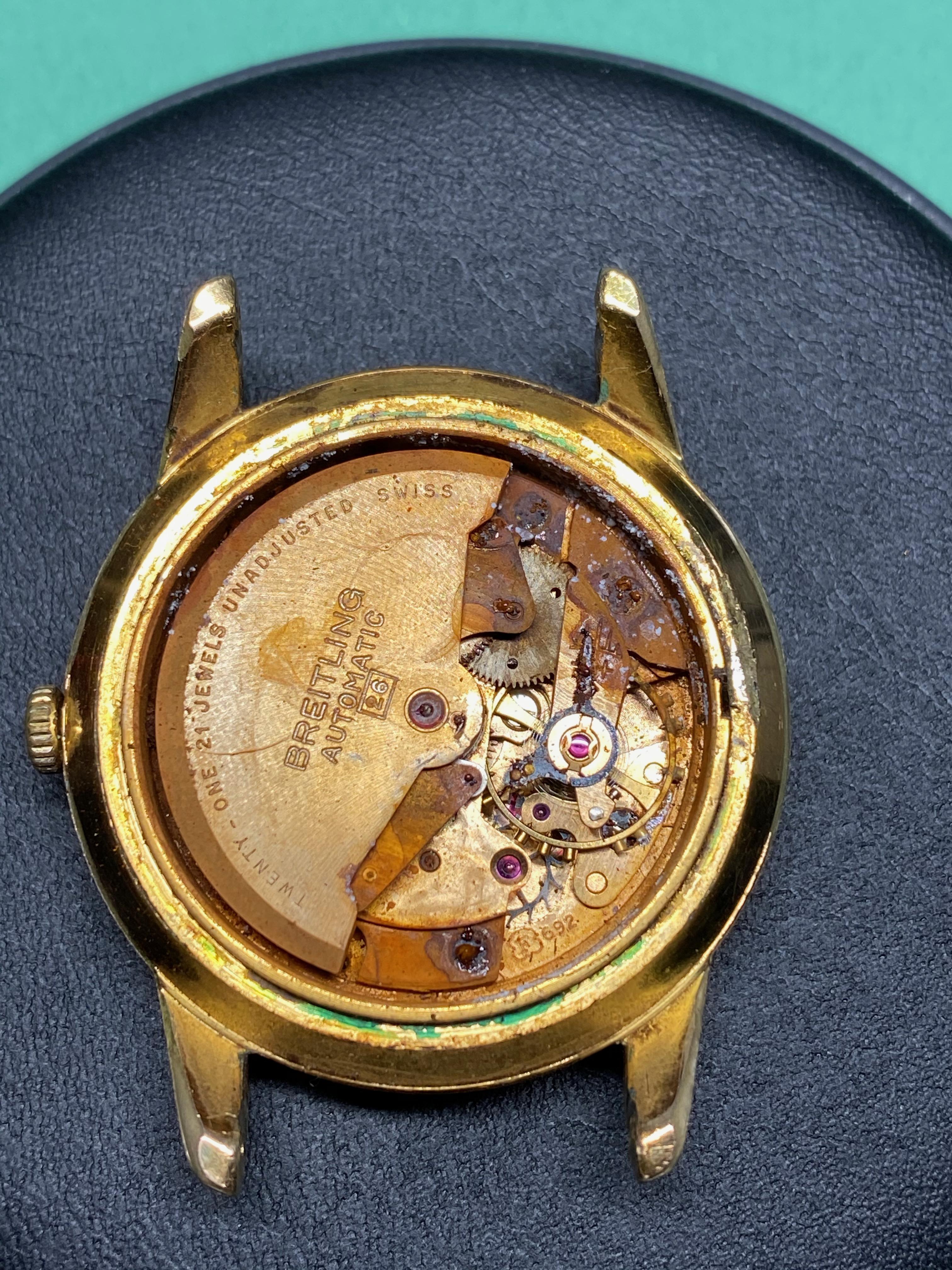

After great efforts, I could finally remove the case back...
The movement is in really bad condition - tried to clean it a bit but gave up given the poor condition
I found a NOS Felsa 692 movement, which seems to be identical to ther Breitling, so my plan was to recover the dial and replace the movement in order to get a working watch ...
Problem: the screws that fix the dial feet are completely rusty and impossible to unscrew them to liberate the dial:
Close-up of one screw:
What would you guys recommend ? I'm ok with cutting the feet and soldier new feet to the dial but don't even have a clue on how to do that or where to start ...  :(

Would it be possible to get a thin blade between the dial and movement to "saw" thru the dial feet?  Maybe even a jeweler's saw blade.  Alternatively, judging for the amount of rust, perhaps gently lever on the dial at the feet might just snap them right off.  High risk, but not many alternatives that I can see.  Drilling the dial screws out may not do any good given the amount of rust.

I would try and remove and salvage as much as possible from the movement side first, then let what cannot be removed sit for a few days in a shallow dish of rust remover, with the fluid level just below the edge of the dial. Then see if you can gently pry the dial away. Who knows, you might be lucky and not have to get medieval on it's ass. If that doesn't work, I'd try to drill the screws out with the aim of leaving the feet intact, maybe again in combination with rust remover.

Remove parts until you see the bottom of dial feet, apply heat to it only( solder gun) the apply penetrating oil let soak over night, next you alternatively tap on the bottom of each foot, if that didn't work, nothing will and you got to amputate the guy.
If you already got a replacement movement, why just not carefully drill those rusty screws away ?
Drilling carefully and a small bit at the time would get the dial off without harming it.

If that were my movement, then I'd sit the movent dial-up in enough acid to reach into the dial screws and dissolve them entirely. You would need to make sure the acid never reached the front of the dial.
If the base plate of the movement will be discarded afterwards then you can do whatever you like to release the dial.. a dremel springs to mind - you could try to drill out the screws, but realistically you could drill carefully around them, anywhere you like, as long as the dial is protected.. brass vs rusted steel, not that tough to cut through but the cutter may grab on the rusty steel as you go between rust and flakes of intact steel within it.

Unfortunately not, as the dial is curved at the edges and "recovers"  the movement not leaving any space for such intervention
Same problem, if the fluid is below the edge of the dial I'm not sure there will be enough contact with the screws ... maybe I'll proceed this way after trying another method.
I will try this method first - I think the advantage is also that, if I can get to see the bottom of the feet it will also facilitate the other method of drilling "over" the crews.

Thank you but like I said before the dial is quite curved at the edge making it impossible to get the acid to reach the screws without risking to damage the dial ...
