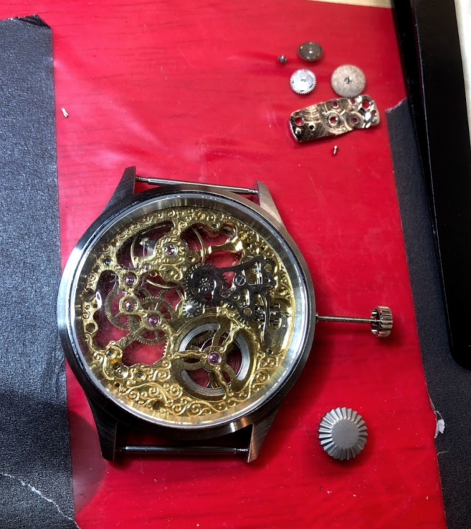

I am newer to watch repair but very experienced with mechanics and I have a well suited workshop.  I am doing a restoration on an old pierce and my 14 year old daughter took interest in the project.  So I started a project with her, building a watch from new ebay parts.  We selected a simple movement (17 jewel #6497) that we took apart and put back together.  She enjoyed it.  So I am collecting the parts needed to make it into a watch she can wear.  I purchased a case that is designed to fit this movement.  It did come with a face ring and a movement holder.  But I think I need something else.  When I assemble it the movement is up against the glass.
How should I space it off the glass correctly?
Am I missing parts?

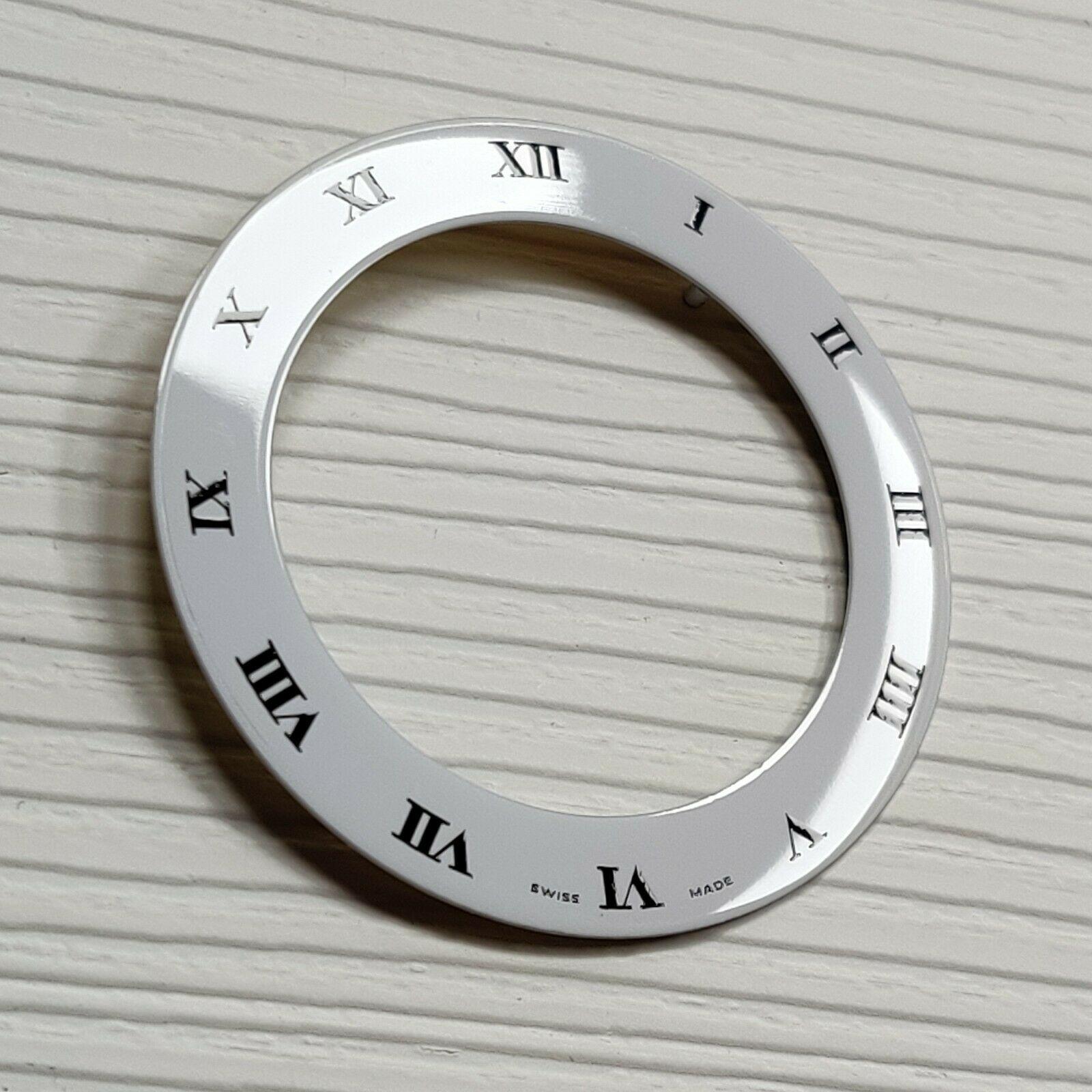

Is that small thin ring going in place of the dial or is it a gasket for the back case to press against the movement holder and let it turn as it presses.
Movement "Golden hollow 6497" here
Case is here
It's a throttle twin-body adapter...
No, seriously... it's the "dial in-lieu" spacer. Check that the stem is well centered in the tube? That is your cue regarding how high the mov't should sit. And if if doesn't you'll have to fabricate something.

Also check if you need to fit mov't tabs and screws, because the ring may be well pressed in but the mov't could still move especially when winding and setting.
So you don't think there is any standard spacer that could be found?  It will be visible so I would like it to be not "home made" (not by my hands).
Is that small thin ring for up at the crystal, similar to the spacing a dial would make?
So basically what I am looking for is a thicker version of the "dial in lieu" spacer or maybe a bunch to create the correct thickness.  Where could those be found?
As mentioned above you will have to fabricate yourself, since these are not standard parts.

I built a custom watch using nearly identical parts but my problem was different. My dial wasn't meant for wristwatches and was significantly thicker. The case back wouldn't close all the way.  I had to remove tons of material from the overall thickness of the spacer ring.
If the watch fits the case,and the stem lines  up  it may  be something  as easy as crystal  replacement .I suspect  you have a flat  mineral  glass  crystal, is that  correct? If so you  could  replace it with domed acrylic. This would give  you hand clearance.there as pros and cons  to both  types but since you already  have all the other  parts. This might be a practical  way to go.
This is a high dome.this type is used with older mechanicals. There are low  domes  as well. You might have to experiment  a bit  to get the right height to clear  the hands without going  too high.If you can get  those downdrafts  working  you can do  this.

The wire idea may be a great way to go.  I have a huge hand press (for car restoration stuff).  I could figure out the exact thickness I need and press a nice brass wire to the correct thickness.  I do also have access to lathes (and I have some basic experience) if I have to go that route.
The thick brass movement holder has slots that are bent up on it.  What are those for?  Should they go towards the case back and then do they compress a bit like a spring/crush washer to create compression?

Is it me or do i see some carbs on that bench. Those cases should come with tabs to space it correctly. Iam guessing the kit didn’t come with any? It does look like the movement ring is made to accommodate a tension wire ring which will not help you here. One thing you can do that will be easier than pressing a wire in the case would be to swap out the crystal to higher domed crystal. Did the case come with a sapphire glass or mineral?
yeah I'm a big car guy.  That's a whole side of a Porsche 911 on the wall above it.
The watch wasn't a kit.  I'm purchasing parts, which is why this finagling is needed. I purchase a sapphire crystal in this case.  I could purchase a domed one.  How are Crystals replaced.  I do have a case press.  Is it simply pressing the old one out and then pressing in a new one with either an adhesive or gasket?

Crystal glue is commonly called cement and was used before nylon gaskets became ubiquitous, so today the latter is used as much is possible.
And the mov't ring should be tight in the case, typical parts saving technique is to use plastic or springy tabs as above.
Acrylic domed crystals  are installed  with a crystal  lift, they are compressed  before inserting..the compression  is then released  and they expand  into place.nice tight fit ,no gaskets. As for removing the old crystals  you were born with two removal  tools. They are attached  to the side of your hands.

I successfully made a shim from a piece of wire and the movement is centered.  It came out great.  Next is cutting the stem to the correct length and attaching the crown.  Tips?
Glad to know my suggestion worked. Cutting a stem (non screw crown) is real easy.
