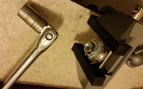

Here is a little walk through of how I, following Geo's and Micky's advise, was able to remove the stubborn back of 2 different watches, a Seiko Kinetics with exhibition back and an Orient Auto.
At this moment, the backs have been immersed in 100% acetone. I have a feeling I shouldn't have used epoxy but after literarily destroying 2 compact, made in Switzerland, back openers and one set of pins from my brand new jaxa I was taking any chances. Notice the Automotive grade tools used to force the watches open. Worst case scenario, backs can be sourced! (The salesman said this epoxy was soluble in Acetone....).
Notice also that the exhibition back -- Seiko Kinetic -- needed a nut large enough to clear the crystal an hold on the outer metal ring.
In any case, we'll come back for a final view of the backs after the acetone works....if it does...

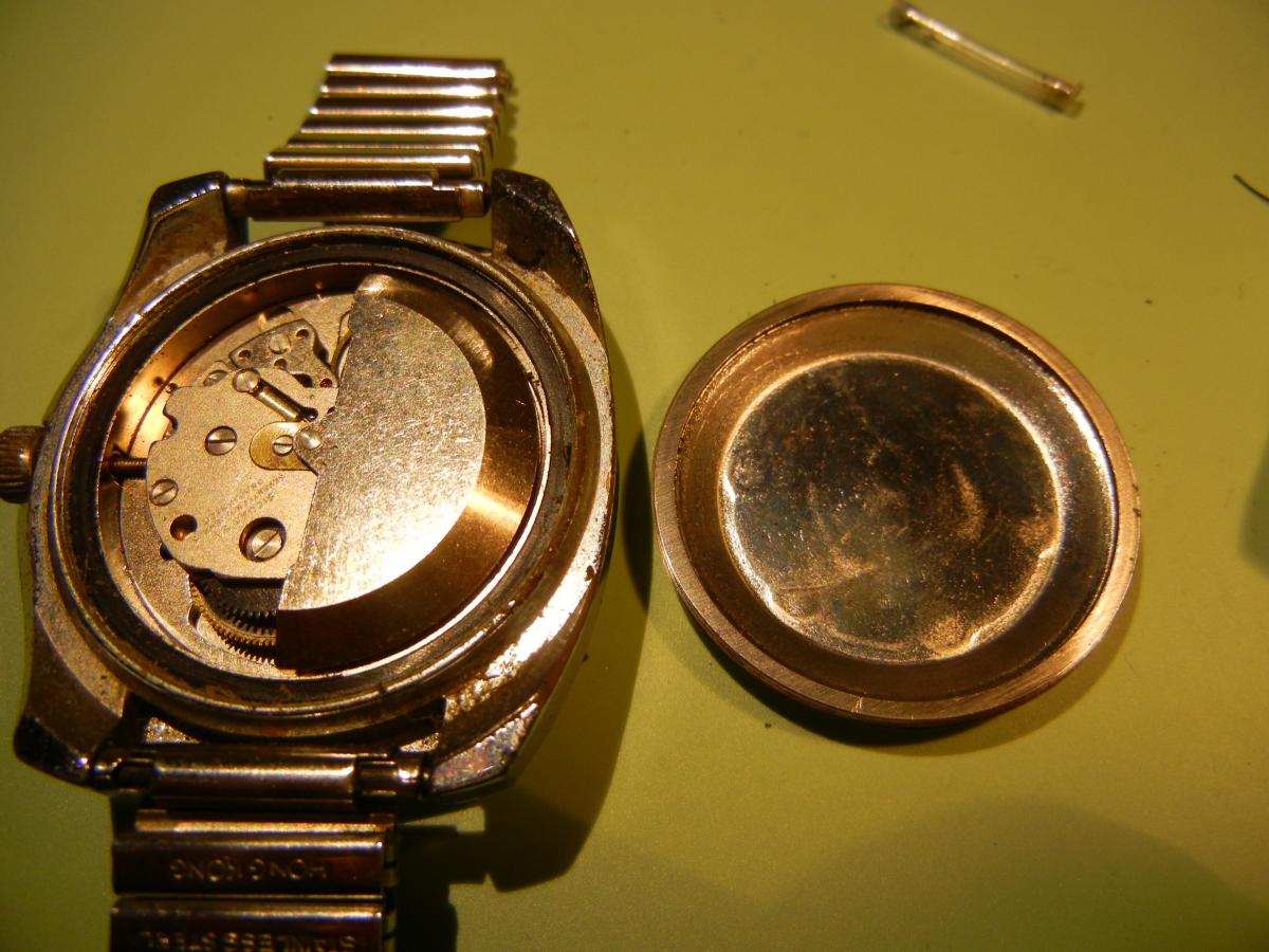

As an interesting note, some of the epoxy remnants on the cases scraped off fine with a back opening knife, no marks left. The stuff I used is really tough, it is supposed to be sandable after it cures leaving a gray surface as you can see in the picture. I also said on the label that it is not supposed to be used in surfaces to be under water so if the acetone doesn't work, I'll see what water does...only problem is the metal may corrode if left too long. So far, the backs screw back on so if the nuts come off there shouldn't be any more complications to restore these watches. All parts seem to be OK and the coils checked good in the Kinetic.

What is wrong with the watches that caused them to seize up like that? Rust?
I think generally it is a case of over tightening and the seal sticking when they start to deteriorate , they can go like tar when they start to break down
I agree with Andy, also I believe the watches were at some point "exposed" to salt water and not rinsed properly, add to that sweat and overall disregard with possible storage and you have a recipe for disaster. Luckily, I didn't strip any thread and I'm just dealing with the glue. The movement inside is pretty well preserved. Notice the brown dust in one of the pictures. It came from the thread/inside of the watch.
So at the end I figured I could wait a couple more days until the acetone penetrated all the way but being the restless and impatient guy I am, I chose a short cut....
I scratched all the epoxy from outside with a back opening knife and then I used a bezel tool to "pry" under the nut and once it grabbed the back of the watch firmly, I used the hammer.
One hit was enough to detach the nuts. The epoxy will come of either with more acetone or with the knife. I chose acetone since I'm in no hurry at this time. Caution should be had with the exhibition back since it can break...I believe I was lucky with it this time.
