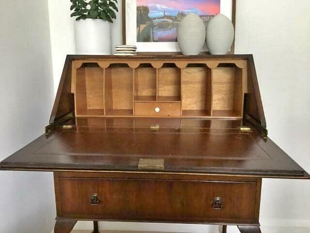

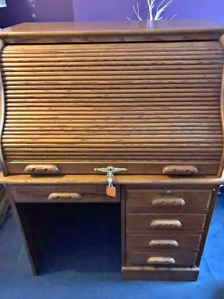

Would a bureau desk work as a clock/watchmaker desk? Not high enough (could be solved) or stable enough? I could fetch one of these from facebook around 30-40 pounds.
I like the idea because it would be more or less child and dustproof as you can close and lock the whole thing.

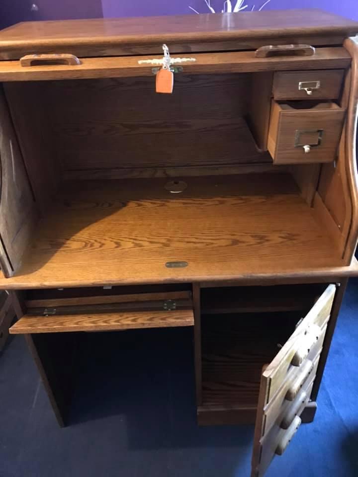

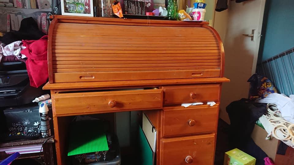

As OH says, comfort is of paramount importance, so leg room and bench height are key.
Other than that I would go for the roll top type rather than the hinged down type as you will have to clear the work area of the hinge down type before you can close it. Also the sides of the roll top desk double as a catch net for fliers.

Hi   All advise given is wise and should be noted, also consider lightening the inside of any desk/work place so as to give good reflection of light. My workbench is covered in white lino tile, a pale green as per the bergeon mats etc.  as Marc says the roll top is probably the best option.
