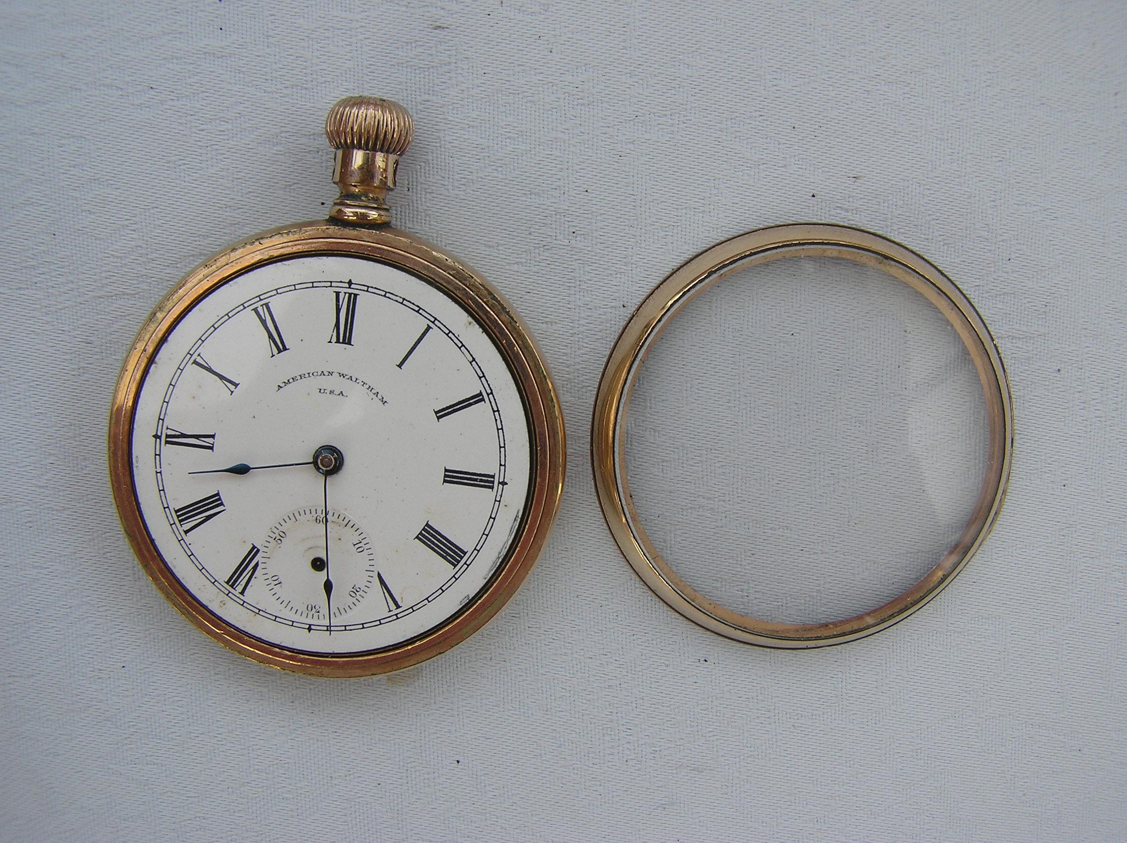

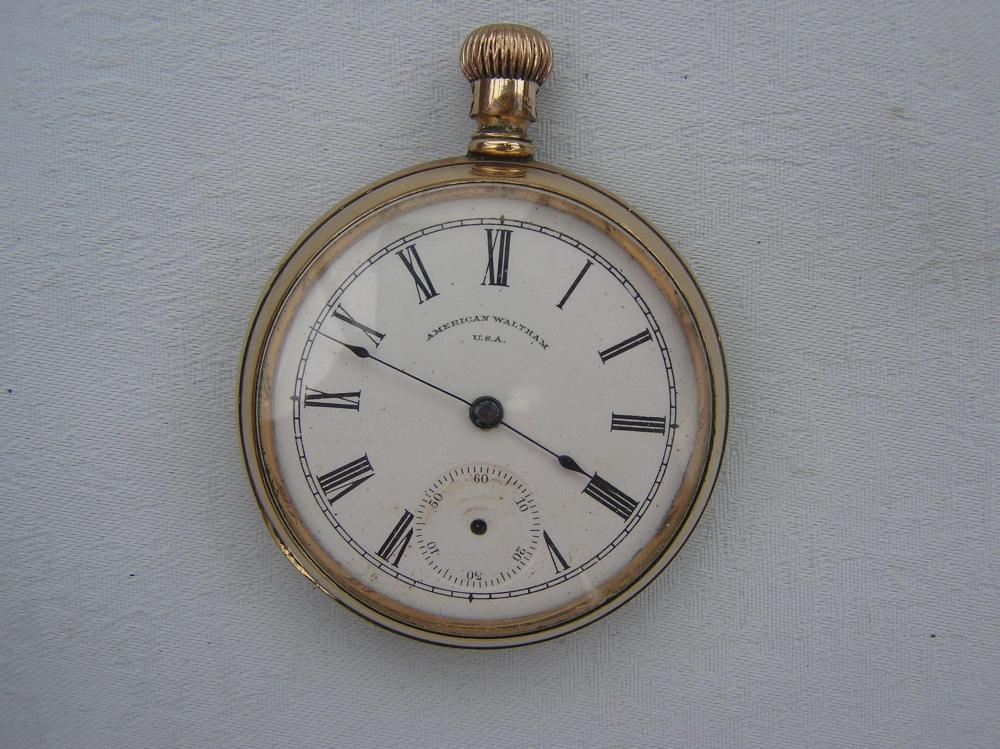

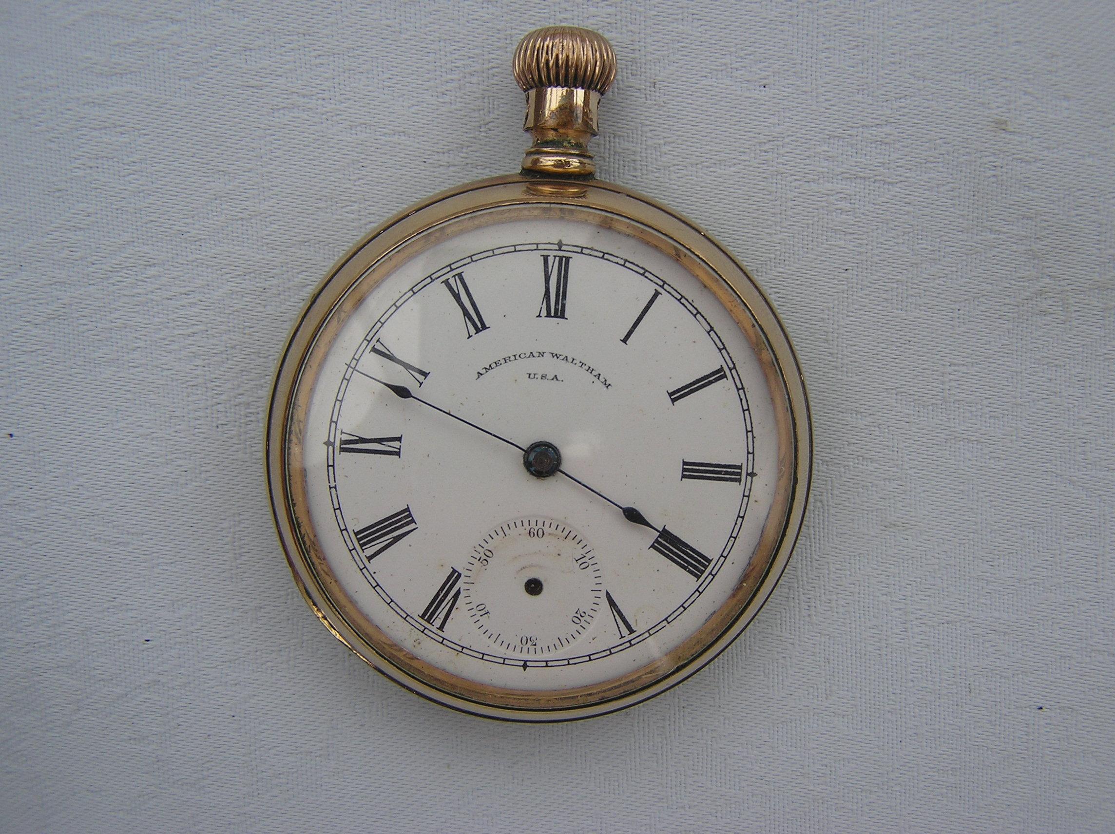

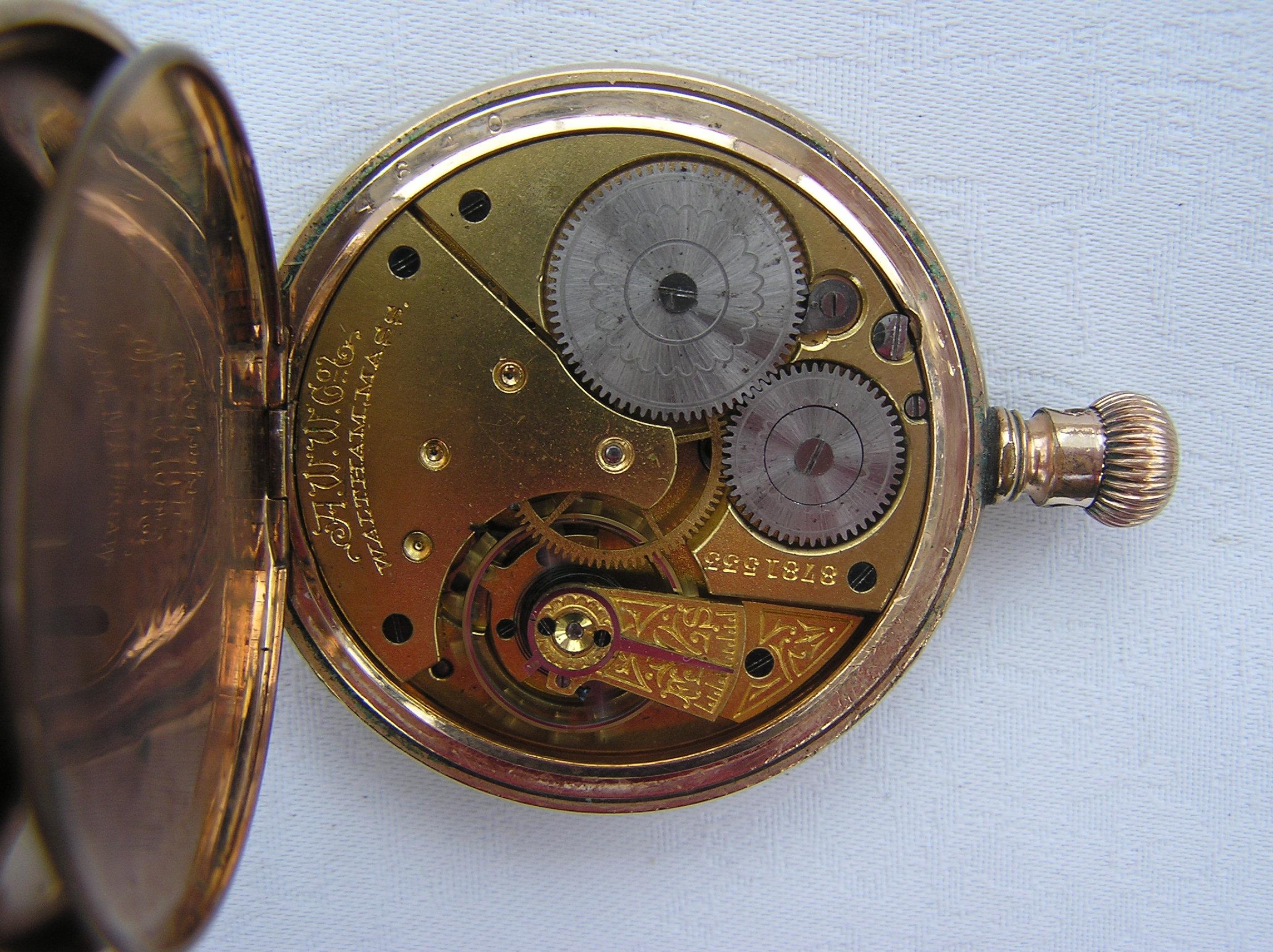

I have a Waltham pocket watch which i purchased wjth some other bits and pieces. Runs well but has one problem I can't alter the hands. Its definately a pendant set watch but the crown will not pull out. It will come right out if I loosen the screw and pull. Before I pull it all apart could someone perhaps tell me what I'm looking for with regard to the keyless works. Must  be lots of Waltham fans out there
open the front face, on the upper right side of the dial there should be this little lever sticking out from behind the dial, you cant miss it because it will be steel not gilt(gold) colored. it will be flush with the edge of the movement. you have to slide that back in order to set the time with the crown, then slide it back in when done to re-engage winding function.

No it wont go in any further so looks like a dismantle job. Never worked on one of these before...Would that be dial and hands off?
I took a look in the pocket watch database and it looks like this one does not have a pin lever setting so you just have to pop it out and fix the key less.
Sometimes when I am little bit unsure I use this site to look up the movement.
https://pocketwatchdatabase.com/search/result/waltham/8781555
Hope it helps..

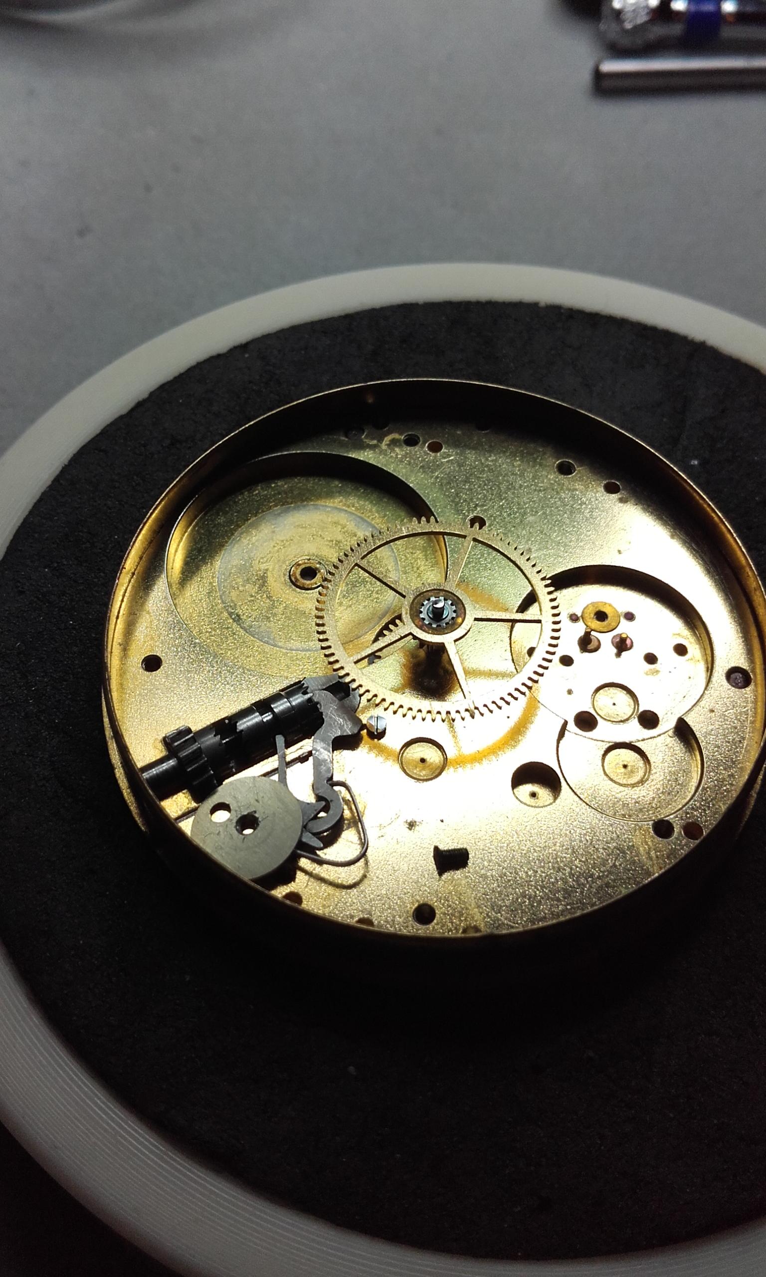

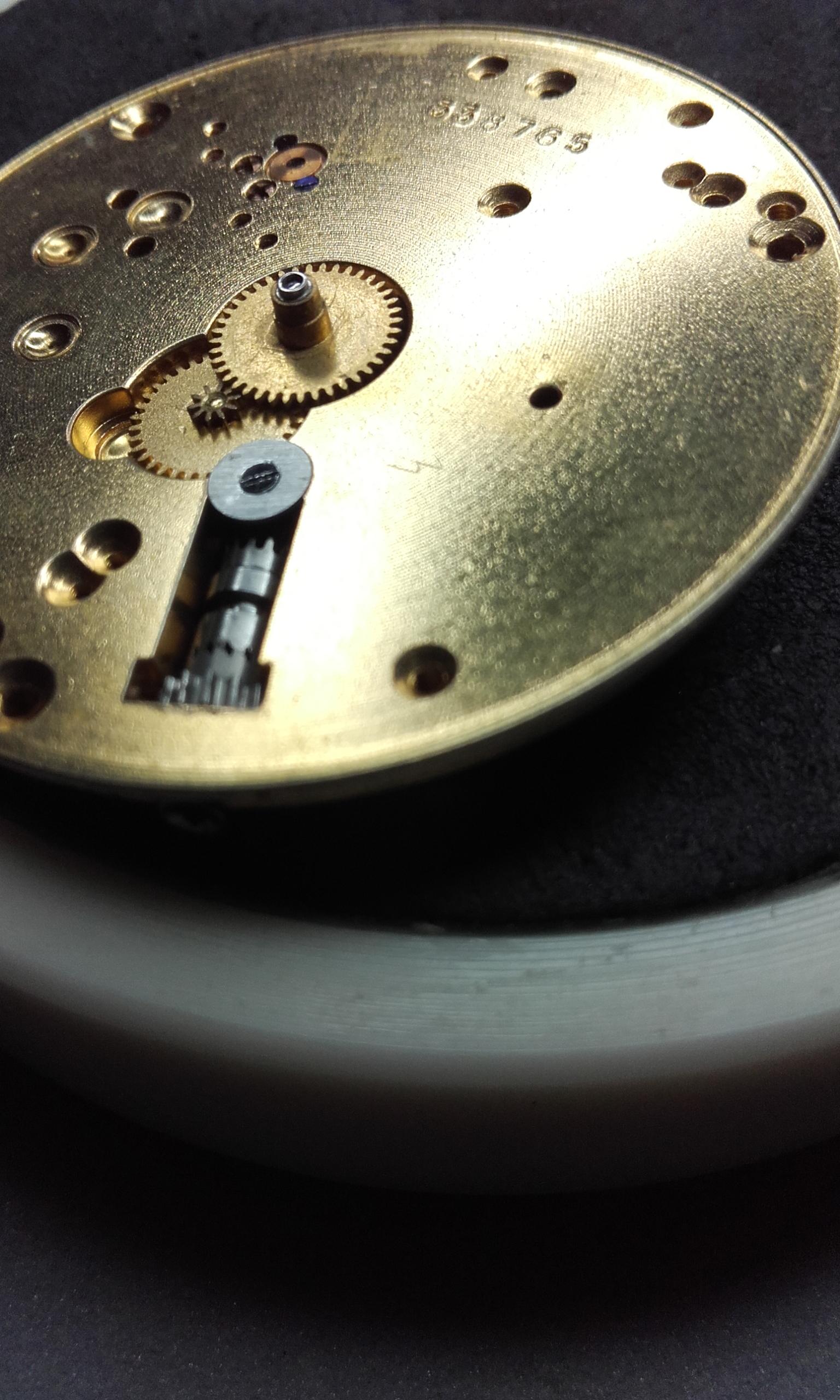

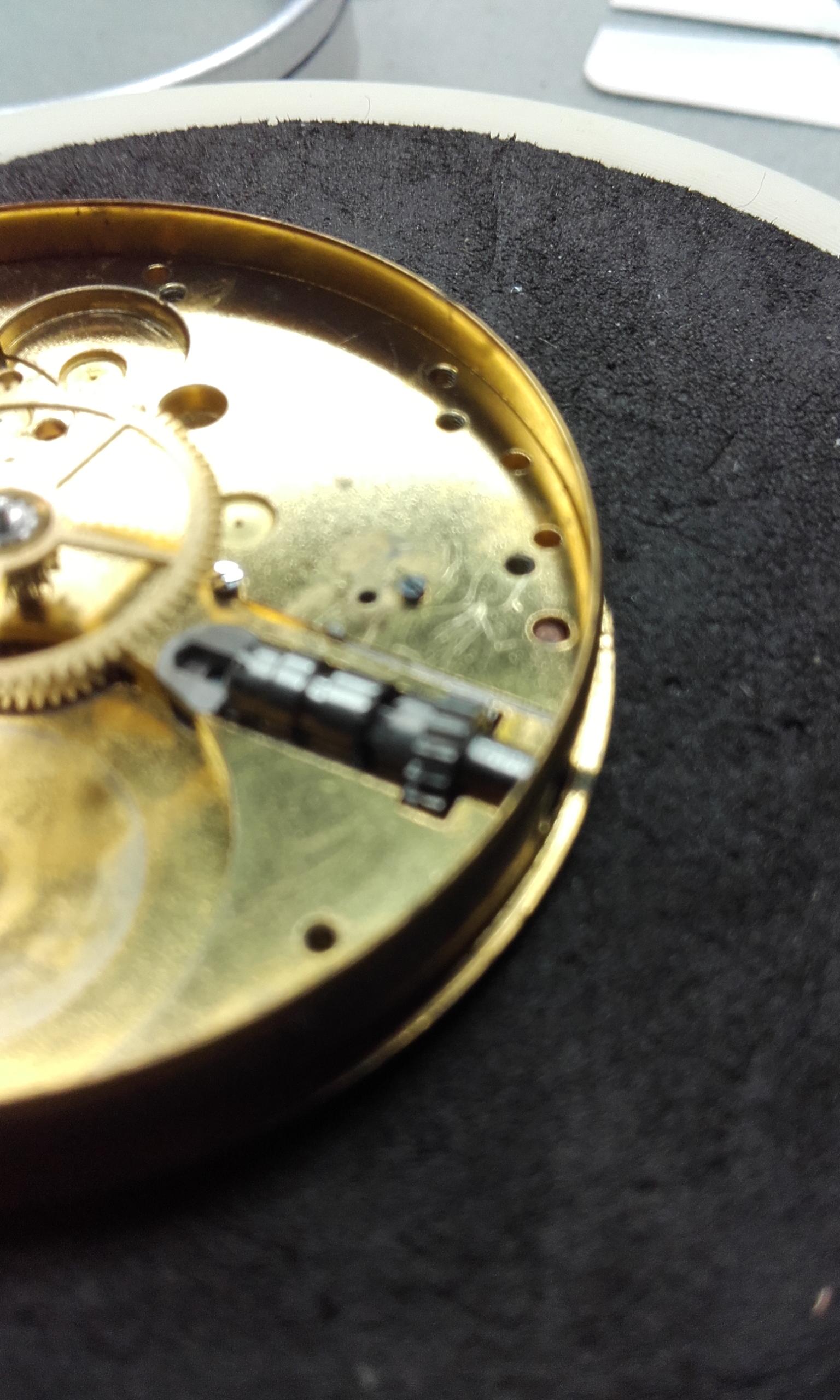

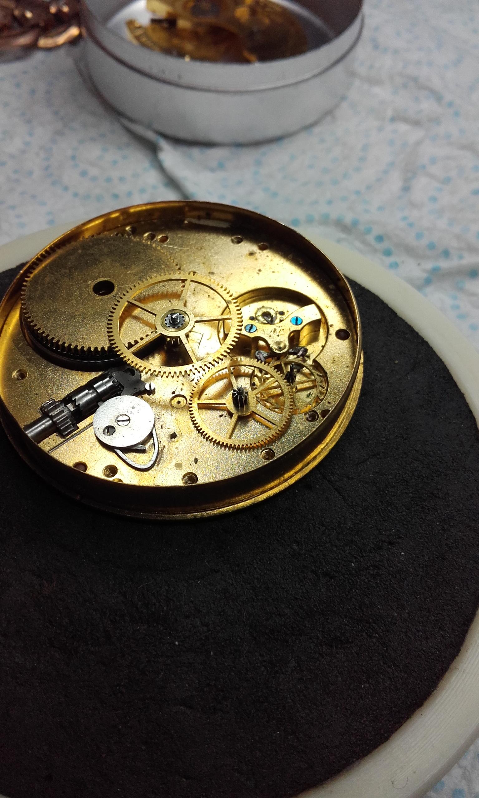

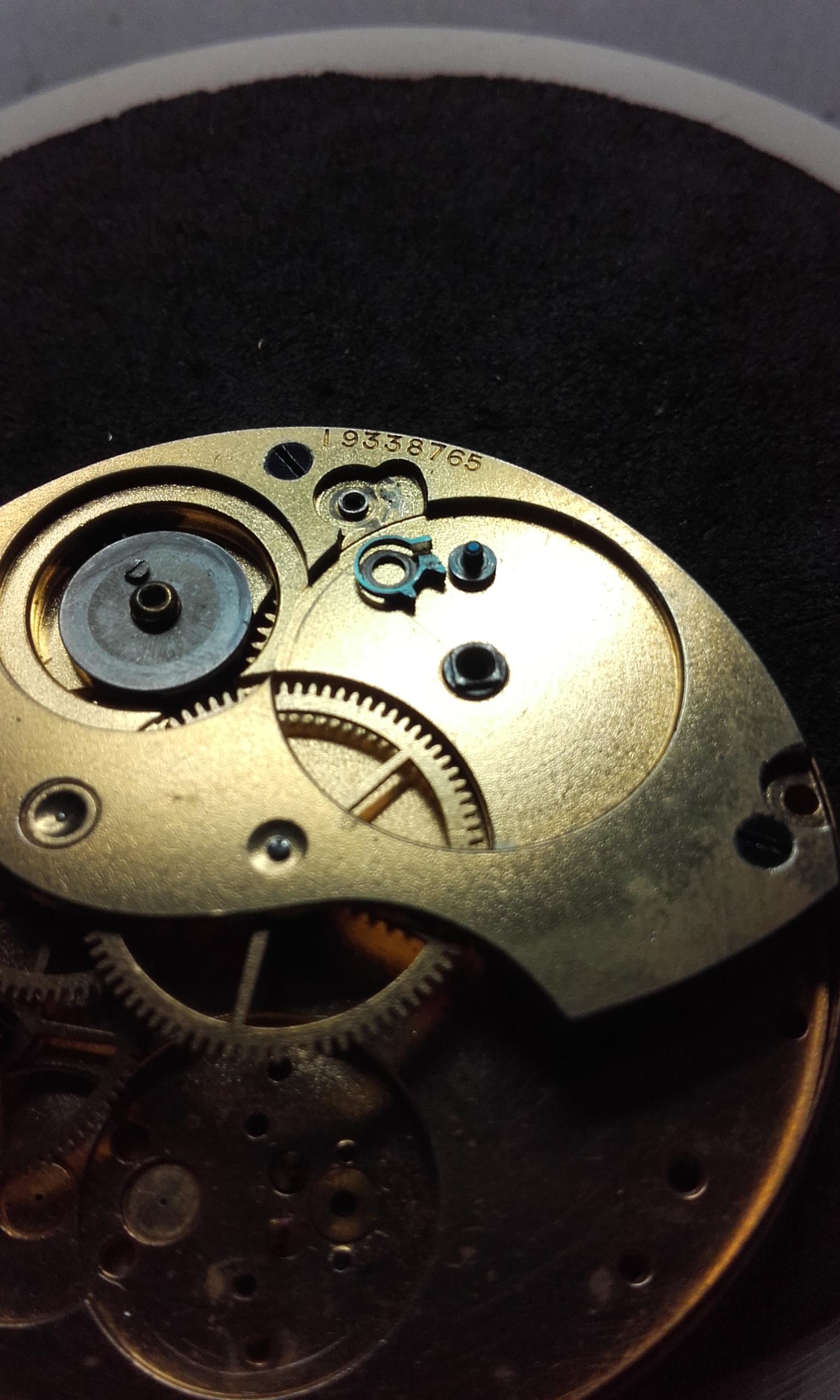

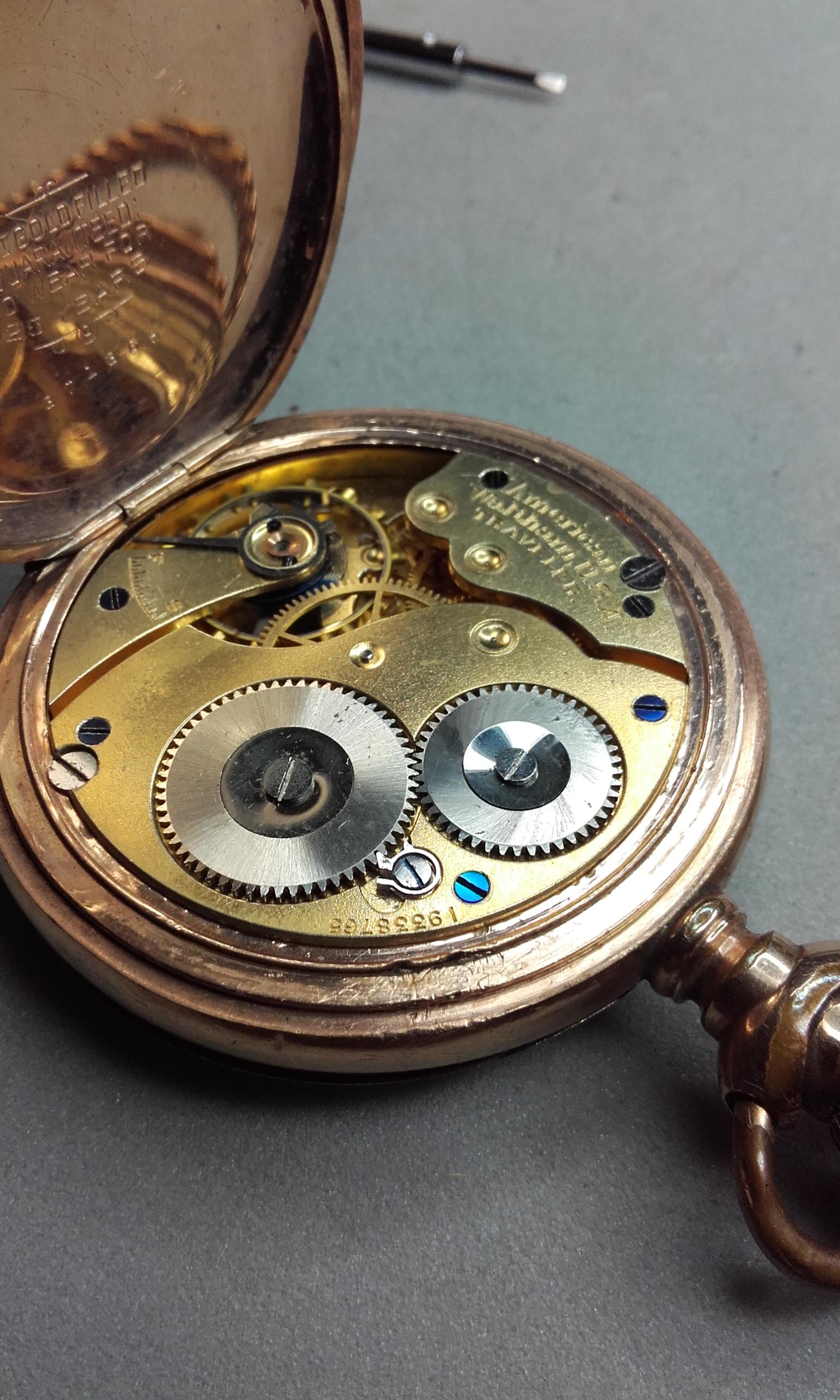

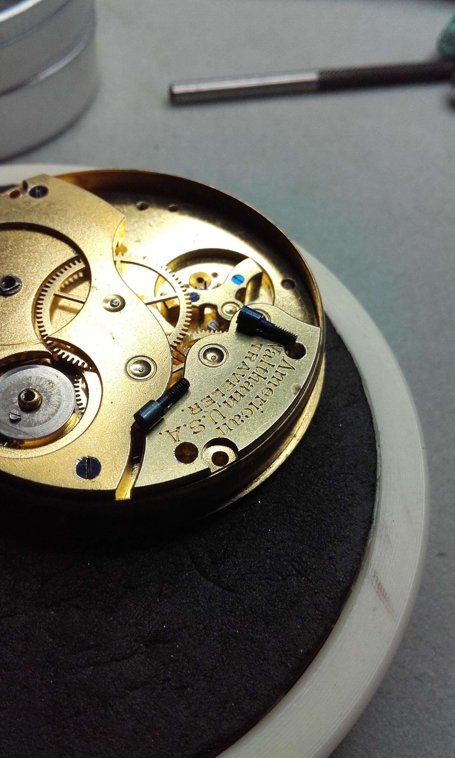

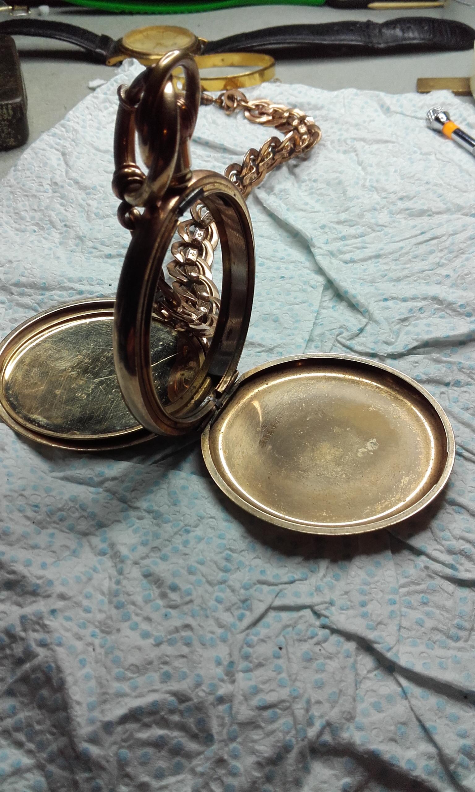

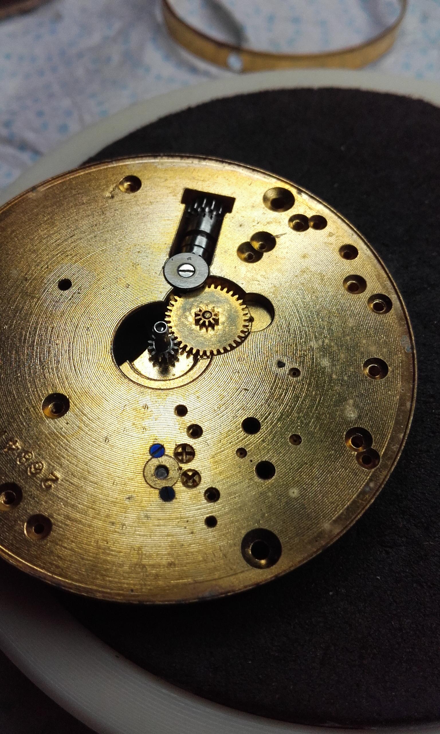

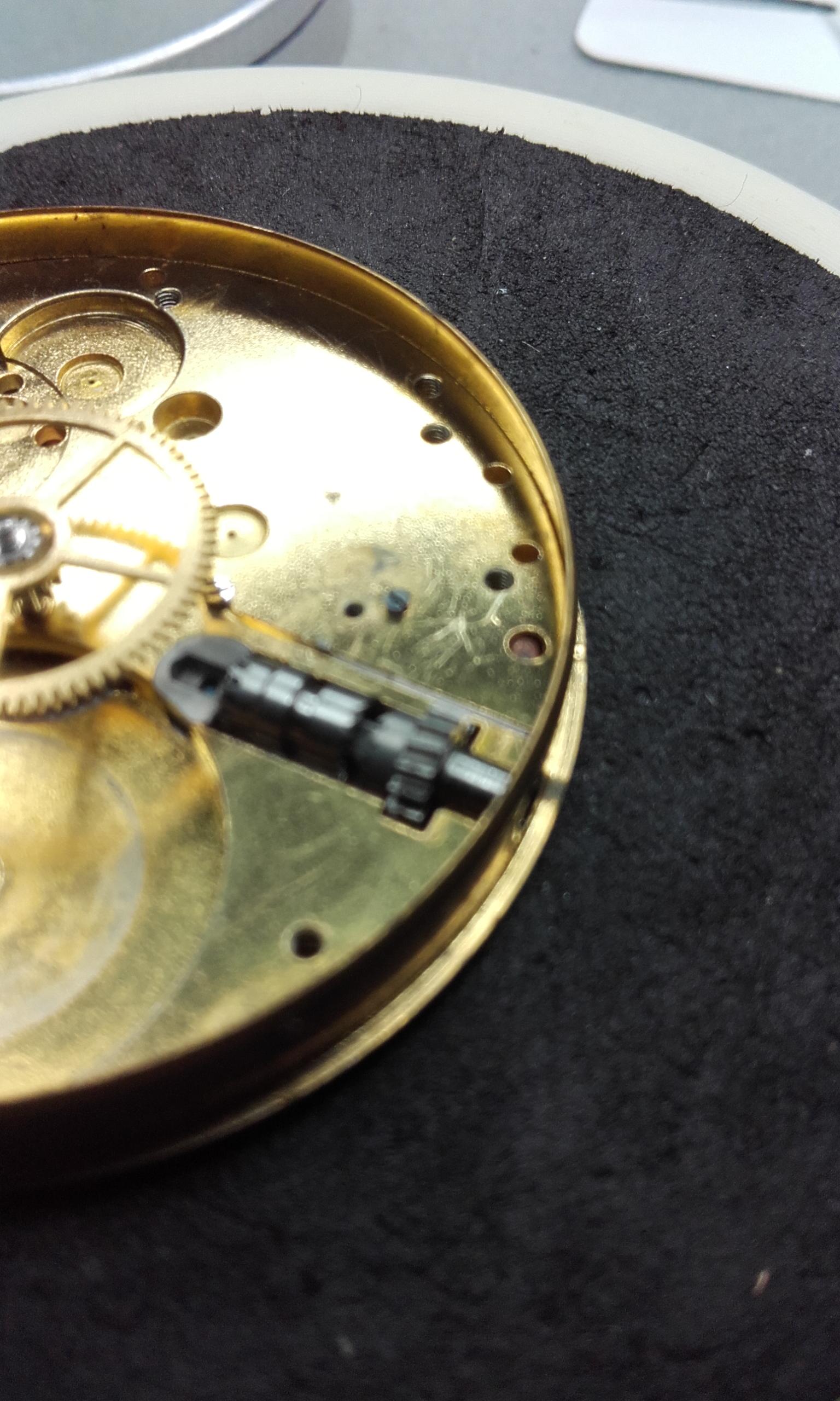

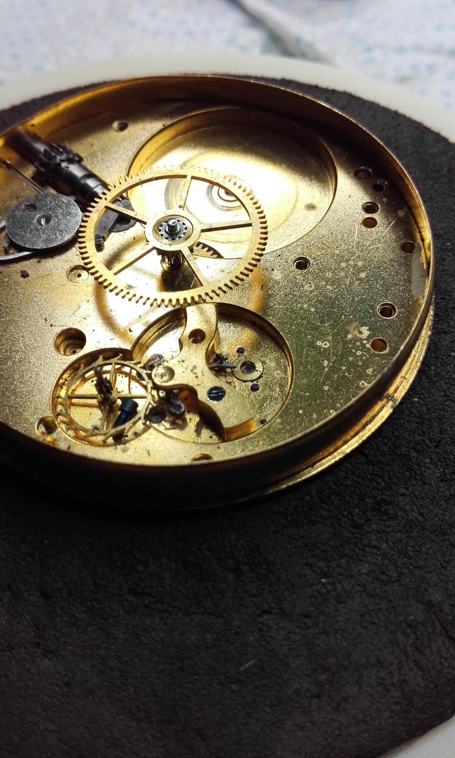

Sorting out a couple of walthams myself.hope these pics can help.B
attach a pic of the dial side, that would be the most helpful to the OP and iam curious myself so maybe someone else can point something out. thanks
looks like stem needs to be pushed in to set the time, i would check out the stem sleeve and stem. pull the movement and see if you can click the stem in and out with the crown, if there is no movement then disassemble the crown, stem and sleeve and give them a good cleaning. when screwing in the stem sleeve start at the point where it screws in the farthest. i know a guy who works solely on old waltham/egin pocket/wrist watches and he said the hardest thing is matching stem and sleeve to a case and making it work properluy, and boy he is right since i have the same issues as well.
Bernie

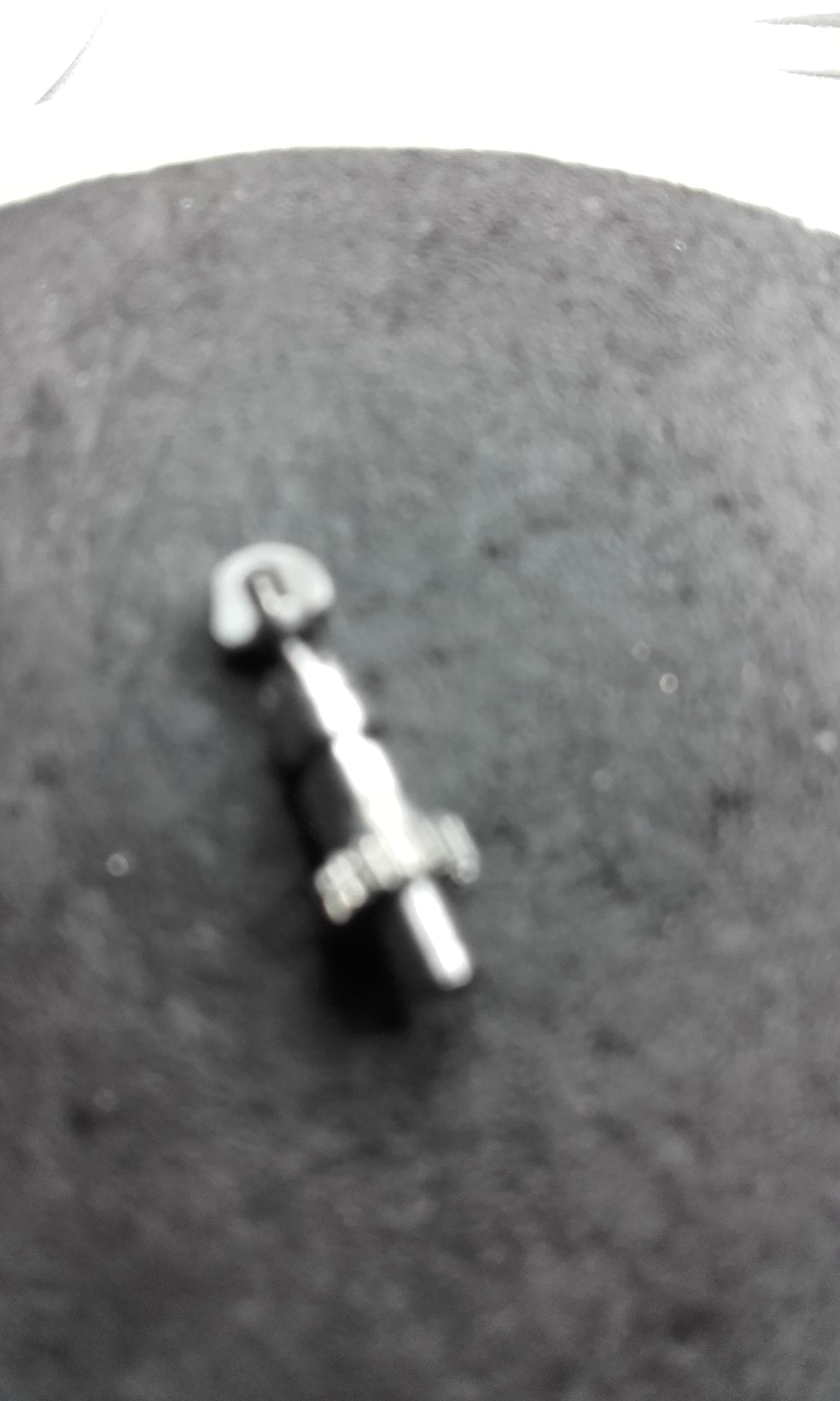

That little silver disc with a screw through it in your final pic....Is that a left hand thead? Been trying to remove it for a while with no success. I think its pull  out to change time and the problem is under that disc
9 hours ago, chrisdt said:
Bernie
No its a normal thread. Underneath is a spring which surrounds an arm×2.one fits at the end. There is a little screw that stops it going back to far. The other fits in between the gap on the cylinder (I have forget the exact name. Old age!) that moves up and down to set the time.
2 hours ago, chrisdt said:
Thanks Bernie
Trouble is I don't want to chew it up.. Perhaps WD 40 for a soak
Should be fine just don't over do it. It's only a small screw just make sure the screwdriver fits the groove and a bit of pressure should do it. B

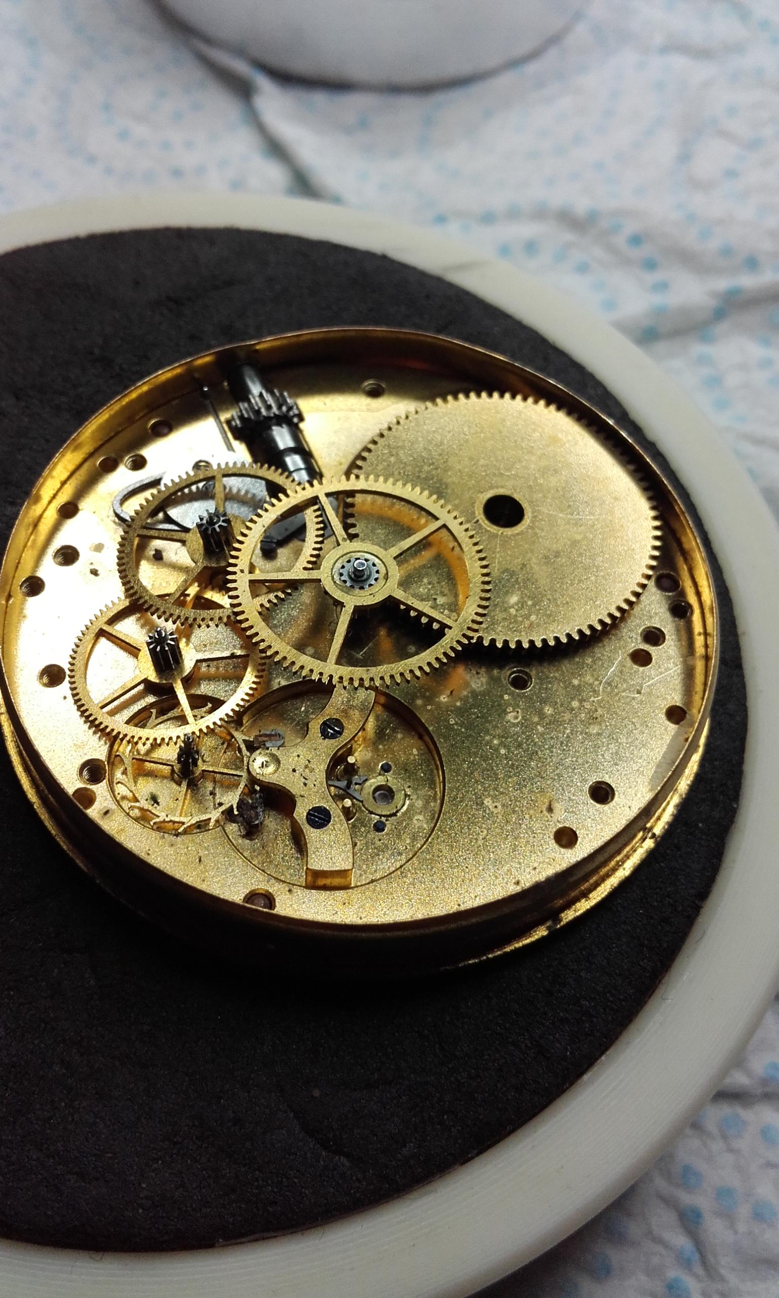

    • The part was how it fell out of the movement - the train wheel bridge wasn’t screwed in.    I’ll probably dismantle the part, if I can, to work it out.    The train of wheels ran fine - it was only once the keyless works were installed I noticed the problem.
