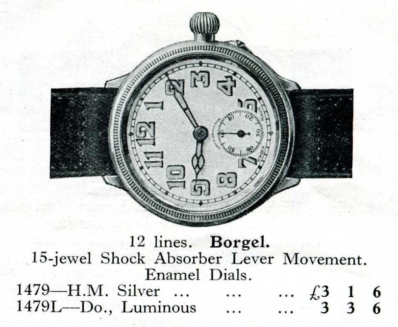

Hello there. I know I am resurrecting another old thread but I wanted to let you know that I am 99% sure your watch is original and all the bits go together, apart from the hands where at least one is wrong, as they are not a pair, and probably both (they were probably luminous originally).
As has been said the movement is a Helvetia 81-24, this movement was introduced in 1929 when Helvetia patented their new shock protection system. Helvetia is a brand I collect and have a site on, they only numbered the bridges of their movements for a short period around 1930.
The serial number on the case is a Helvetia one and also dates the case to 1930, this would make the hallmark date letter a 'Z' which it does appear to be. You can see the lugs of the case are of a later style more similar to a cushion watch than earlier Borgel trench watches.
Helvetia specialised in water and shock protected watches, their main importer to the UK was Robert Pringle and Sons of London. You can see the Robert Pringle and Sons import mark 'AGR' on the case (for Arthur George Rendell an employee of the company).
Periodically Robert Pringle and Sons published a catalogue and below as the final proof is a picture of your watch from the 1931 edition, note the case style is the same as your watch and different to earlier Borgel cases.
Have a look at my site here https://www.helvetiahistory.co.uk/1930s-sports-watches for more info on Helvetia water and shock proof watches.
Thanks. Carl.

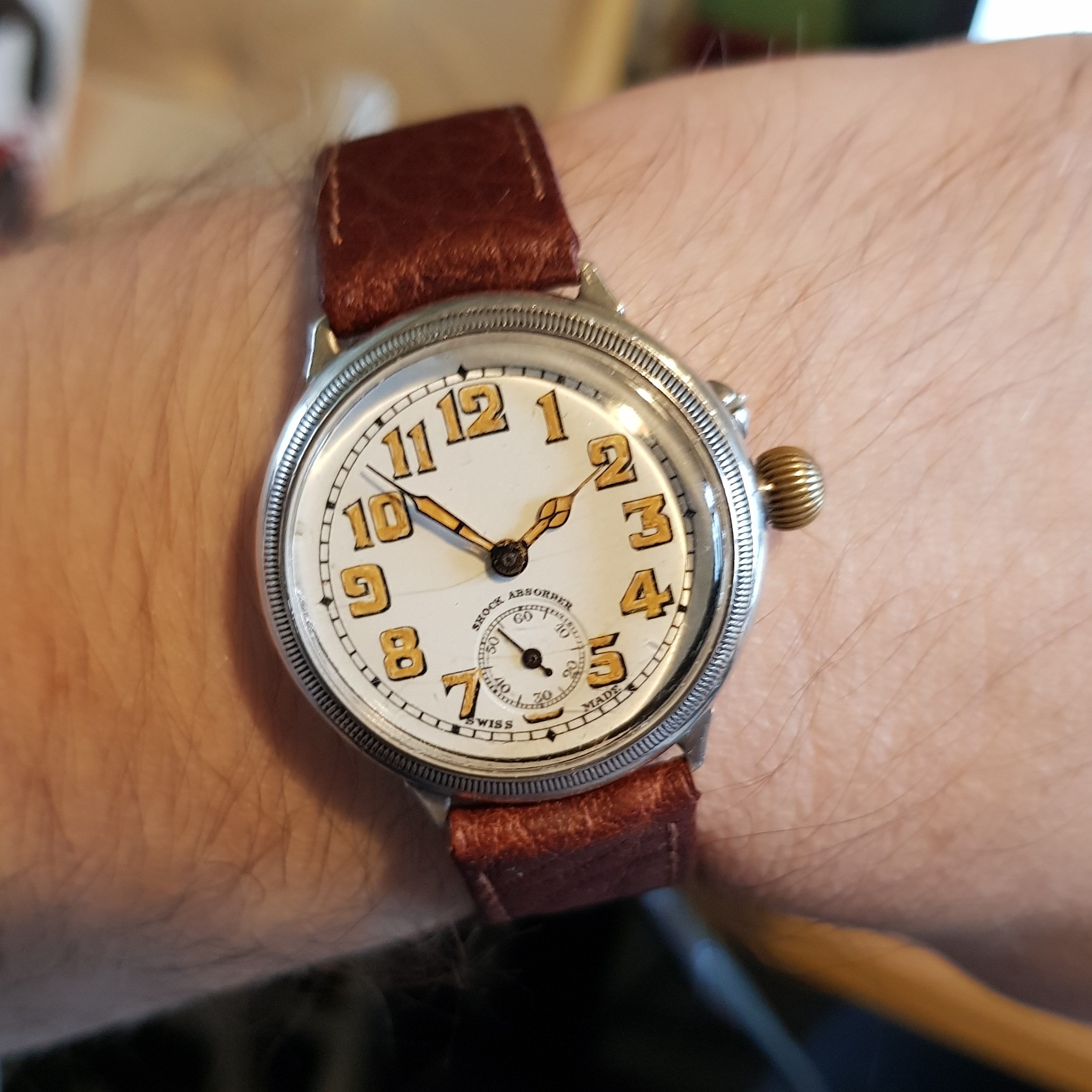

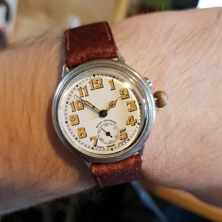

Hello again. Just to let you guys know that as a collector of Helvetia watches I reached out to bjd1020 with an offer to buy this watch for restoration. I received it a couple of months ago and have been slowly getting it back to it's original condition.
I received the crown I needed today and here is the result:

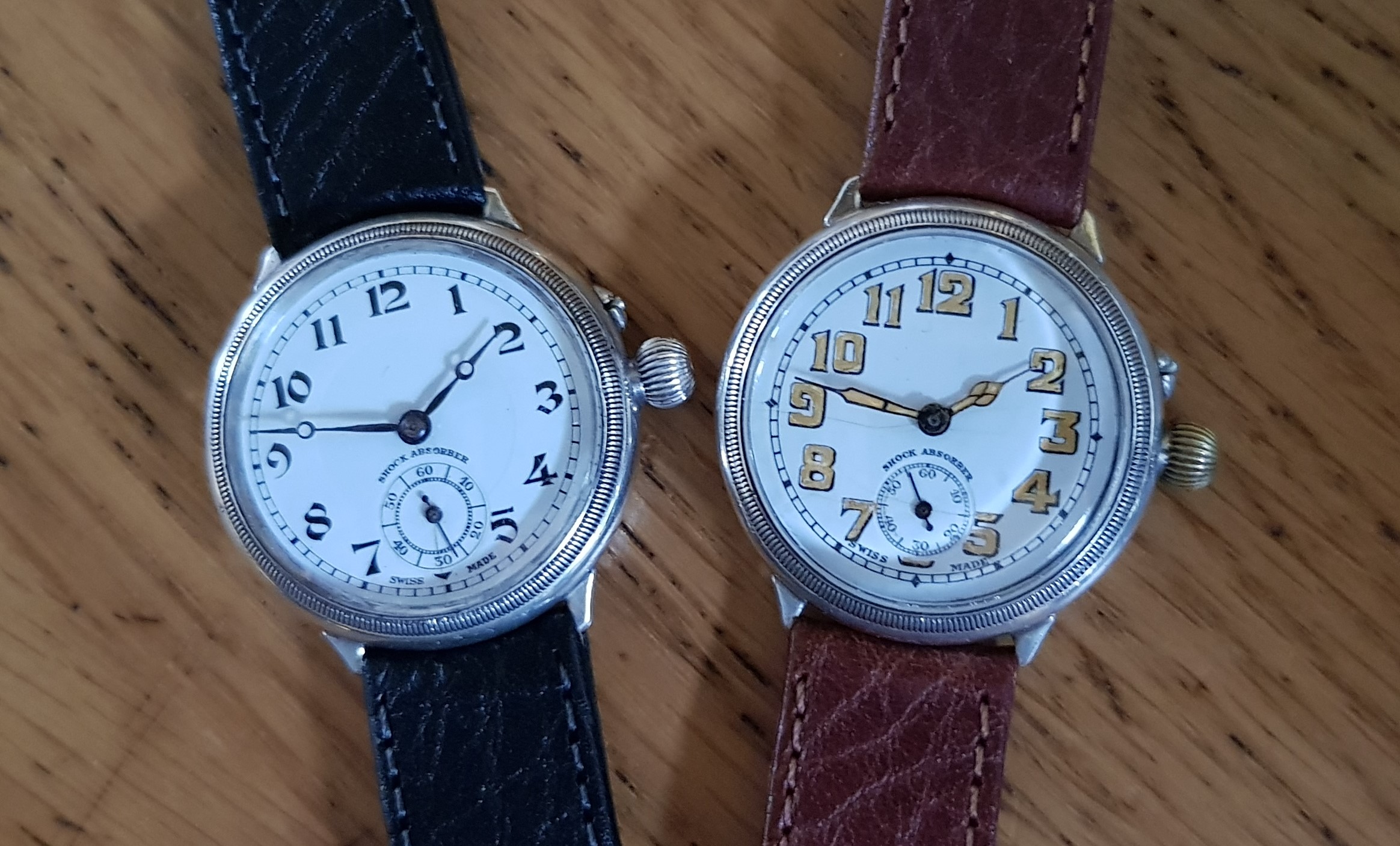

And with it's 13 away serial number brother I found while looking for parts for this one.
Thanks. Carl.

I second Tudor, nice restoration indeed.
Rare piece, cute brother too, both will do any collection justice.
Wear it in good health.
