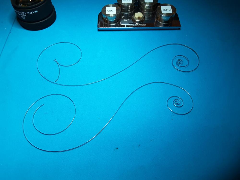

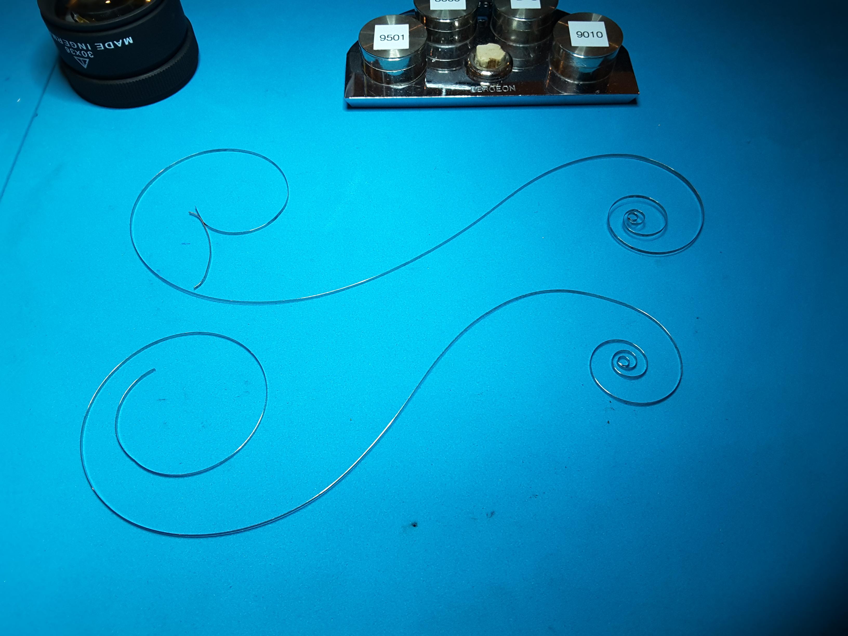

Image below down to my last spare. You can see the bottom spring the the autowind slip tab broken off  end of spring. If there is a proper term/name for this tab, by all means, please advice.

I have used the 401615 spring (from stefan) in my 6139B having also had the slipping part break off.
You may find some info from me on this forum and also there is stuff on the Seiko forum (unfriendly lot though!!).  My 6139-6002 (Pogue) seems to run well and keeps good time although the amplitude was a little lower than commonly found but this is not unusual for Seiko.
