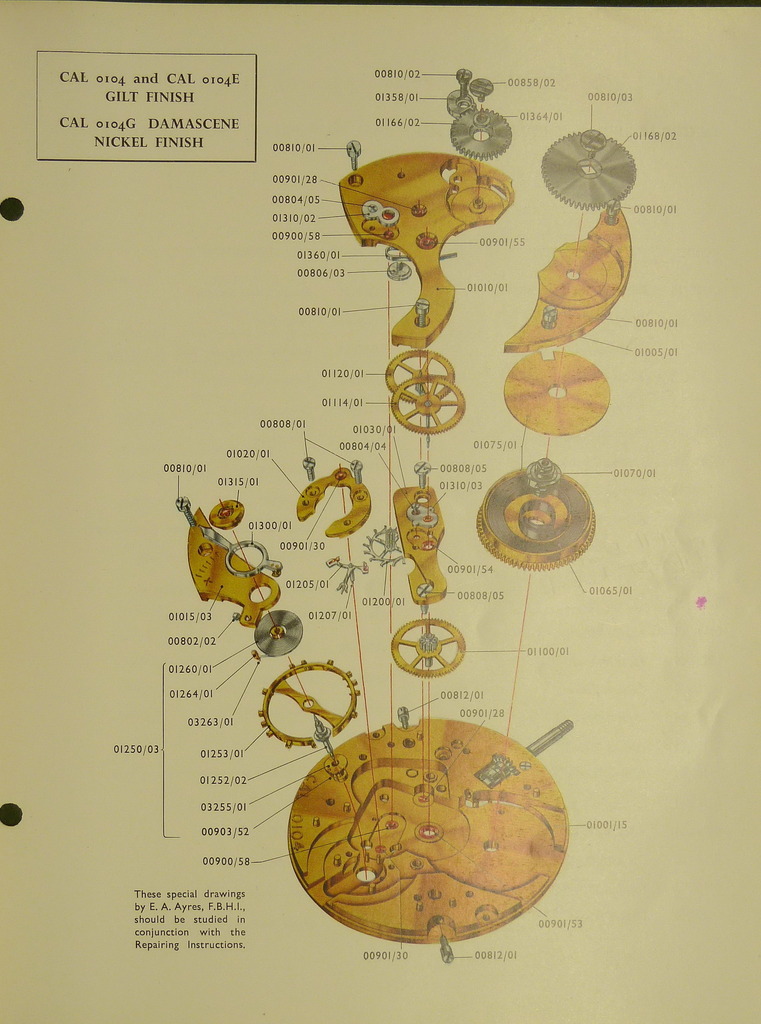

  3. I have a Smiths Imperial 19J Cal 0104 (one of my favourite watches ) - it looks very similar. I found some documentation for it, but it doesn't mention hand size. You could contact these people : https://www.smithswatches.com/collections/all Smiths-0104.pdf

  14. The above datasheet says it's for Cal 0104E and 0104G, so I guess it covers 0104F too? On the above website there's some useful info on the model histories.

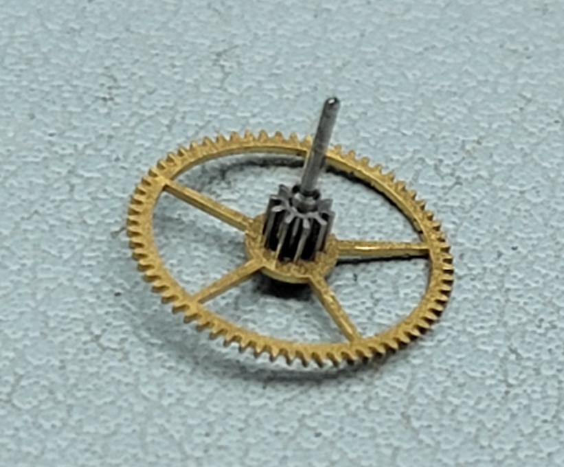

  24. Well, an update. I must confess my sin. When I turned down the rest of the post before drilling and inserting the new one, I failed to notice the diameter of the pivot that rests in the bushing (the shoulder) was greater than the rest. I illustrate what I missed below. The arrow points to the additional diameter that I missed. So, rather than turn a new one, I stole the pinion and shaft from a donor (the wheel on the donor was broken in half). This was not as straightforward as I hoped. The dimensions of the replacement part were larger and as a result, there was ZERO endshake (perhaps negative). I had to turn down the part of the shaft that rests on the bushing to make it fit. Live and learn.
