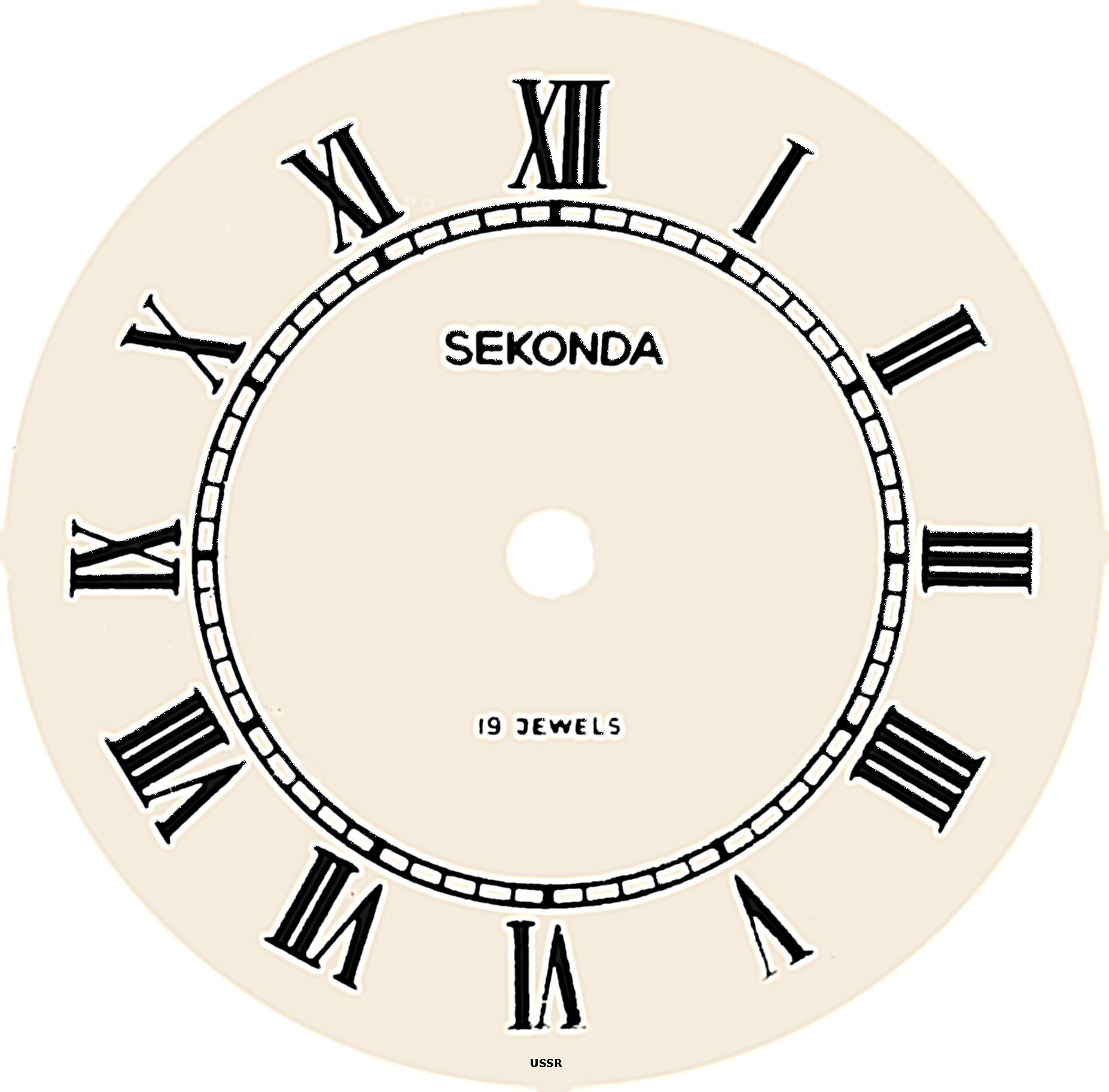

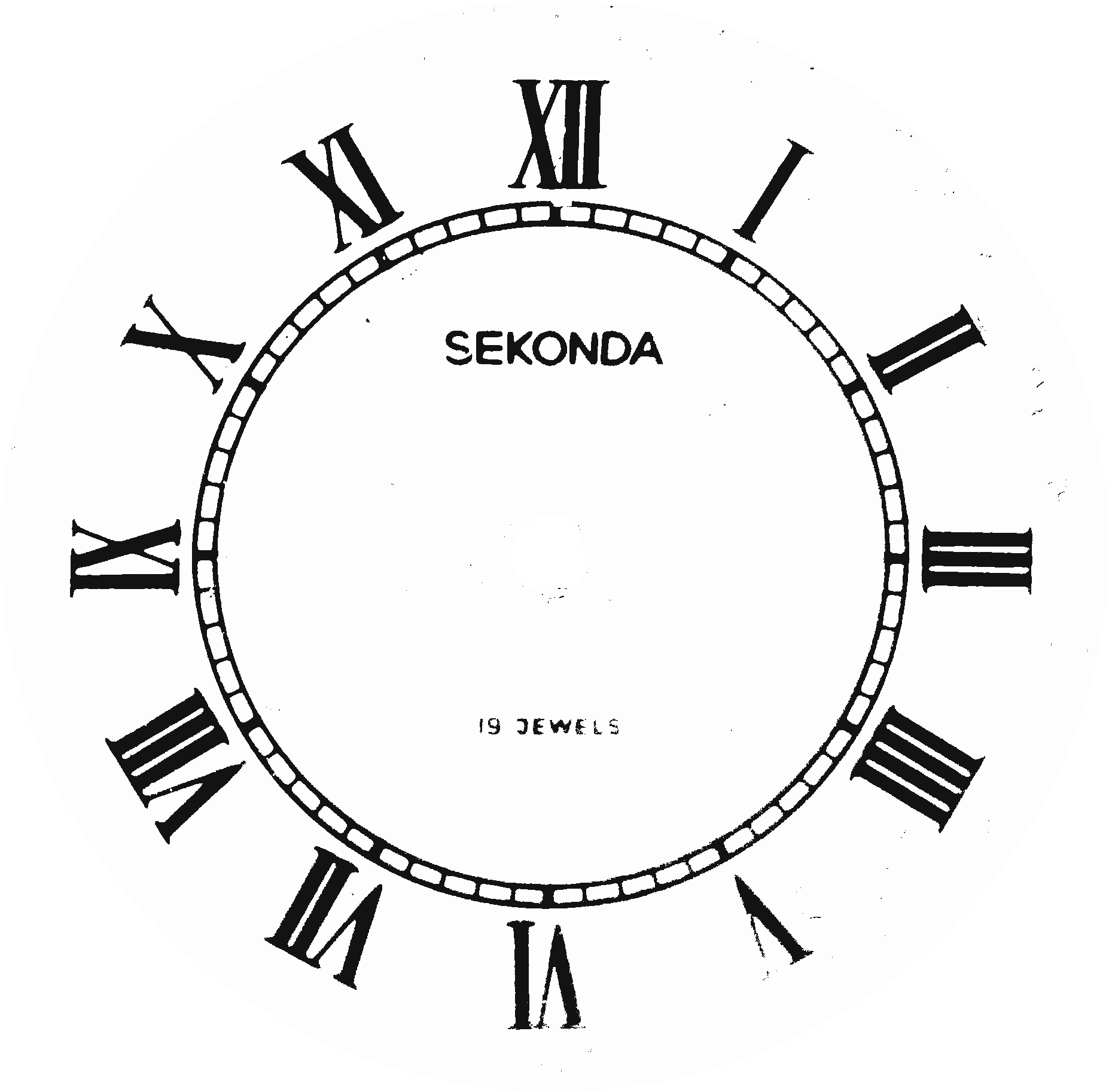

I grabbed a picture of the dial and did a little initial cleanup, in case I get a chance to repair it.
I'll post it here in case anybody else is interested. I still need to tidy up the missing bits and sharpen it up.
It is also not to any particular scale, so it would need to be sized before I attempt to print it.  I may also add some registration marks, and possibly convert it to an svg if I can get a version that I am happy with.
