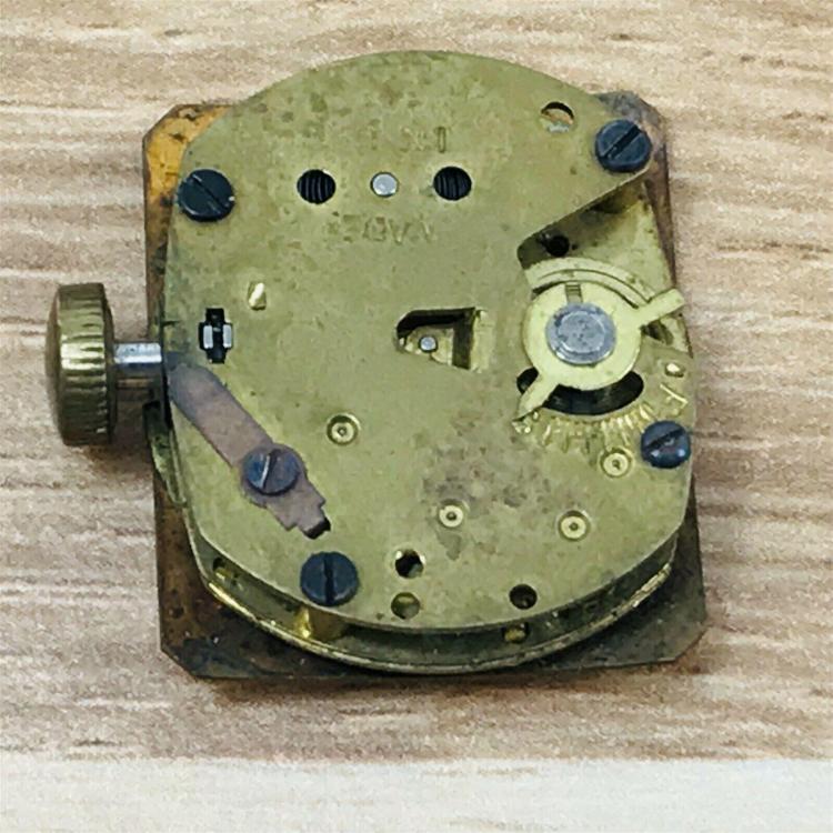

More of the Fero.
The degunked dial.
Much improved following a little more cotton bud magic...
Does anybody recognize the caliber?

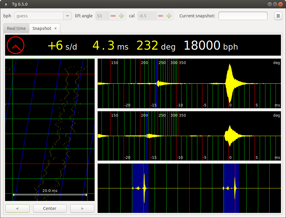

It does seem to be running pretty well after its quick service and lube.
Ignore the bottom half of the trace, that was a different watch.
The beat error is a little high, and the swing drops to around 200, crown up, but I can live with that.
