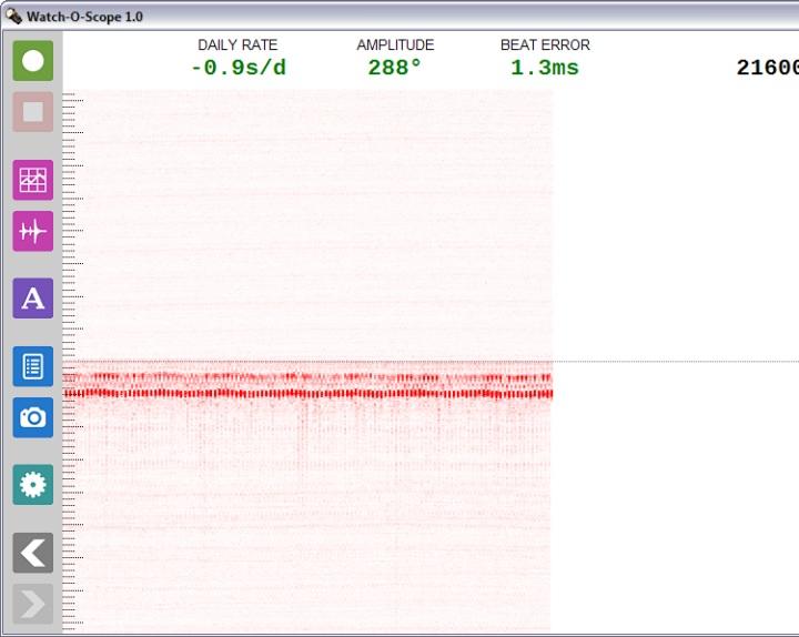

@JohnR725; I dropped in the other m/spring barrel (good idea), but that didn't seem to do the trick. I had a go with the software and "printing" out graphs. Hopefully it includes the raw waveform data you liked to see? The data below is with the 2nd m/spring barrel, everything else left unchanged.
As for the number of ticks&tocks in the scope mode; the movement has 18.000 bph = 5 bps. = 1/5 of a second per tick or tock. The software sweep setting allows for 1/5, 1/2.5 or 1 sec sweeps. I took for DU first the 1/2.5 sec sweep and subsequent the 1 sec sweeps, followed by what the timegrapher makes out of the input (obviously I left the movement untouched in that particular position).
Dial UP: 1/2.5 sweep
Dial UP; 1 sec sweep1593926916_DUPic5.PNG.40075eea648593fbc3ef2aa2d73c3155.PNG405491188_DUPic.PNG.d05eab4e029eacf2045e123f9e3ed427.PNG
Dial Down:
405240553_DDPic5.PNG.866cf17a560f4b731ec70eea13b957d3.PNGDD.PNG.e9a7842ce78eae7b3627d6c3dcef20dd.PNG
Crown Up: I later adjusted the threshold level, as the picture generated by the threshold level shown in the scope mode below was totally unusable; still, like the pervious times, not a clean graph.
1046401851_CU5.PNG.3c210794bd7db8078f482a12ae8b99d2.PNGCU.PNG.26dcb28f665246db09d9f047934fd937.PNG
Crown down:
2094404695_CD5.PNG.537cad66d99f958f671a9403b2a14a8e.PNGCD.PNG.5f542b851bd20eb4d1061a1c5bb3c79e.PNG
Oddly enough, Crown Down seems to give the cleanest signal and the best performing graph, ignoring the daily rate ..... In the Crown Down position the fork is facing upwards, the jewels are facing downwards.
Also note that the amplitude with the 2nd m/spring barrel installed hasn't changed noticeably :mellow:
It may well be that there is a problem with the fork / roller jewel. The roller jewel seems with 10x magnification okay and firm in place. I have no knowledge about, or how to check the jewel / fork interaction.......
If you can pull any information out of the graphs above, or like to see different sweep settings or graphs, please let me know ...

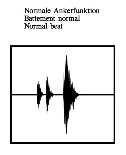

to understand what I'm looking for at least as far as the raw waveform goes I swiped an image off of his website.
so I'm way way past my bedtime and the ability to produce legible responses rapidly declining soil see what I can do hopefully it will be legible?
So let's look at the basics first in order for us to help proper diagnosis we have to have proper results from the timing machine or the timing software or the timing whatever. So the oscilloscope wasn't exactly what I asked for but is actually extremely helpful. So I swiped two of your images combined together in one attached below. I circled where there may be problems and I drew straight lines where it may be okay I'm not sure and I'm guessing because this is a really quiet watch that the software is just struggling entire pickup everything is just having problems. But if it looks like you're triggering off more or less where you're supposed to be notice your graphical display looks decent. If you start triggering off the wrong part of the waveform graphical display looks like crap the diagnostics they go for why do I have a craft be graphical display isn't necessarily going to be helpful because we may be diagnosing off faulty information.
Then I'm not entirely sure that the amplitude is correct even if it's getting a reasonably decent graphical display because it's hard to tell if there's enough of a proper pickup for the machine to get what it needs off the waveform?
So where it looks really nice graphically the rate in the beat are probably correct everything else is probably not. So positional timing is an issue because were not getting a good pickup we won't get a good diagnostic without a good pickup which we already grasp.
so here's a test for you if the amplitude is really this bad and I assume the watches fully wound up? With a note here when timing a fully wound watch you'd let it run 15 to 30 minutes roughly in other words you normally don't time a watch wound up tight. Who needs a little bit a sampling time. So if this is a fully wound up watch an amplitude looks as bad as it does is this watch still running at the end of 24 hour's? Because I'm not sure your amplitude is right based on the timing machine software and if it still running it 24 hours it indicates it's probably not right.

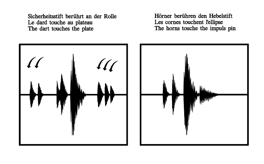

Here is the first raw-data graph of the tick & tock sounds picked up by the microphone of the timegrapher.
There are 5 sounds made by an lever-escapement, but depending on the movement (quality) and quality of the signal, some may not be picked up or go coincide with another sound, indistinguishable so to speak .
So may sound 2&3 and sound 4&5 go together, resulting in 3x distinguishable sounds.
As said, I've to catch up and try to learn the interpretation of the raw sounds, but below is the first graph I managed to produce of the 503 movement, Dial UP. I'm currently not knowledgeable enough to determine how many of the 5 escapement sounds are distinguishable in the graph below or whether there are sounds which are not supposed to be there?
Perhaps the knowledgeable under us can already spot some trouble ?

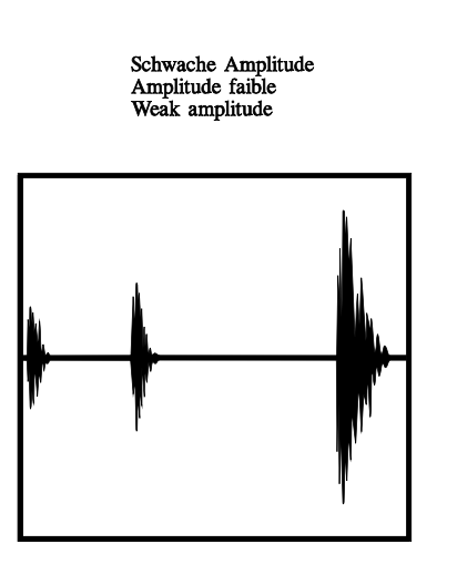

I thought so we can understand better about what the raw format looks like perhaps better to start with a running watch. So this is a ETA 6498 which I'm sure I've service to the zero idea when.
three different amplitudes fully wound up 250° the classic pattern of what appear to be only three sounds. Then dropping the amplitude 160° to roughly corresponds to the amplitude that Endeavor has with his watch and notice it still doesn't quite resemble what were seeing above? We can start to see that there is more than just three sounds but you have to really look for them. Then at 110° thing is start to really separate.
So I get the suspicion that the 160° that Endeavor has may be not quite right. Then the wavy microphone effect he has the uneven timekeeping is still either magnetism or the classic uneven power through the gear train.
