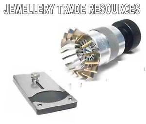

For high dome replacement, I used one of these. The type of tool you have mentioned I used for fitting glasses with a tension ring
I''ve got one of those for fitting the 'unbreakable' acrylic crystals.

These are what I'm talking about
