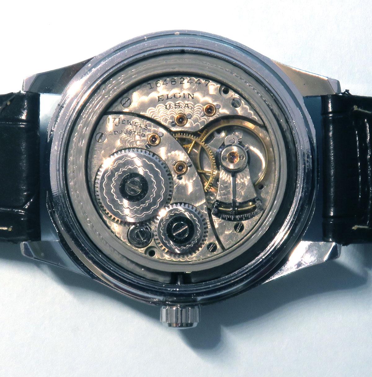

Old Elgin Losing Time
You need to post pictures from a timegrapher or equivalent application,  If it could be possible that some application could read your files or even interpret from playback, but that would never be good as a first person observation.
Otherwise all you could read here are generic statements like "clean and service the movement" - which in fact should certainly be done, or "something is touching and ringing", again you will not know what until the mov.r is taken apart, cleaned, inspected and lubricated by a competent person.
If you have been looking after your watch, I would say a good service. It is quite old and the mainspring could be tired, therefore the movement will not work on poor power this its self would cause the watch to keep poor time.
Did you make the movement spacer yourself with a 3-d printer? How has it held up with regards to the material.

Thanks guys,
JDM- I don't have a timegrapher, I do this for fun. It is interesting though that your answer is similar to one I received on Timezone also in the watchmaking and repair forum. If I was working on an antique car and posted a question on a forum I would get a ton of answers and opinions of how to fix something, but in watches the answer is almost always the same, go to a watchmaker or seek a "competent person". I am involved with watches because I enjoy it, of course I could just pay someone to do it for me but then it's not much of a hobby is it?
oldhippy- Thanks, I have ordered a new mainspring but because the sound almost sounded like a pinging I was hoping that might be familiar to someone in regards of where the problem might lie. I do own an L&R cleaning machine but have not cleaned or oiled the watch for a year. It was just that the sound sounded unique. I'll see what happens when I put in the new main spring. Thanks
Anilv- Yes, I 3d printed the movement holder. The hard part was making a new stem that would lock in as the original watch was spring loaded to wind or change the time.
