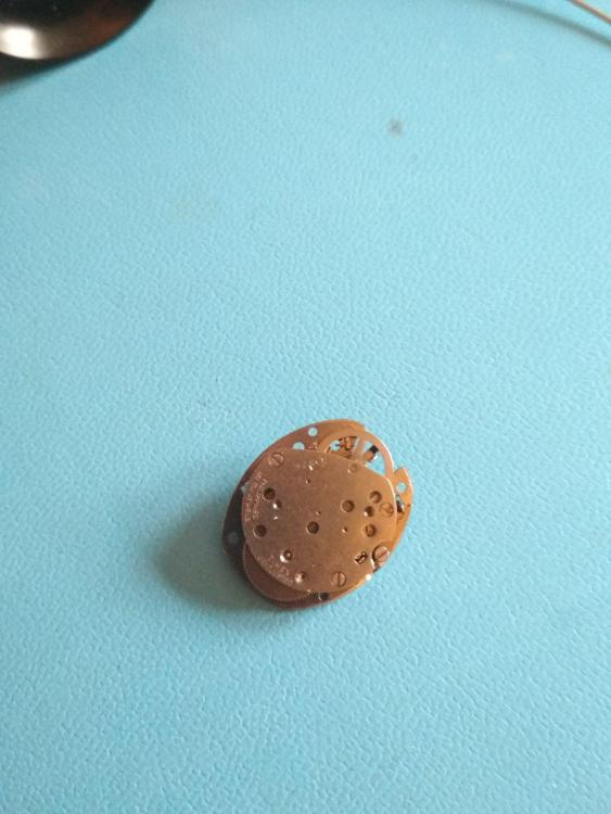

Hey guys, not sure if you'll find this interesting. My girlfriend's Timex was fitted with a jewel-less, unadjustable movement, which was losing quite a bit of time.
photo_2018-02-25_16-01-14.thumb.jpg.2c4c7540c59b622e61e192059c88e163.jpgphoto_2018-02-25_16-03-53.thumb.jpg.01aa0bfe399b63f8ec1963812027845e.jpg
I picked up an NOS ETA 2540 for a few dollars, cleaned and serviced it and with the help of a trimmed plastic movement ring, fit it into the Timex.
The sticker is a temporary fixture...
It is the original yep, may fit a replacement in time. The crown is the smallest I could find to fit the ~2.8mm case tube, makes for some leisurely winding!

Very cool! Pretty sure this movement is the one I removed from the Timex, if you are on the lookout I have one spare!
Thanks for the offer but, the movement you removed is a #78.  Used in ladies watches.  This one is a #106.
