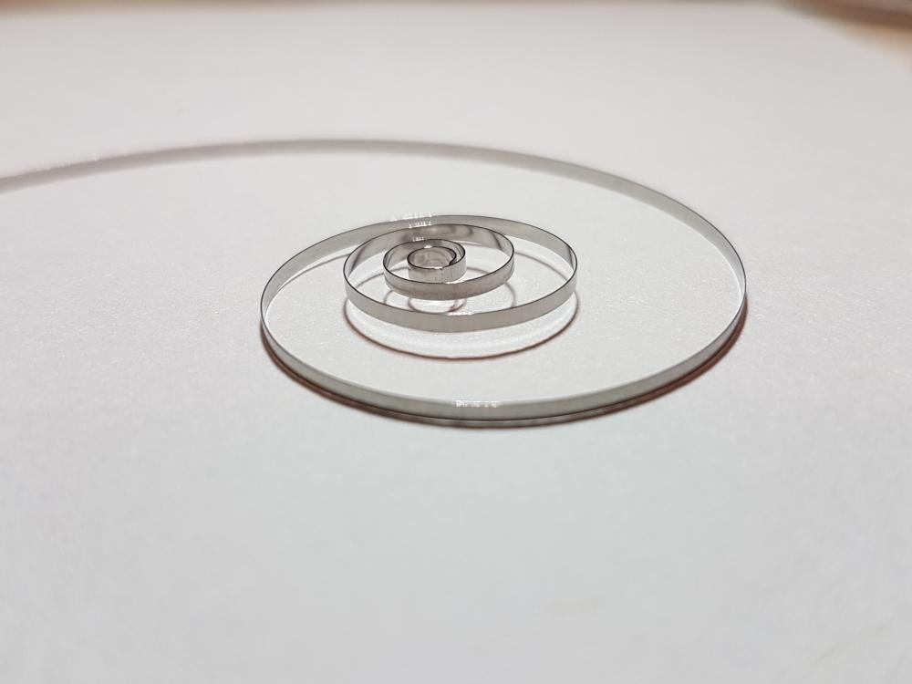

Well I have the answer to my problem, and it's not what I was expecting.
I just took the mainspring out - a new one from Cousins. As I pushed it straight in to the barrel from the washer, it's odd that it's coned?
I have the old spring so decided to measure them.  The measurements are similar, but when I straightened the new one (not too much) to get an idea of the length, it didn't return to anything like it's original shape. It doesn't feel like spring steel at all, just un-hardened steel. There's barely any spring there at all.
Has anyone else come across this ?
The cone shape is from winding by hand (experience), and no, it should not be that way, it should be flat. As to the recoil, I would think it should return to its original shape if it has been manufactured correctly, it may just be a bad spring. Alloy springs should have an "S" shape when unwound, generally. Old brown or blue steel springs were coiled.
Well this one is for the bin. After gently straightening it to get an idea of the length, this is what it looks like.
It's definitely not spring steel !
It explains why there was very little resistance while winding, and why I couldn't get reasonable amplitude. Pity I've spent so long stripping and examining all the other parts. I never expected a new spring to be the problem.
