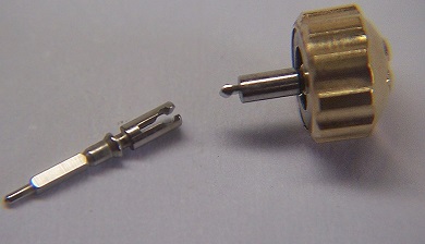

So in summary as I'm understanding this; it's a movement with a split stem (something like the image below) however the crown has pulled away leaving the male part of the stem still in there.
Have you tried seeing if there's enough thread on the stem to put another crown on or, perhaps preferably as you'll be able to observe and locate better, see if you can thread a 'stem extender' on what's left of the male stem. Perhaps any remaining little thread and a drop of super glue on the extender would give enough purchase for you to split the stem.
After that I can only see two options open to you. Either drilling as robabod has already stated ... or carefully filing away the pendant tube to reveal the stem for extraction with pliers. Obviously you'd then have to replace the pendant tube but given it may be compromised through the drilling option anyway it's an option to consider. The lesser of two evils really. Join the not-a-big-fan-of-split-stems club! :wacko:

Unless this is different, one half of the stem will always be in there until the movement is out and can be removed in the normal way! My observation is that the OP's picture only shows the crown and not the other half of the split stem that would normally come out with the crown. That implies it is still in there. And if it had some thread...!

Is the outer half of the stem still there? Hard to tell from the photos. Just reading what member Watchmaker wrote. In which case you could be in luck. Or are we looking at the end of the inner half?

If the outer half of stem is still present, then try threading on another crown with a long enough tube, and perhaps a crown one size larger if the corrosion has caused the stem to bloat in size. If there is nothing to thread onto reliably, then machine a tube to slide inside the pendant tube and over the rusty stem; use two-part epoxy to adhere the sleeve to the outer half of the stem and then remove.
Of course, even if the outer half of the stem is still there, it doesn’t necessarily mean that the inner half isn’t seized too!
