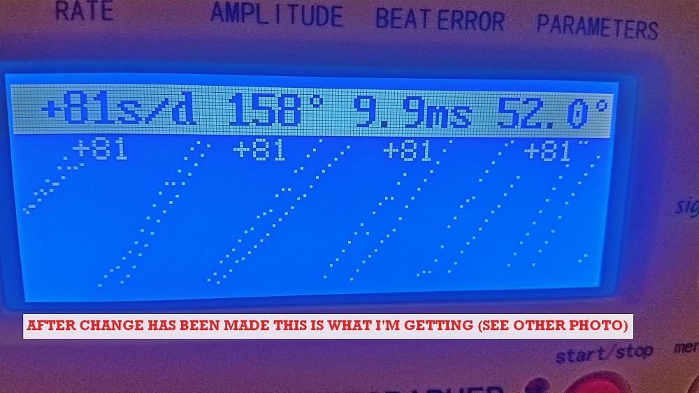

I've just gotten my new Timegrapher and started to check our watches. I tested this vintage Tissot (20mm long) and the Rate reading was +350 s/d and Beat Error 0.2 ms after I have moved the lever all the way to the left (slowing it down) it reads now +130 s/d but unfortunately the Beat Error went up to 9.0 ms. THis watch haven't used for about 10 years and looking at it, it seems to be very clean, so I guess it might need to be oiled but other than that, what else I need to do? Shall I move the other leverI've marked in the photo (as I understand it regulates the beat rates and I see many warns not to move it)?
Thank you for your help!

Afer a few hours of playing with the levers this is what I've ended up with, but unfortunately, the results only good when the watch is laying flat, nevertheless comparing what I've started with +350 s/d. I feel that it is fair enough for my first time. Thanks for the suggestions and encouragements guys.
There is not enough amplitude (bare minimum 200 deg. on Swiss mov.t) to make it run reliably. The wavy pattern indicates that the mainspring struggles in providing constant power. The watch might be able to keep good time, but that would be a lucky occurrence. Certainly you did a good job in regulating for a first time.

A little more detail... the part that you have labelled S F is the hairspring stud holder, moving this changes where the point of rest of the impulse pin/roller jewel is in relation to the pallet fork, by moving this around you change the distance of each half of the balance swing (the tick and tock)
The other part noted is regulator arm which holds the curb pins, these change the effective length of the hairspring to regulate the timing. Moving them further away from the stud holder (in this case clockwise) will shorten the hairspring, making the watch gain time. Moving them closer to the stud holder (anti-clockwise) lengthen the hairspring, making the watch lose time.
As you found, there is a relationship between the 2 parts, that mean changing one affects the other.
Tom
The low amplitude could  be lack of cleanliness i.e. oil congealed oil/dirt in the balance jewels. This will slow to balance with a greater effect showing crown up/down etc. This watch in my opinion needs a service & clean & re-lubricating before any further adjustments.

Just lubricating the watch is not a good idea. It could make matters worse because if it is dirty you are just making a bigger sludge for the pivots to turn in.

The problem with visually looking at a watch and seeing that it's clean isn't really a fair assessment of the condition of the watch. Combined with a timing machine result especially if the amplitude is incredibly low is better. That tells you that while it may look clean it's not clean as others have noted above. The problem with lubrication it doesn't just disappear in it can do a variety of things including get very gummy which results in low amplitude. Depending upon how well the watch was sealed Moisture can get in pivots can get rusty. Then combined with fresh new lubricant it makes a really nice grinding compound.
