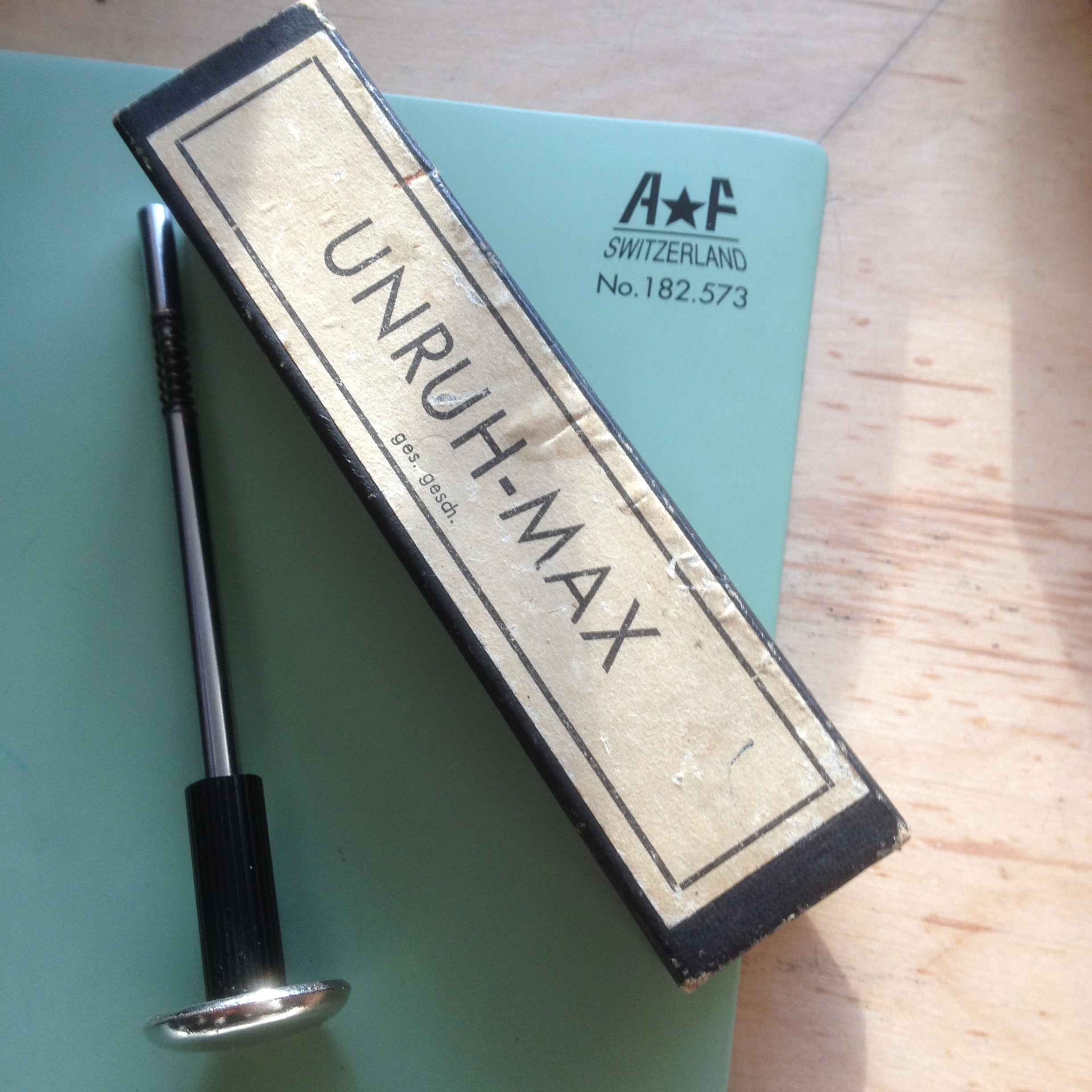

There is another tool that can be used & I have used it with pocket watch staffs. It works by placing it over the old staff & pressing firmly on the balance rim and when pressing the plunger (which is spring loaded) it shocks the old balance staff out. The shaft is the same diameter as a staking tools punch and it is recommended that it is also used with a staking tool. I must admit I have not used it for a few years now but it does work but a bit crude.
The bottom line is use the correct tools if available.
