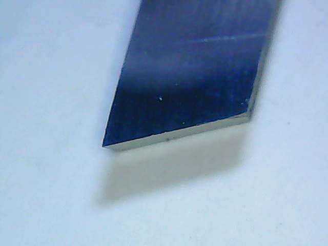

Finished shaping my tungsten gravers yesterday from a 1.7x4mm stick. Cant wait to try them on hardened steel.
I have never seen any sources describing pivot making by turning it down to size. It was always achived in a special burnishing tool or on the Jacot tool with some kind of a file.
As i pointed out above there is a report out there showing the turning of soft steel to rough size, then hardened and finally the pivots were grinded.
If the pivot breaks at 0.38mm then the graver is not sharp enough for sure. It should kut the metal with a lightest touch.
