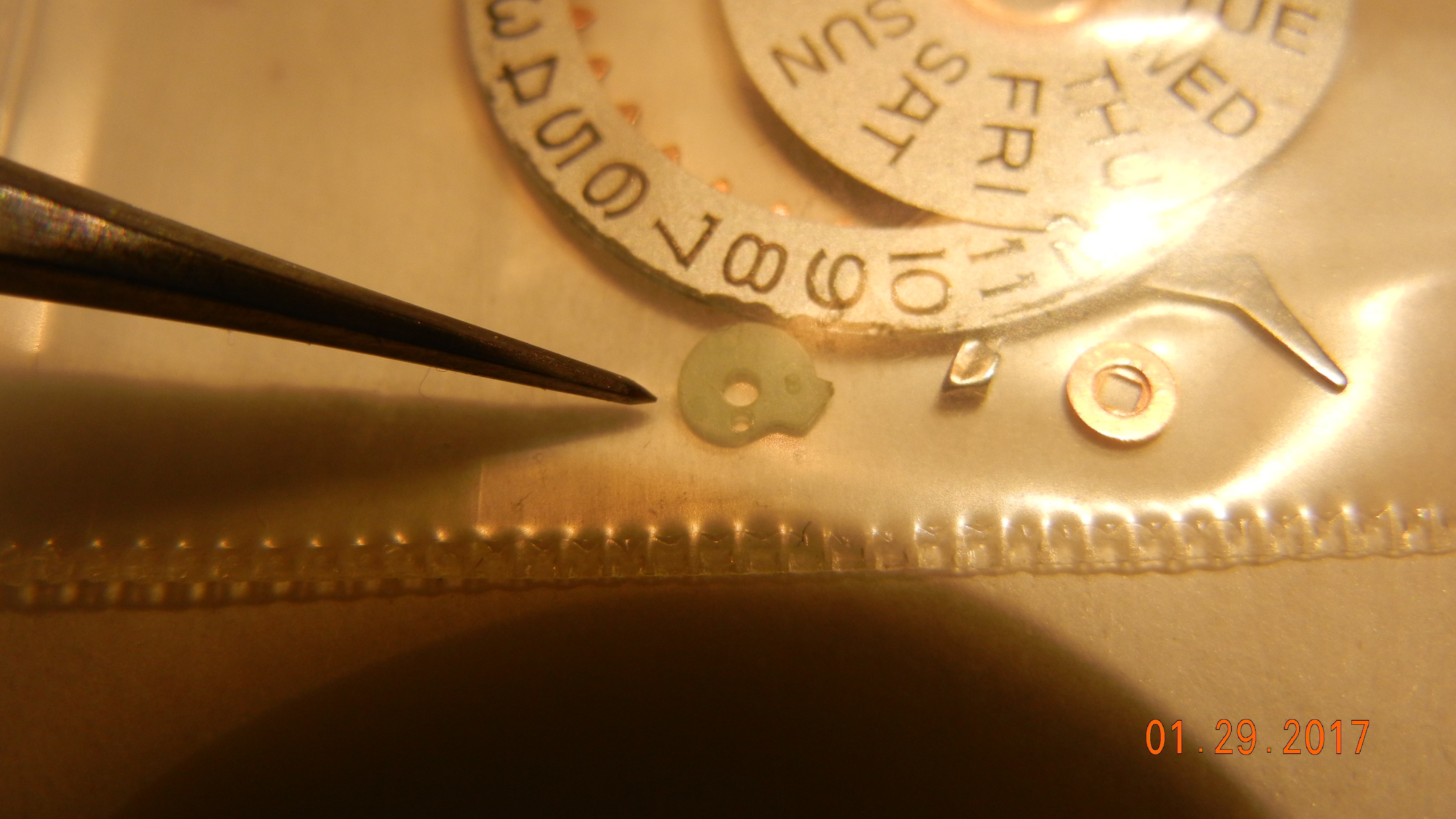

What I thought was a bargain Omega Seamaster Cal 1010, has turned in to the watch from hell (see below*)!
At least it's been a good learning experience.
I thought I'd finally got it all sorted, but on final checking found that the plastic date change finger (part 1562) is worn, and doesn't quite flip the date over.
Cousins want £70+VAT for what seems to be a relatively simple part (now changed to metal, the plastic wearing was obviously a problem).
The cheapest on ebay about £35. Is it just rarity keeping the price high ?
Anyone know a source of anything cheaper.
Thanks
Mike
* On stripping the watch I was dismayed to find the dial stuck on, the dial feet had been removed.
It seems that there had been water damage - the dial feet screws were corroded in, as was the screw for the wig-wag pinion spring.
The keyless work was discoloured, but useable once cleaned.
Fortunately I found a good new mainplate on ebay for a cheap price.
I bought some dial feet, and superglued then on, - I'm very happy with the result.
Then I found severe wear in two of the automatic unit bushes and pivots - again a replacement of the whole unit from ebay,
I hadn't spotted a damaged tooth on the minute wheel until final assembly. A new one from ebay !
Then today I find the date change finger worn. Arghhh

Hello
@mikepilk I understand completely about the frustration with the cost of parts. That's where this site comes in handy...with a world-wide network of hobbyist, there's bound to be someone with some spare parts! I have a plastic date change finger #1562, which if you need can be yours for the cost of shipping.
I have quite a few other parts as well. @rogart63 I am sure you'll get that pesky Omega project sorted out...I have my eye out for the spacer ring, but nothing yet.

Which spacer are you missing @rogart63 ?
I found that gluing new dial feet on with superglue quite easy, and they seem secure.

Thanks for the very generous offer @noirrac1j - but I've already ordered a part.
I will get this watch fixed !
This is the 4th Omega in my collection. The other three were a pleasure to work on. I suppose I was due a turkey.
