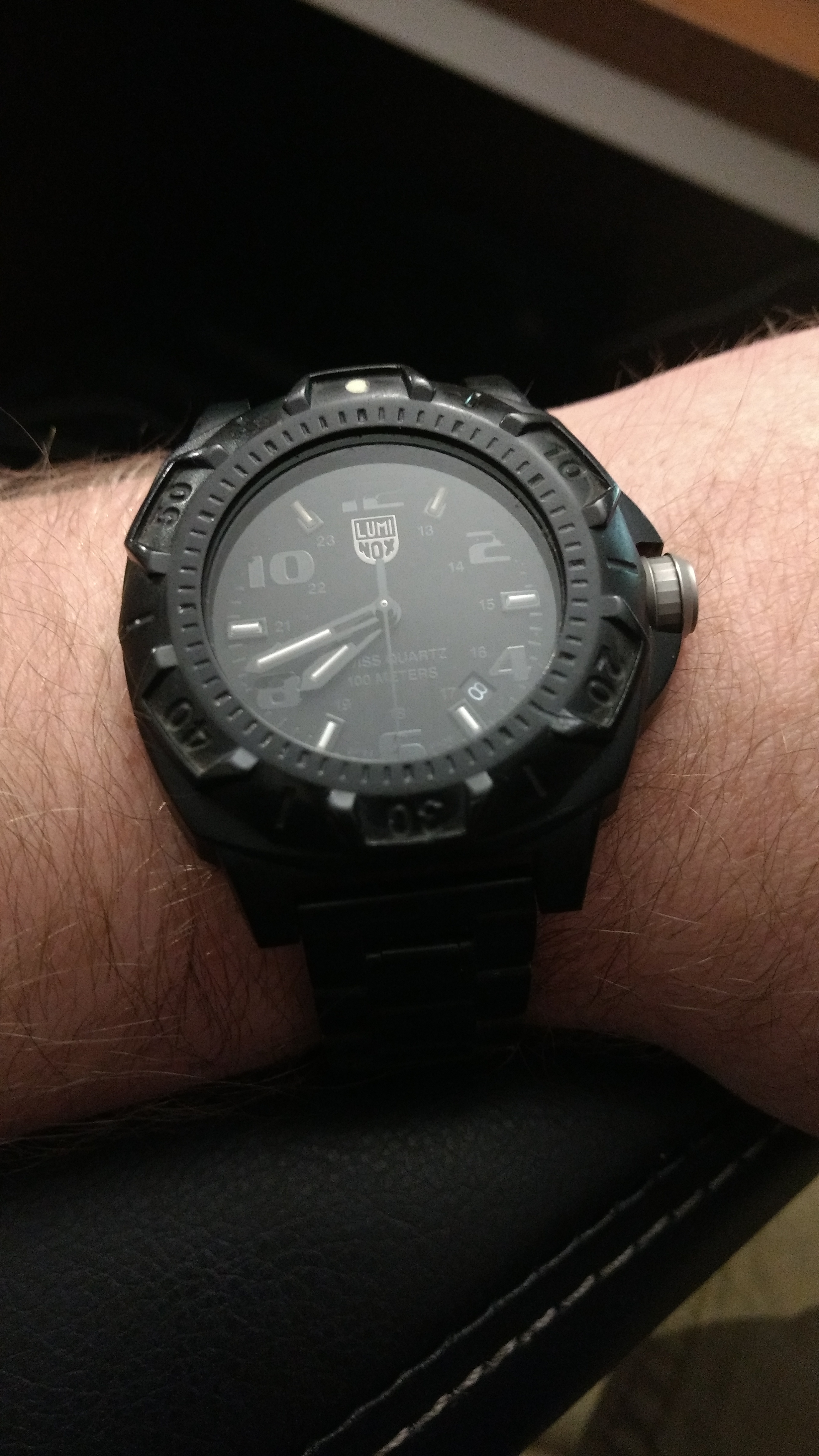

Original post wasn't too clear,
I had batteries changed locally twice and had issue with sporadic time, sent it to Saltzman Watch in Rhode Island as they were the Luminox authorized repair center. Warranty was not honoured because it was bought 3rd party on amazon. Repair bill was for new battery and replace stem and crown. It was about $100 + shipping, so about $150 for me, don't have the original bill handy right now.
It was fine for about a year, then the crown came out, it was outside the warranty to get it fixed at Saltzman, and I didn't want to pay another $100-150 to fix it again, so it sat in a box.

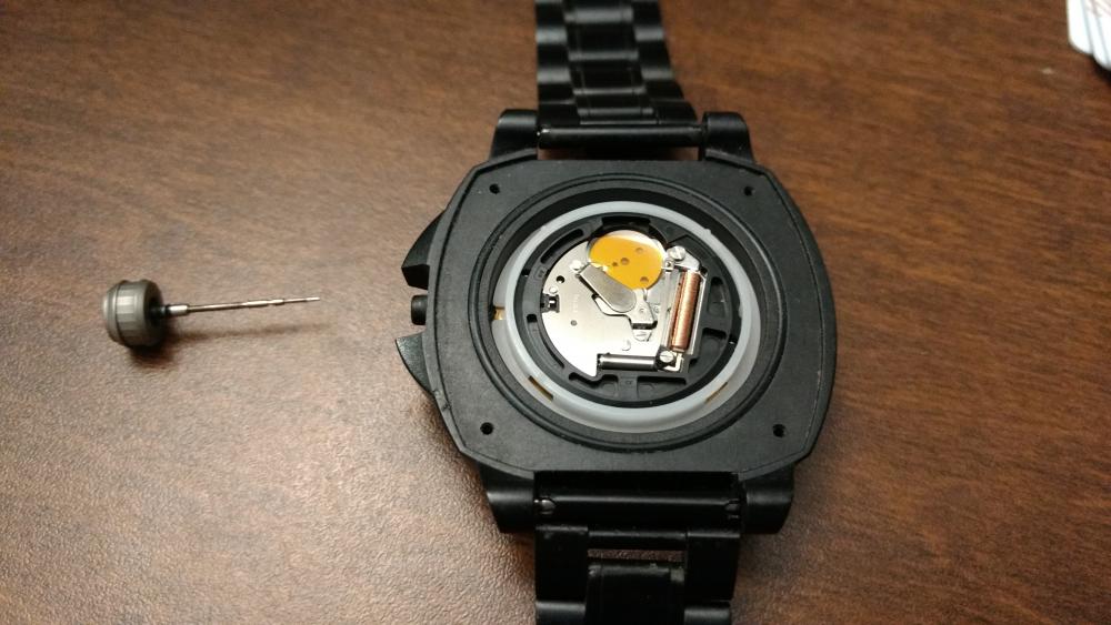

I disassembled the watch, re-attached the crown to the stem, gave it a cleaning. When I go to re-insert the stem, it's default position is the day change function. So just rubbing against the crown it will turn and adjust the date.
How do you position it so by default, the crown doesn't operate any functions (date/time)?
All else is good right now. Attached picture of current status.
Ok, thought I had the placement right, reassembled everything and now the crown has unscrewed from the stem again.
Are we to use loctite on the stem? How do you prevent the crown from coming unscrewed? This is a pretty bad design flaw.

Yes you use Loctite on the end of the stem in the crown to lock it in place. Just be very careful that the Loctite isn't protruding out and somehow gets into the watch.

if an installed stem doesn't operate properly it's either a fault within the movement or that the stem was originally made too short as to not correctly engage. (this can happen only after re fitting the two pieces together for the second time)
How are you going about refitting the two pieces, without a pin vice you're almost certainly not screwing them together tightly enough, thread lock may or may not compensate for this.

i held the threads with pliers (not too tight) while screwing the crown on by hand. applied some loctite and it's currently sitting right now.

Loctite requires clean surfaces. Then we commonly toss around the term Loctite as an individual substance it's not. Comes in a whole variety of formulas with different strengths different properties you do need to have the right one.

I have been using Loctite 603 for the crowns for a few years now with no issues. Maybe its not the correct thread size or grease was present before application. I have read 638 is even stronger but it really should not be necessary for a crown.
I use Loctite Threadlocker 248 (available from most car-part/bike-part outlets) which is a blue coloured paste in a small tube like a lipstick
As with all adhesives, utter cleanliness is essential.  Make sure you thoroughly clean the threads on the stem AND inside the crown to remove all traces of grease/oil. Make sure they are fully dry before applying a small amount of adhesive.
If the clearances in the stem/crown are bigger than normal then it may take more than 24hrs to fully set.  Make sure you screw the crown fully onto the stem as this will then close-up the threads to minimize the air gaps and quicken setting as the adhesive sets in the absence of air (ie anaerobic).

Ok so I applied high strength loctite to the threads and the crown is secure, now the issue i'm having is the stem doesn't lock in to the mechanism. any tricks to this? i've been rotating it and it does not lock.
Ok it's finally fixed. Luckily the loctite didn't fully cure, even though it was untouched for 24hrs?? but with pliers on the threads I was able to back off the crown enough so it would engage the lock in the mechanism.
Lessons learned :
-Do not thread the crown on the stem until you feel resistance. There is a fairly precise position it needs to be to engage the lock mechansim in the watch and ensure that the crown is not sticking out to far on the outside of the watch.

Actually you shoulthread the crown onto the stem until it is tight. If having done so the stem won't then engage in the movement then it is not the correct length. Geo has done an excellent walk through on fitting a new stem to the correct length here;
The issue of the crown coming loose is a result of not being able to fully tighten it on the stem in the first place.
