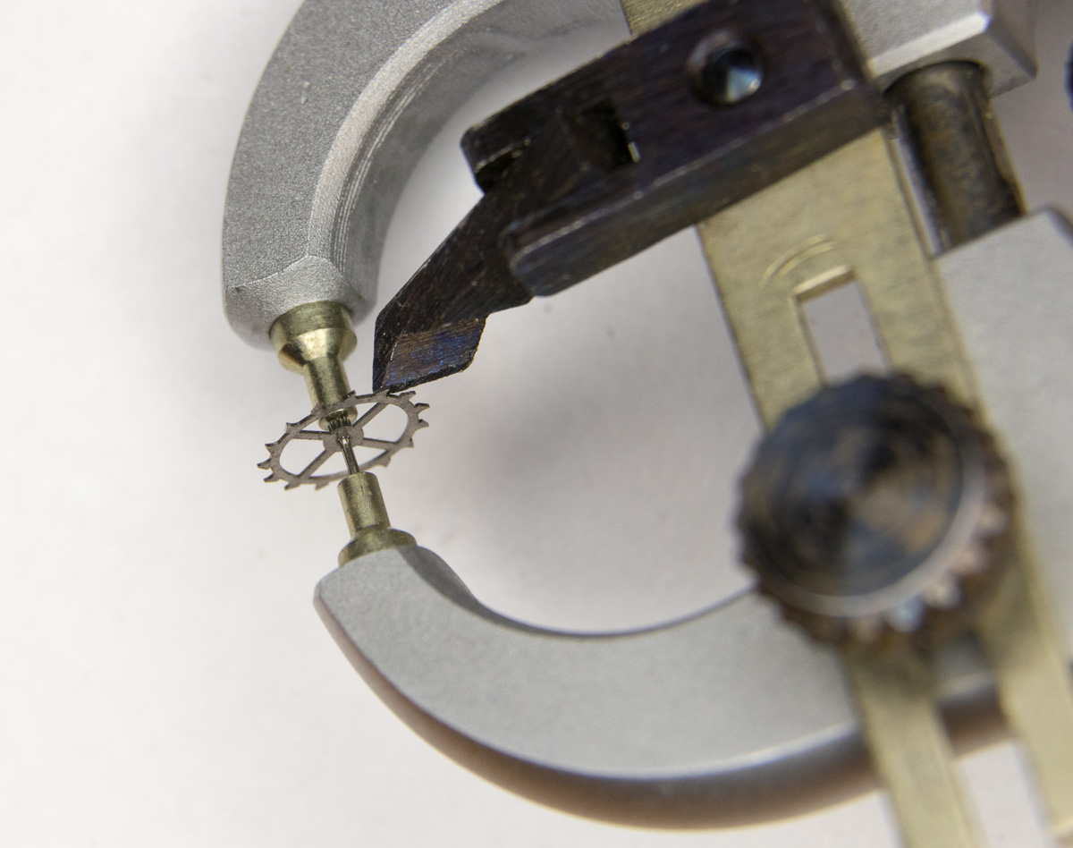

For the first movement I ordered a replacement escapement wheel on ebay. Unfortunately the seller didn't pack it properly. This is the result:
A bent wheel. I was able to fix it with this trueing caliper which I also got for very little money on ebay.

Thank you Alexander! Much appreciated! By the way, if it is not too much to ask, how did you use the trueing caliper to fix the wheel? I've never used one -- or owned one for that matter! Much to learn, my friend!!

Oh, well, back to the original thread, I'm still curious about the use of the trueing caliper since I don't have one and intend to get one in the future. There are also different types I think. Some have a "handle" and others are like the one you have...All a little confusing considering size and "features?".

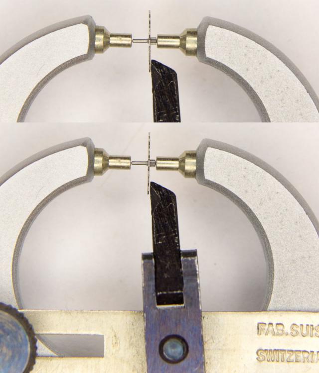

Here is a short explanation of the caliper, I promised Bob @bobm12
The caliper has actually two sides with different sized pivot holes.
The ruler (don't know the real expression) can be mounted on either side. The double threaded rod in the middle allows parallel opening and closing of the "claws". There is some inbuilt friction, hence you can fine adjust the width when inserting an gear or escapement wheel to turn easily but with nearly no axial play. That is essential.
Here is a closeup of the pivot hole:
I found an old escapement wheel of a very cheap watch from the 70ies.
This is the result: the wheel is not running true. This can be easily seen with this truing caliper. You could now try to do tiny corrections. The pictures may suggest that the axis is not really parallel. But believe me: the wheel rim is moving back and forth when turning the wheel.
Important notice: this is how I figured out to work with it. I would highly appreciate comments of watchmakers who really know hot to use it and may give some additional advice.

Alexander, I have no words! That caliper explanation dispels all the mystery about it! Very useful to me at this point and I appreciate you taking the time to do it. Thank you very much.
