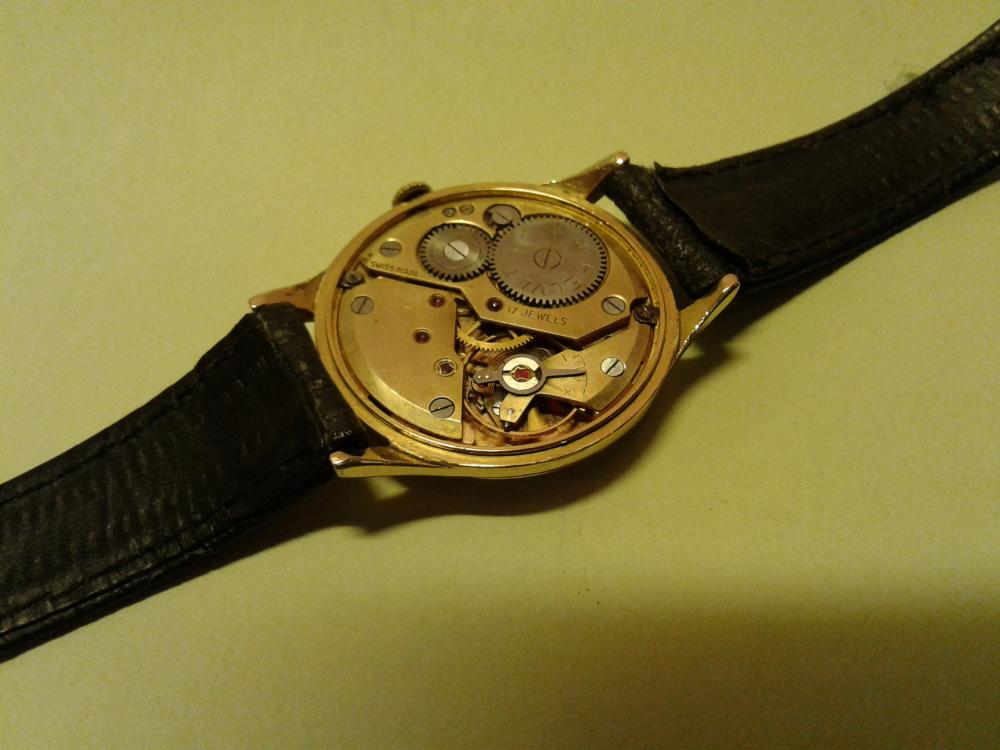

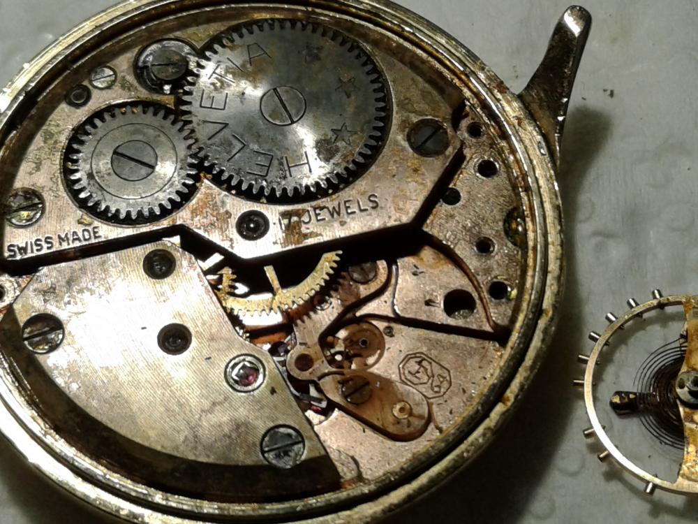

So as usual I'm doing my usual bay browsing and came across a very dirty oily greasy Helvetica . I think it must have lived in the bottom of a garage repair pit for most of its life. I'll be stripping cleaning de-greasing and polishing for many a day to come I'm sure but I'm sure she will live again. At the moment the movement is totally stuck fast I'm going to clean it first as is to remove any dirt before stripping so peeps wish me luck.:unsure:20160413_191310.jpg20160413_191439.jpg

Just a wild guess, but you may find the odd rust spot on the pivots and in the keyless works.
Maybe you should look out for a donor watch to get some spare movement parts... a spare dial... and maybe a spare case?

Good luck Cad, that's a classic which I've always liked! Small seconds at 6, numbers on the dial italics like (I don't know how it is called) and Dauphine hands, gold on white dial...simply love it!

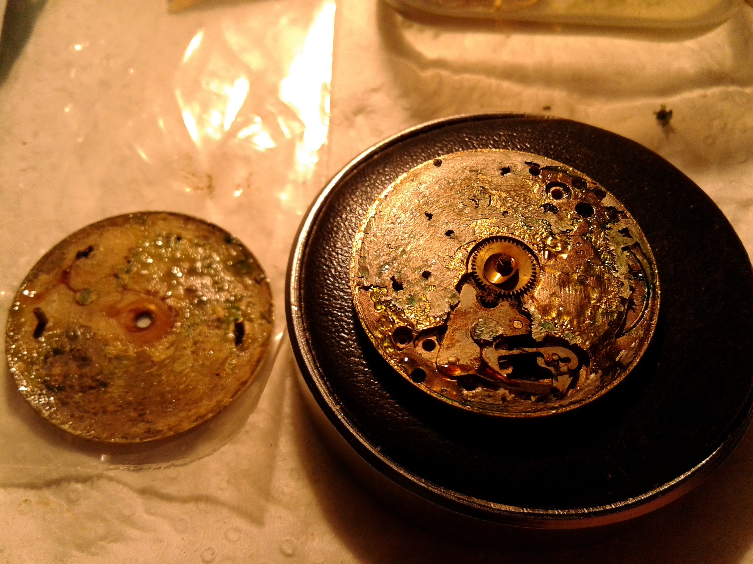

Bit of an update on the state of the watch. It seems to have been submerged in some sort of green swarfega type liquid how long for I have no idea but it has glued itself to every surface. I spent last night gently ungluing parts from each other and removing as much crud as i could with pegwood, at the moment the parts are having a 24 hour soakbin lighter fuel to see if that softens up the green stuff any. The dial may be beyond saving I may just strip it and 're colour it but it will most likely lose its name whivh is a shame.

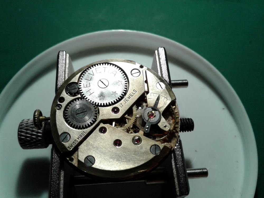

Update time well what can I say that was a challenge :Dafter about a thousand sticks of pegwood 3 soaks and a sonic bath or 3 I've finally got her up and running bad seeing that little heartbeat spring to life was one of my greatest achievements as a watch repairer so far. Now let's see what I can do with her face.20160416_031200.jpg20160416_031314.jpg
By the way the word "bad" should have been "and" the watch isn't running bad in fact its running very well indeed :D Mick
That is a transformation to boast about.
Heaven only knows what ordeals the poor watch has had to endure to end up in that state but hats off to you for a job well done; the end result looks excellent.
Good luck now with the cosmetics.

quite a brilliant result you have here !! I have an Omega in my list of things to fix that has green crud all over it well, looks almost exactly like the crap you had to deal with. Wonder what that stuff is...
I have no idea but its a swine to remove .You have to soften it first but that turns it to a kind of glue that just sticks even more . I went through 2 tins of lighter petrol to get rid .
