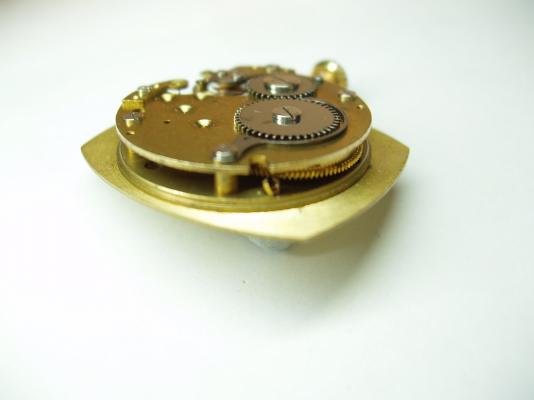

I was asked to have a look at this family heirloom just handed to me from a friend of a friend as it was not working and they thought it may have some value.  The quality of the movement did not inspire, to say nothing of the identity of the watch !!!
As I had never done a pin-lever before I decided to have a go and get it running again.  On inspection I found it be in reasonable condition but very dry and the balance was very stiff and not working.  Once the balance and lever were out all ran freely, so I reckoned a good clean and lube would solve the problem.
For those interested I have done a walk-through for the assembly as the strip-down is just the reverse basically.
After a good clean of all the parts in lighter fuel (I'm only a hobbyist) and a strip and relube of the mainspring, the assembly followed

The pin-lever was added and checked for kick  The pins and escape wheel where epilame treated and oiled with M941, and the fork was wiped with M941 on a wedged end of pegwood, this is because they are all metal to metal contacts. Even the balance table jewel is metal !!
The balance was added, lubed and checked for function. There are no balance pivot jewels (in fact there are no jewels at all !!!) just holes in the main plate and balance cock.  The holes lie under the round plate on the mainplate and the regulator on the balance cock.  These were removed/lifted to lube with M9010, the cock plate being a bit tricky/delicate.
The canon pinion was added and lubed.  This is not a friction fit but is driven by the intermediate wheel.

Stuck in on my timegrapher which showed a very noisy trace (not surprisingly) but managed to get it reasonably regulated despite iffy beat error and rates in some positions.  I aimed at a reasonable rate when worn and it actually keeps fairly good time within 1 minute a day on average.

I agree with Old Hippy that it looks like a BFG movement but I don't think it actually is as BFG marked their movements with their logo and even the cheapy BFGs had a jewel on the balance wheel.  I reckon it's a Hong Kong copy of the BFG or a very early Tongji with no jewels, cased by the faker.

The movement was made by Wurthner, Germany as the heading says.  It is commonly known only as Wurthner 10 1/2 ligne, beating at !8000 bpm
It was first made in 1959 with 1 jewel in the balance and was developed to this model of about 1970 with NO jewels !!!  Power reserve is about 33 hrs.
They did not make many of this model as they ceased production shortly after introducing it, so oddly it is a bit of rarity !!!
I agree it does look a bit like some BFG movements but there are differences (eg the shape of the click spring and balance position).  Similar movements were often fitted to some Newmark and Ingersoll branded watches of the time.
The watch is known as 'Highway Gold' and probably made in Europe somewhere rather than Asia.  This and other copies were sold by road-side chappies in southern Europe (like they do today at holiday resorts!) in the 1970's and spreading much wider later.  The case isn't plated but a polished brass-nickel alloy called 'pinchback' (ie probably made from metal scrap).

Timing is a problem as it varied between +140 and -80 s/day depending on position, dial down was the worst and very noisy.  Didn't want to mess about with hairspring etc to correct beat etc so timed in 3 positions for best average to be slightly +ve when worn on the left wrist for 14 hrs worn/10 hrs static.  It seems to keep ok time at this.  Whether this will be maintained is another matter!!  I would imagine wear of the pivots, pins and pallet fork would be the main problems as they are all metal to metal and would really need regular re-lubrication (unlikely cost effective in such a cheap movement).
