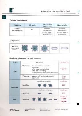

So I'm attaching timing requirements for the 2230-2235 Which are almost identical to the 3135. I don't actually have a beat error for the 3135 but it should be the same. So the first criteria for the 3135 is 15 seconds and the second criteria is -1 to +5 seconds. Then to understand how Rolex comes up with those numbers I have another image.

I went digging through my manuals and found some information on the 3135 you might find helpful.  It is very close to the same material that John posted but from the 3135 manual.  Hope that it is helpful.  I apologize for the bad scans.
Excellent material Omglv, thank you very much for taking the time digging through your material ;) It's stored already, together with John's material, in my file :)
