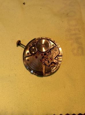

by fortune i ran into the watch repaid channel in you tube and after watching 10-20 video i convinced my self into trying to repaid my grandfather's mechanical watch. at least give it a try.
It is a Doxa, swiss made as it can bee seen from picture, and it was not moving.
post-1727-0-25813700-1452442608_thumb.jp
it is nearly 50-60 years old, but the movement inside is clean of any rust although all the parts need to be cleaned as they look to be stuck and maybe this was the reason why it not working.
Even though watching 10-20 videos of Mark during the weekend, i started the project on the wrong foot. i took out as many part as i could without detaching the dial from the mechanism/case.
Can some one please advise me how to do it? i have insert some additional photos which may help.
post-1727-0-90473200-1452443004_thumb.jppost-1727-0-73484800-1452443038_thumb.jppost-1727-0-76170800-1452443078_thumb.jp
by fiddling with the mechanism i found that is can move/rotate within the case but it does not go up or down.
I would love to repair the watch and present it as a gift to my mother.
thanks in advance
Welcome to the forum Drini. You really should have removed the movement from the case before you started removing parts, you risk breaking pivots and cracking bearings doing it this way.
I would recommend replacing the bridge that supports the remaining wheels before attempting to remove the movement. After you have done that, you will need a single sided razor blade, a Stanley knife and a case knife to prise off the bezel complete with crystal. Carefully force the razor blade between the bezel and case to start lifting the bezel. Next use the thicker Stanley blade to lift it a bit more, this will now allow your case knife to enter the gap and prise off the bezel.
Once the bezel is off the movement complete with dual should lift out if the case. Remove the hands, then undo the screws that retain the dial, these should be accessed from the side of the movent. Once slackened, the dual should lift off.
hello GEO, thank you for the advice. did as advised and was able to remove the bezel with the glass from the case.
After this the movement just dropped :).
went on to take out the hands, and by undoing the screws and the side also the dial was detached from the movement.
However now i'm stuck again, the watch striping is held by 3 screws which do not want to get off.
post-1727-0-75240600-1452455356_thumb.jp
2 of them are used in the cover of the minutes rotor(sorry is the wheel is not the right one very very new to this) and the the third one is used to cover a spring and one lever which are used on the crown mechanism.
is there a way to loosen these screws??
i have tried by modifying the head of two screw drivers but im afraid of damaging the screw heads.

First make sure that you use good quality screwdrivers that are ground to be a tight fit in the respective screw slots. Immerse the plate in Plus Gas penetrating oil for a day or two and then try again. http://www.ebay.co.uk/itm/1-X-Plus-Gas-Tin-Spout-250ml-Bolt-Screw-Assembly-Lubricant-Clean-Protect-/391096277473?hash=item5b0f2799e1:g:nzsAAOSwZ1lWcAre
You can also heat up the plate by putting it is really hot water for a couple of minutes as this will expand the plate and may allow you to undo the screws.
Do not try to force the screws off . You will break the head off and then you have a real problem . After doing as Geo suggested , using the proper screwdriver in good shape and a tight fit. put a firm constant pressure to see if the screws are ready to turn loose . Try one screw then another if still stubborn  . Patience is key here . If still stuck , repeat Geo's instructions . Give the penetrating fluid time to work .
